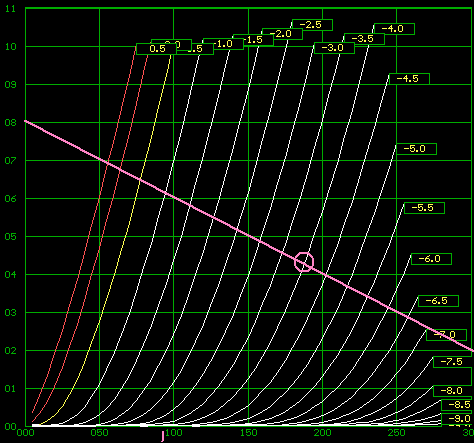

I do not understand how some of you guys have got the presumption that the operating conditions for the 6N1P are poor.
I think the tube has a decent operating point, and is reasonably linear.
I posted a curves from the Russian datasheet with loadline in page#1 of this thread. Below is another one based on measured tube curves, but a different vertical scale. This is also with 4V at the cathode and 50K load. Looks OK to me.
For those new to tube curves and loadlines, observe that linearity is understood as variation in anode voltage as a function of grid voltage when moving along the loadline.
The curves are from the excellent collection of Russian tube data at : Klausmobile Russian Tube Directory

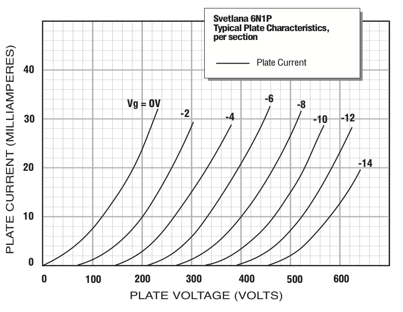

Your graph does indeed look good, but I got the presumption (or postsumption) from this graph here...
BTW: How did you come by your graph?

I'm also a little confused, the graph I have been using is nearly identical to the Svetlana graph shown above by Globulator. I thought the difference I was seeing is just due to very different scale/ resolution but if you follow the 0v grid curve it intersects 10ma at about 120v, that same curve intersects 10ma at about 100v on the Klausmobile graph.
I wonder if he looked at the wrong graph?

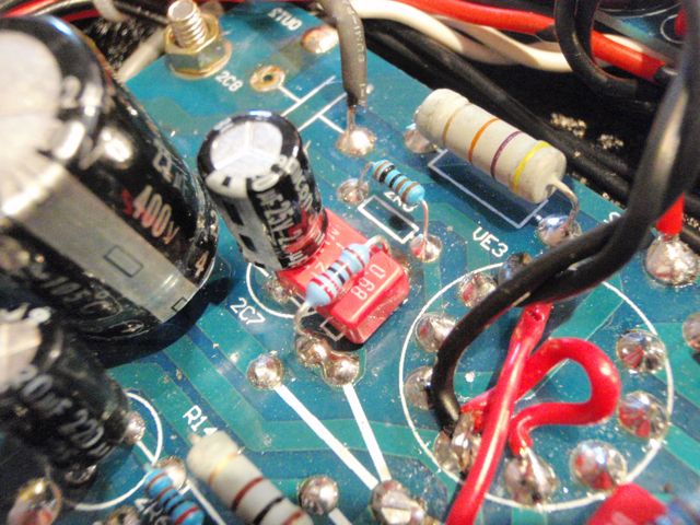

Modding the Sweet Peach

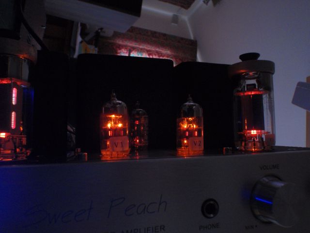

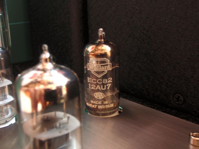

OK so while browsing the tube specs and load lines I found the 12AU7 or ECC82 was quite happy around the 200V, 4mA region - plus - I actually have three Mullards sitting in a box.

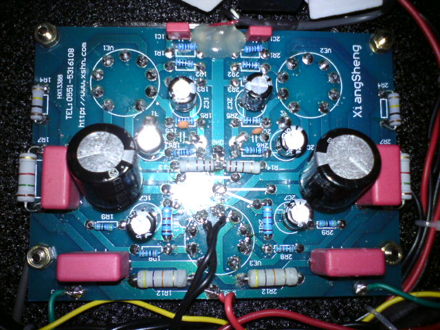

So I first had to mod the board - pin 9 was unconnected but on the ECC82 is the filament centre tap - so a cut track and a couple of wires later and the socket is ready for the ECC82 with parallel filaments...
..So I plug it in and gingerly wind up the Variac - all good, and it sounds nice too. I get 141 on the plate and 4.5 on the cathode, so I look at the lines and replace the cathode resistors for 2.2k ones, and get 8.23V cathode, and about 200 at the anode. It sounds a little more detailed now - the load lines want a CCS but it's better with this tube.

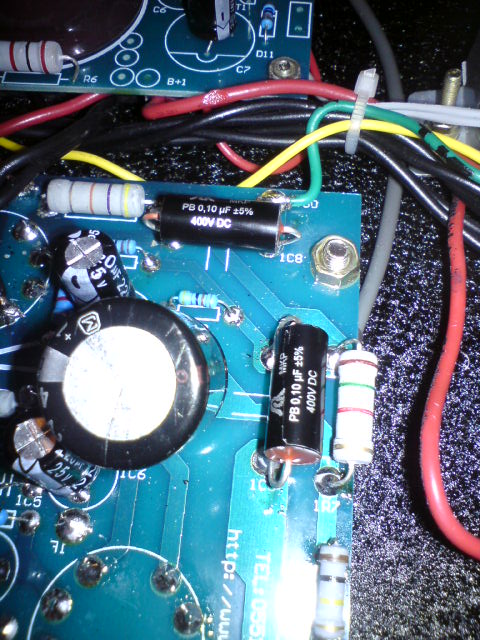

So I decide to change the red 'Wima's next, as one was a different size and they looked like rejects. The new ones are polys I bought from Rapid 0.1u 1kV, so once in and tried it out, WOW - what a massive stonkingly HUGE difference. Real bass now, far more balanced sound - I guess the old ones were not really Wima at all were they - dustbin for those!!

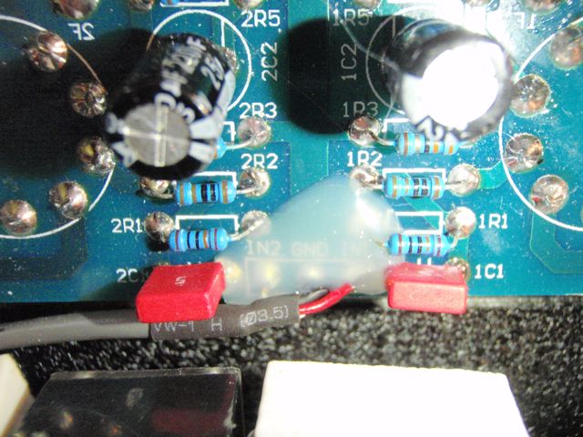

Then I noticed some extra caps on the input - next to a glob of glue. Well they have to come out now obviously - so a heat gun got the glue soft (it's hot-glue) and some component lead wire replaced the caps.

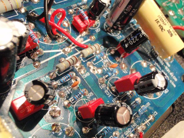

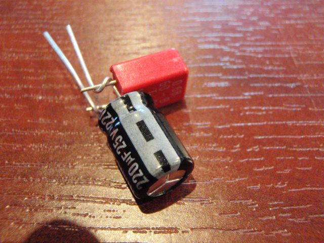

Then I looked at the electros in the signal path, there are two cathode bypasses and 1 feedback 220uF - so some new Jamicons went in with some genuine Wima 0.68uF bypass caps (I only had 4 Jamicons so the FB capacitor stayed there. Space was a bit tight and I had a couple of spare 400V 22u caps so I also changed the bulky ones for those - much smaller and possibly better.
So again slowly wound up on the Variac, and what a good sound!! Bassy, clean detailed, smooth - and this is through the old Kefs that sounded pretty dull when I started!!
Mod summary:
Mod summary:
- Rewire board for ECC82 and add ECC82
- Change 1k cathode resistors for 2.2k
- Change fake 0.1u Wimas for real Poly caps
- Remove C1 input caps and use wire instead
- Change 220uF bypass caps for Jamicons
- Bypass all 220uF caps with genuine Wima 0.68u
- Change 400V 22uF PSU caps
And it sounds awesome

I'm impressed, you are a little more ambitious than me Globulator!! I was going to snip out the tiny caps in series with the line level inputs as well but forgot when I was replacing the coupling caps which as you mentioned have a considerable impact on sound quality. Did you find replacing the cathode bypass caps to be worth the effort?
Nice to see you spending real quality time with your amp!
I too had my fingers on the C1 but decided not to remove them at the same time as changing the 0,1uf to mkp, now I feel like I have to remove them too.
Sorry I take 90% of my pictures with my phone.. not that great.

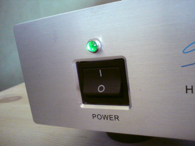

On the image where the new green light is showing, you can also barely see the new rubber feet I have put under the amp to get more air underneath it.
One image shows it with the stock "wima's", one shows the new caps installed on one channel, the other side of the board looks the same.
