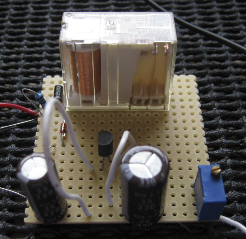

One of the things I like to do is strip everything back to the bare necessities. For example a soft start circuit. One would think, in some threads, that we're all out to design a "Power distibution protection system". Stick your amplifier with a plethora of protection circuits and "HEY PRESTO"....we're all happy.
Erm....not me - I'm designing an amplifier, not a science museum for protection systems - I dont intend to have any current limiting, I'm designing for optimum performance with enough elasticity in the design to take some trouble without burning out. Done it before in massive PA systems going up to many thousands of Watts. Down here in 200 Watt land, I'm pretty certain it isnt necessary all of the time. Some small DC protection may break out later in the design as no one likes rail Volts over there loads.
Using the soft start as an example - even the designers on this planet like to make these the most costly and complicated beyond what one would consider sane. Bruce Lee said of his art - strip out the waste and use ONLY what is necessary for maximum delivery. (Tao of Jeet Kune Do)
So here it is - my experimental soft start intended for this skeleton amplifier -- The components here are not necesserilly the ones of final choice - the solenoid may be bigger with whetted contacts and hermetically sealed.
However, no need to ignore the science behind it.
Timing a soft start is a bit of fun with physics and a simple bit of calculus. So I've done a simple graphic
And for those prefering a ready calc - in the zip is a ready made calculator with the formulas excel syntax

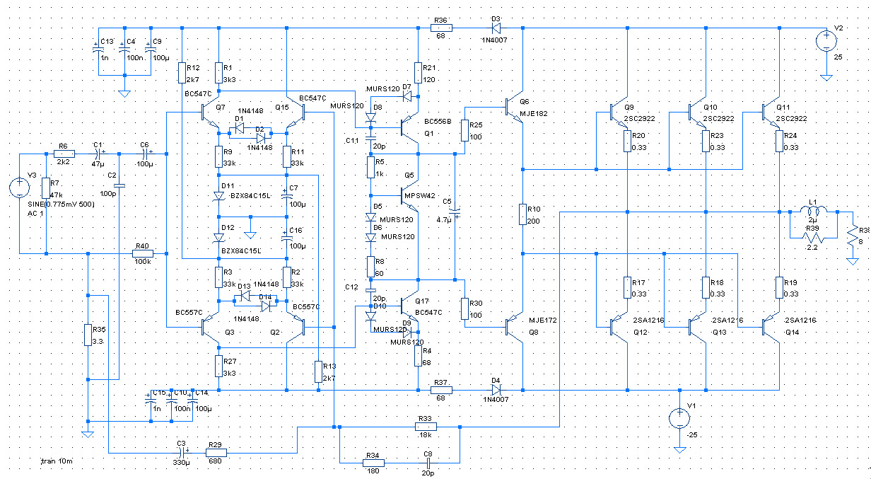

I may be thick as a brick, but for the life of me I can't figure out how your input transistors have any idle current. The bases just dangle at the end of a cap each, with no path for DC.
Are you keeping that part as a trade secret?

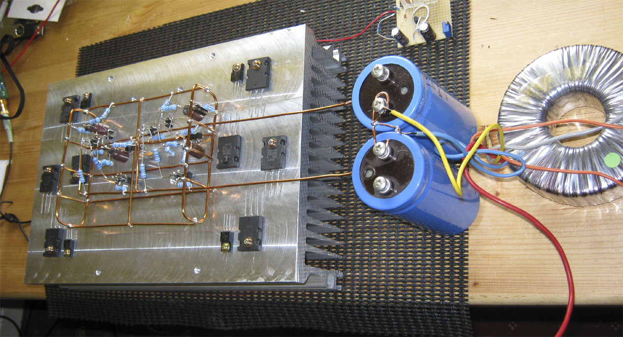

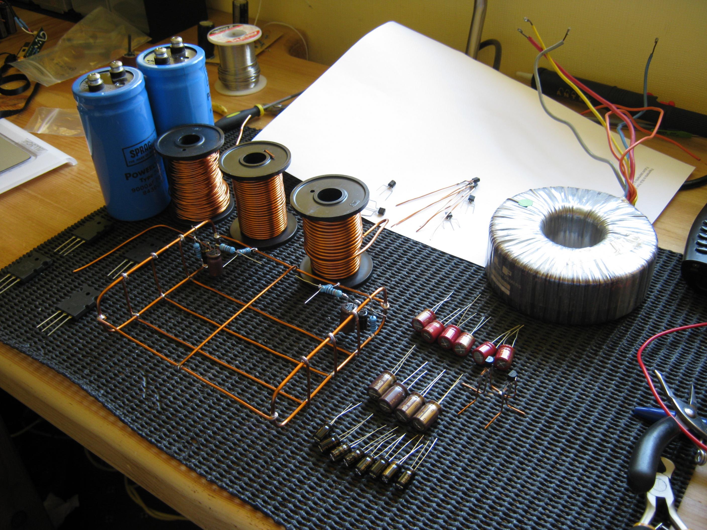

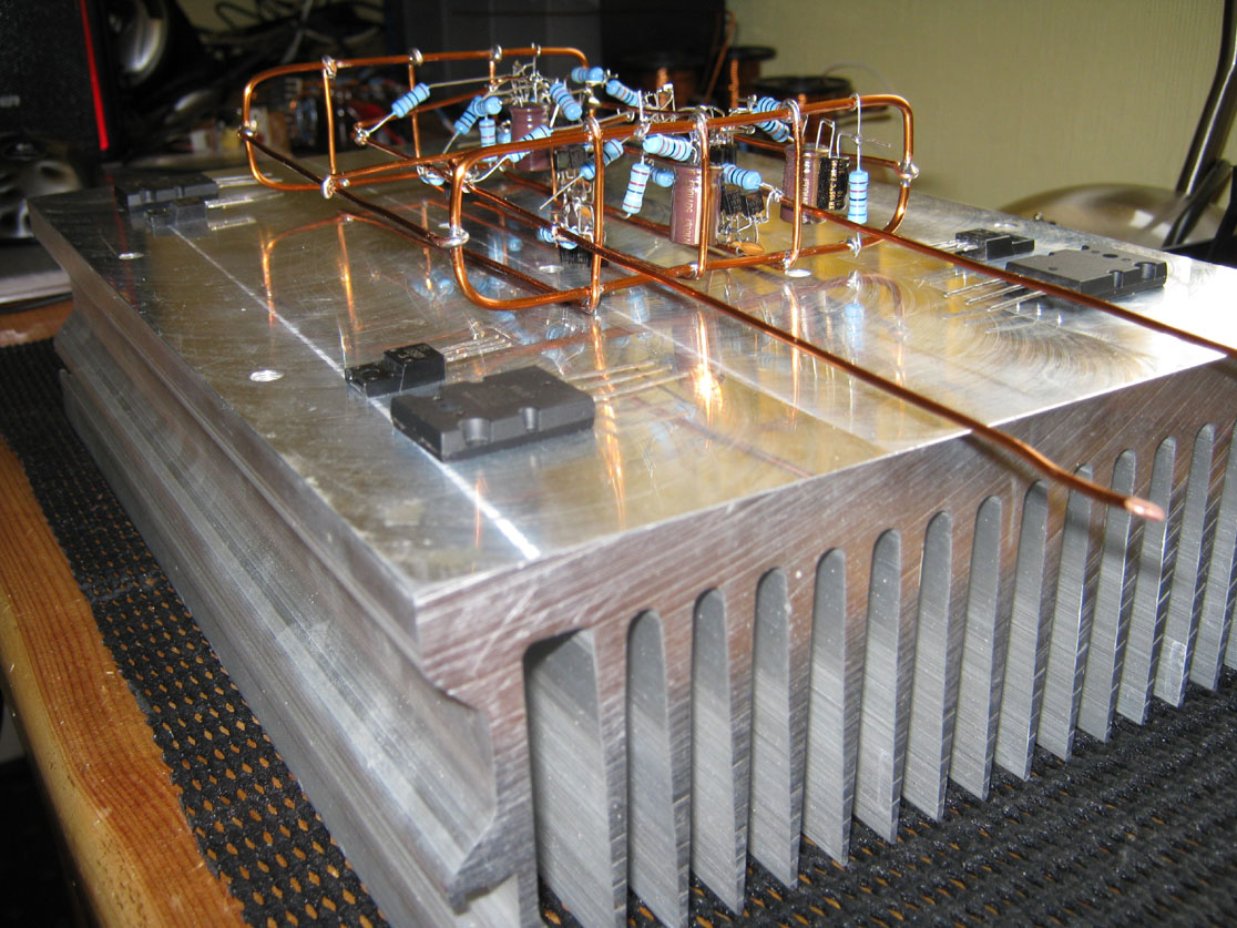

Skeleton Amp (SKAmp) Mk1 nearly complete
A Stereo 90W per chan into 8Ω version just to prove some points, tweak and meddle with; before I go head-long into building the two expensive mono-blocs
This is a nice big chunk of Aluminium but I am worried about positioning of the drivers
all BC550C input
ZTX873 and ZTX753 VAS
2SA1827 and 2SC4793 Drivers (As used in a Mark Levinson I own)
all BC550C input

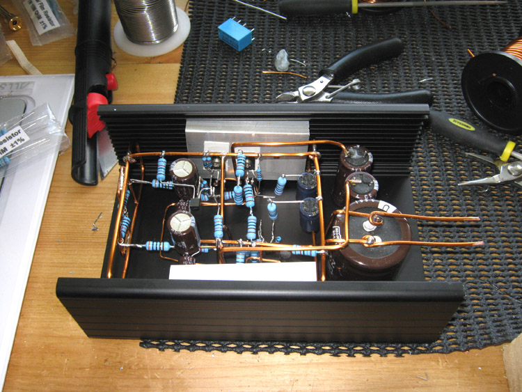

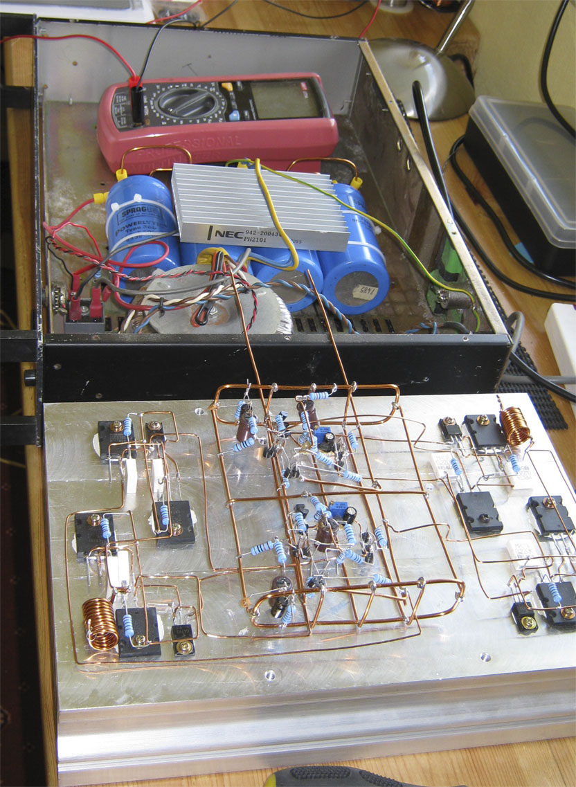

Excellent news We get to see more fun & games
Drilled any holes yet?
Yes they are now mounted and I am now coppering the drivers and output stage up
Speaker protect relay and soft start input to TX is being sorted now.
I Have 2x 120Ω 50W armoured resistors for limiting rails at first switch on and
a nice 8Ω dummy load once have set it up for idle

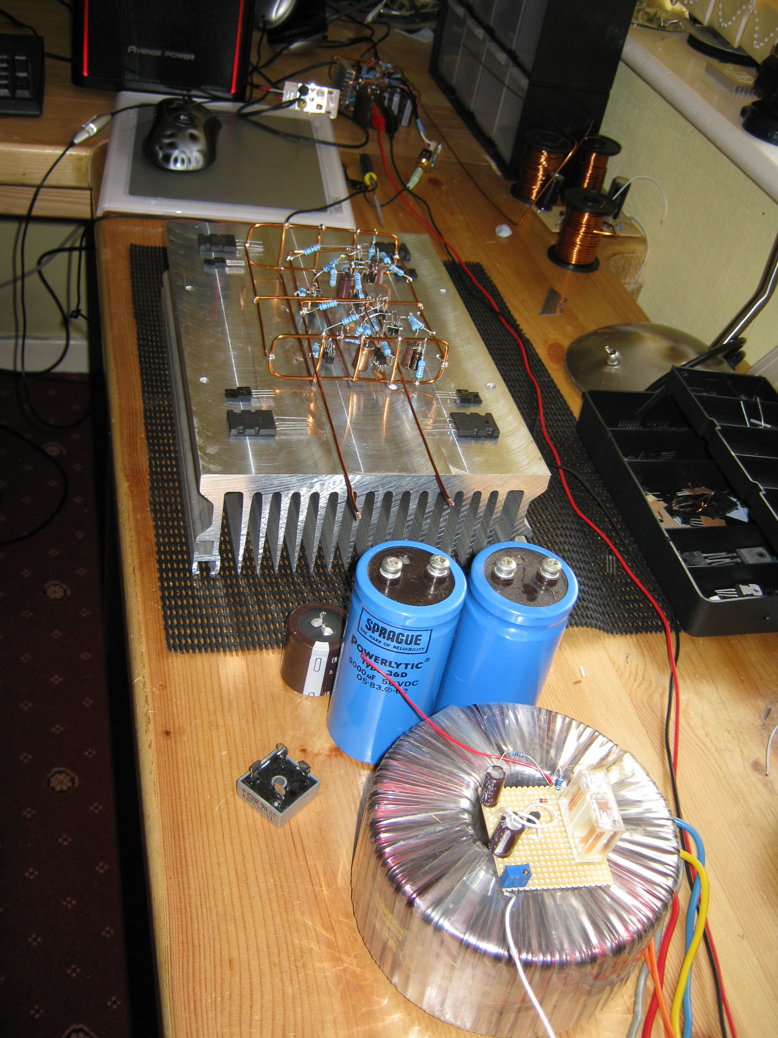

OMG it's ALIVE ! ! ! ! !
....**** it works !
After all this toil the damned thing works - w00t... as they say in gaming servers.
A fabulous 225W RMS into 8 static Ohms
I calmed it down a bit adding a 680Ω into the pos feedback to hold it back to 125W for now; whilst I get used to it and learn it's needs and idiosyncrasies. Map out all its V and I so I know where it stands.
Both quiesced nicely at 26mA
output DC residual offset is 2mV on one and 9mV on the other (no load)
so far that is all I have -- I'll do some noise and distortion measurements this weekend and once I'm satisfied I'll take it into the works labs and do a complete thermograph of it using our FLIR A40 camera.

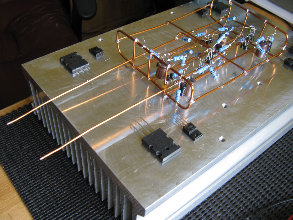

Heh heh heh, it looks like some kind of Krypton Factor assault course with all the copper wire to climb through
I thought you might be making a stereo pair when i saw the way you were laying out the power transistors previously, nice to hear that it works & is stable Looking at the wiring you might get some benefit from fitting some decoupling capacitors nearer to the output transistors
Not a quible, just a suggestion
Well done fella, keep up the good work... By the way, what does the present schematic look like?
