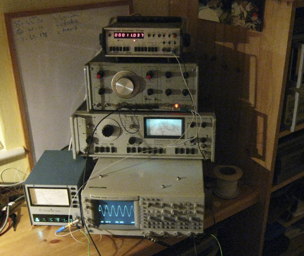

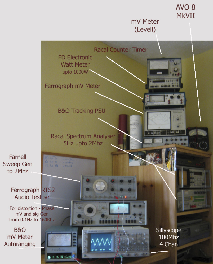

Looks like a nice 4 channel Fluke oscilloscope you have there, tasty.. Not sure of the rest of the stuff but it looks handy
I think i need to invest in a new scope myself, the power transformer in my Gould DSO decided to short itself out on the high voltage winding. That leaves me with just a Hameg HM203/6 Trying to find a replacement TX is like looking for little green men

That's a very nice range of equipment. Far superior to my own offerings
I find it funny that stuff that doesn't get used for a while decides it just doesn't want to work any more. For instance, i needed to test a drivers parameters just before xmas & my Thurlby Thandar function generator decided it didn't want to know The frequency counter was fine though, anyway i bought a secondhand but as good as new 2MHz Tenma jobby, with built in frequency counter
I do have another function generator but it was no good for this job being 600 ohm output only, that's fine for amplifier testing as it's very low distortion.

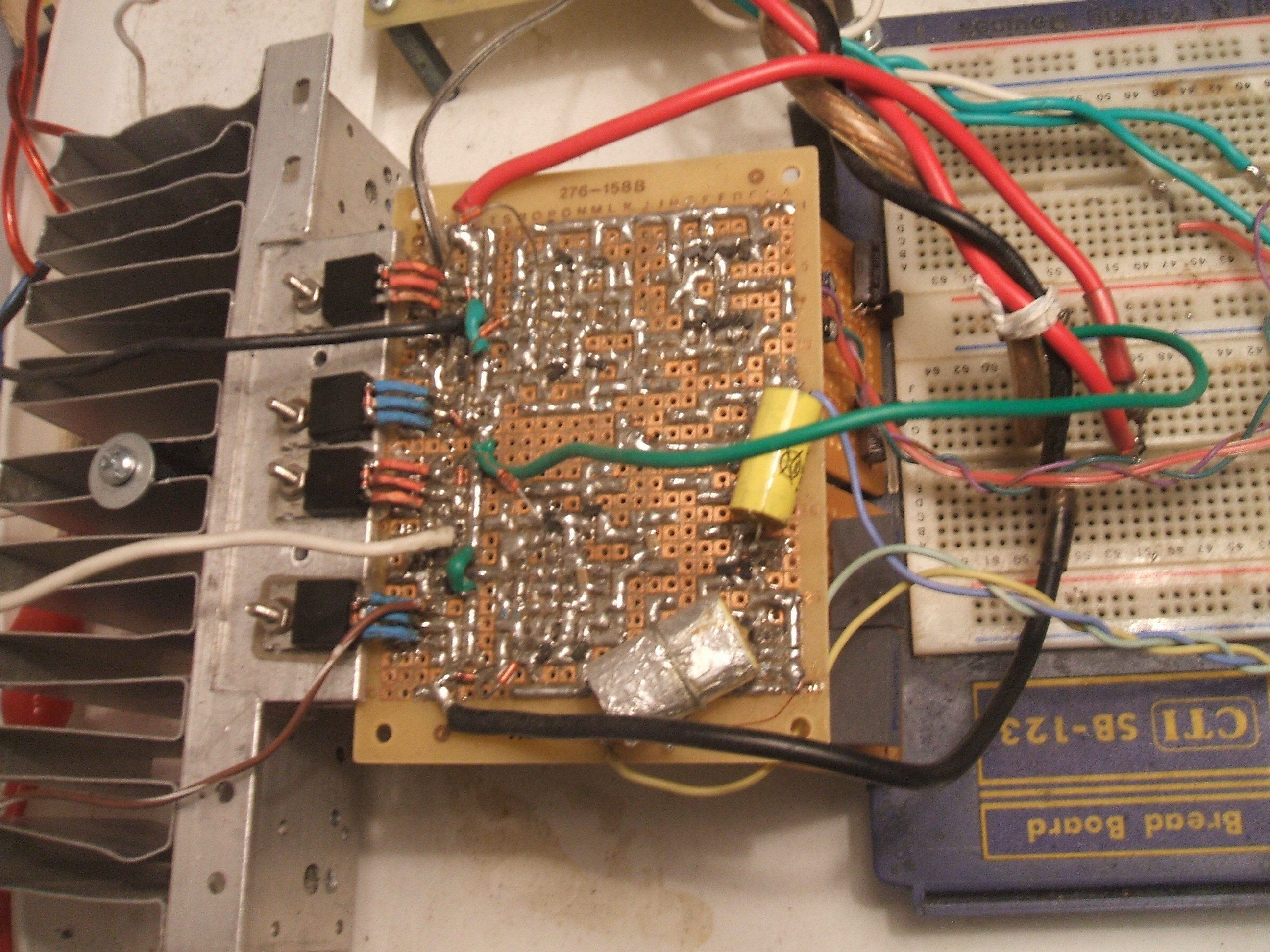

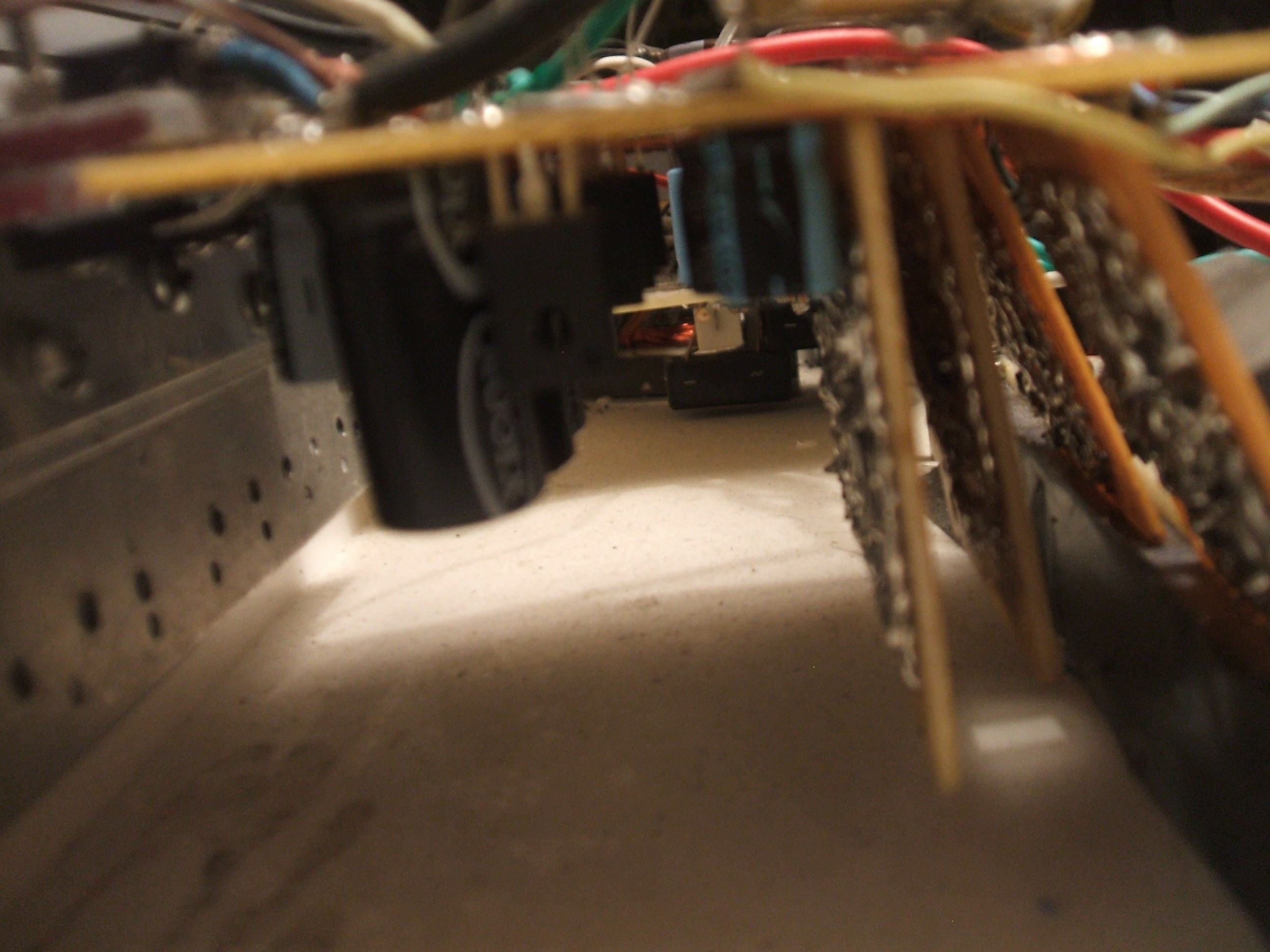

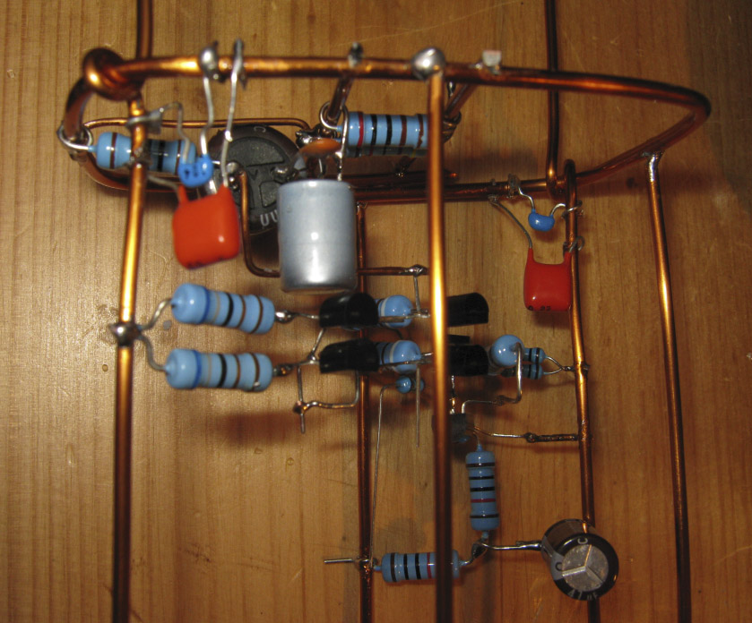

That’s an interesting way of doing point to point construction. What are the chances of the lacquer coated copper causing a short?

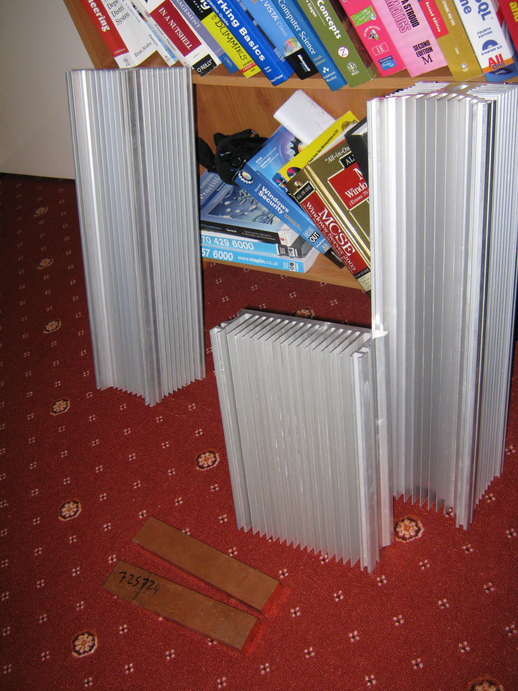

BTW, nice heat sinking hardware. Are those copper bars or white brass? I have a hunk of white brass, 8 X 16 X ½ inch that I may cut and use somewhere soon.
I do not think the method of construction is critical when you’re trying to build a bench amp. As long as the connections are sound, and layout is wise, it should work.

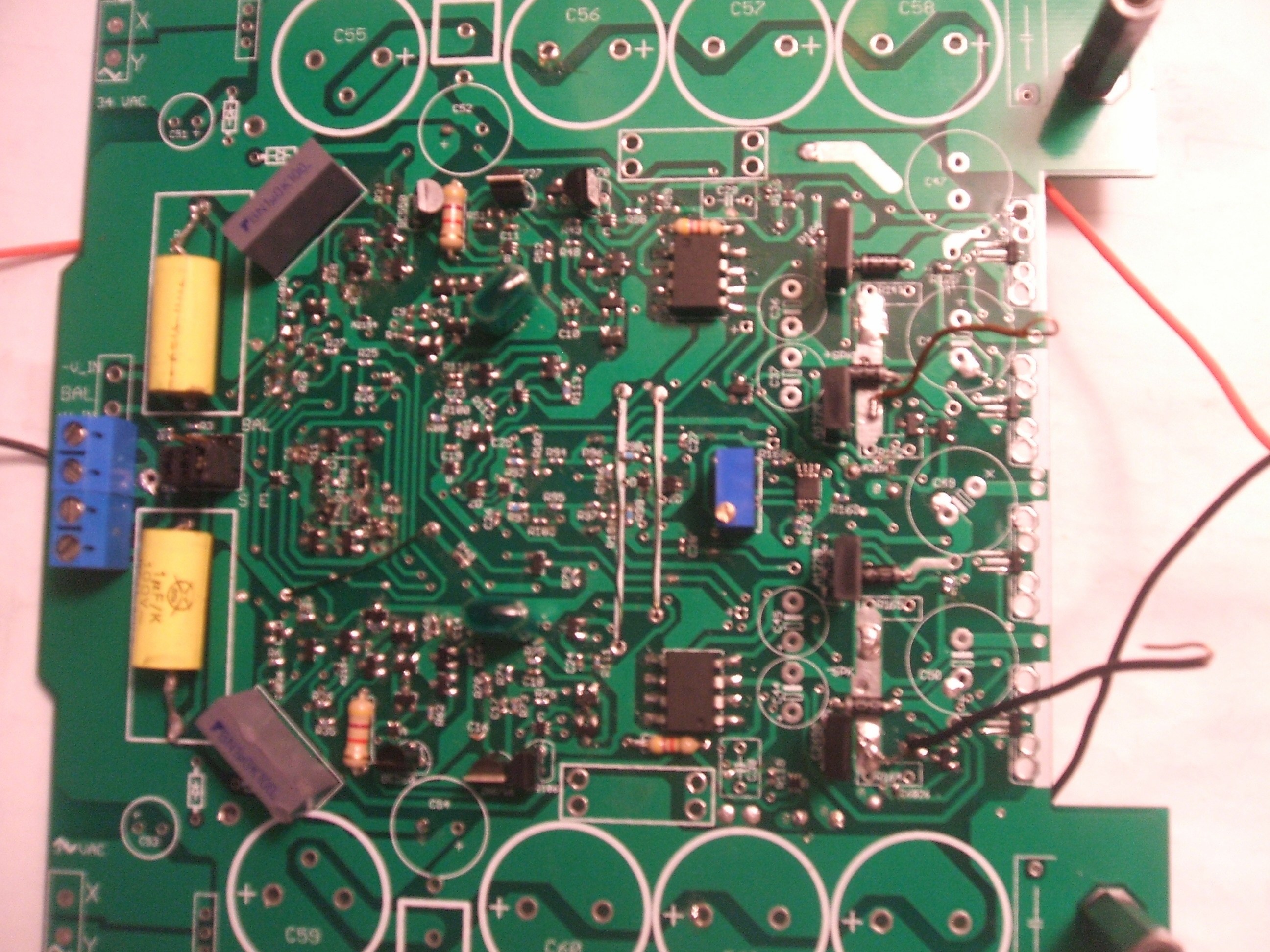

Don’t think you are limited to a simple circuit either using “homebrew” techniques. Check out the first version of my balanced amp I made over two years ago on vero-board…and it still works perfectly. (which honestly surprises the hell out of me. )There are 173 transistors in it.
The next version of this amp I’m currently working on is a bit more compressed. I have gotten everything to work up to the output transistors. That is the next step, for tomorrow, as I still have to prepare a bracket to mount the OPTs. Since I reached my goal for today and have commenced to drinking, I will not continue this evening. More on this amp is to come and I will start a thread for discussion on it. This is an intermediate model the next one will be even smaller. Most of the 0402 size resistors used could well be 0201 size. This latest version would be only but a dream if it were not for being able to ‘low tech style’ cheaply construct the complete circuit initially.
PS: contrary to what it may appear, there are no IC's in this circuit it is all analogue discrete. Actually there is one duel op-amp, a LM358 in a micro 8 package mounted just behind the blue pot, it is used to servo the LED in the two IL300 opto-couplers (DIP 8) that control the bias, but not technically part of the amplifier. Would have gone discrete here as well if I hadn't run out of PCB space!

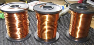

Yup I have about 5Kgs of copper which also increases Interference shielding as well as being very thermally efficient -
On the point of shorts -- it wont happen because white rubber grommets are inserted into the loops making the chance of a short near impossible. It would need to be a component breakdown to cause a short.

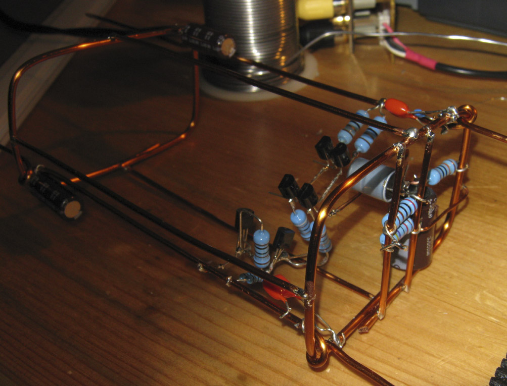

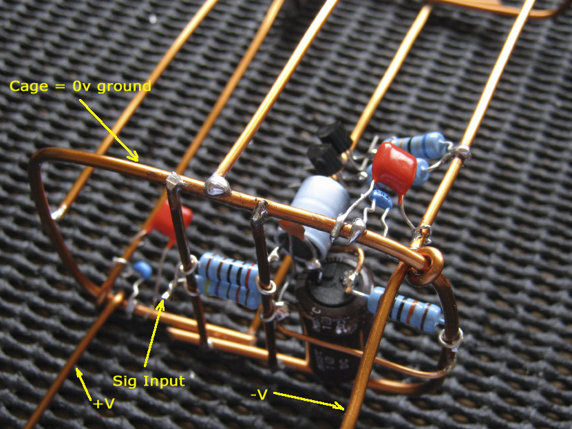

Yup !!! this amp is going to be a true skeleton - here's the cage for the front end and the heatsinks for the power bit -- no conventional PCBs will be used.
oh, nice tower heat sinks
Are you worried about the copper tarnishing and forming an oxide layer on the surface?
Au plating would be nice. ...

I'm going to use this cage as a development mule - then refine the cage and have it produced professionally by precision metal people in copper.
It produces a faraday cage. I saw this method being used for a conical radar intended for the nose of fighter aircraft, and is all heavy gauge solid core. Should make the "solid core speaker cable" fanatics happy (not that they ever are, miserable lot). I'm hoping that with the amount of eventual copper - the reduced parasitics, hardly any capacitive properties without a conventional PCB might make a difference. Plus it gives some other development freedoms and flexibilities.

You would get this effect easier by using a metal enclosure; due to the smaller openings it is even more efficient. As you certainly know, electrical fields are usually not the problem, the magnetic fields are...but this should of course do not stop you to go ahead - it certainly looks great!
