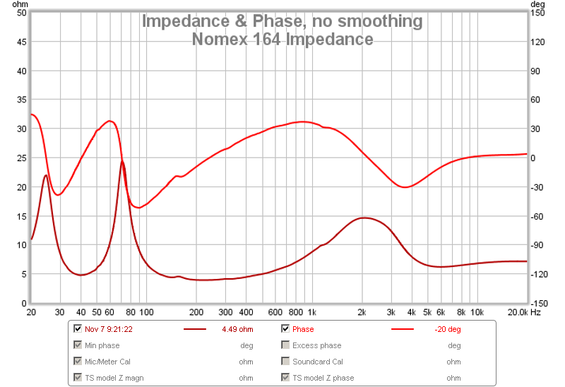

Hi, the bobble that you see in the impedance plot around 180Hz is most likely a resonance that occurs longitudinally down the entire length of the enclosure. Eliminating this would be a good idea and should be achievable by heavily stuffing one of the 'chambers' created between the horizontal cross braces, just don't stuff the chamber with the port in it.
It depends, but any resonance implies a storage and delayed release of energy. In much the same way that cone resonances tend to create peaks in the frequency response and then, if looked at vs time in a CSD plot have associated ridges that take longer to decay then where the frequency response is nominally flat.
A cabinet resonance such as this isn't going to be a game breaker, but it should have some negative impact on the sound quality, perhaps giving a slightly chesty/boomy quality to specific notes.
A variety of free programs will measure the impedance, ARTA, Holm Impulse and Loudspeaker workshop. I've used both ARTA and Loudspeaker workshop and both work fine. ARTA's Limp package is quite a bit easier to use both in terms of hardware and software.
And yes, heavily stuffing one of the compartments should be enough to breakup the standing wave.

Concerning the impedance peak at 156 hz, it is now less important after adding some more stuffing, see attachment.
First, I'm going to work on the tweeter level and modify the lpad with 1.5 and 12 ohms, 2 and 9 Ohms.
A quick test with an equalizer (Linux Jack + Jamin) make me think it need ~1 db more of attenuation.
I've use this calculator with 5 Ohms as driver impedance :
http://www.diyaudioandvideo.com/Calculator/LPad/
