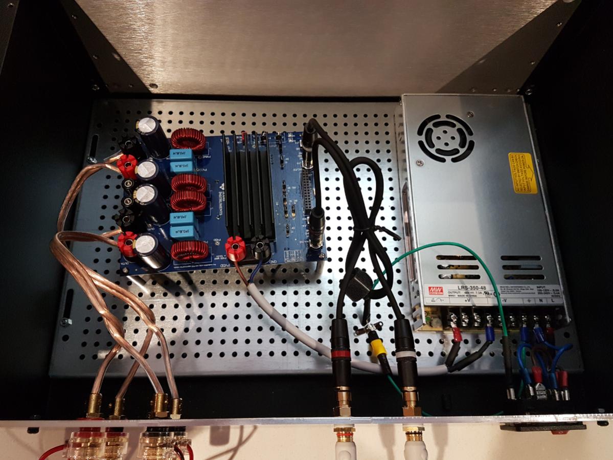

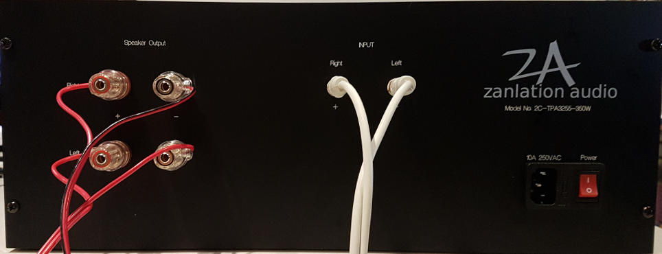

After a few months of pulling together all the parts, I finally setup the TPA3255EVM over the weekend. Firstly, this was the easiest build yet. I am still very much a novice and this was my third successful build. I originally ordered the case for a 4 channel setup (2x TPA3255EVMs), however when I added the amps and power supplies it was too tight for my liking. So, this is the first stereo amp and I am thinking of creating a mono for the center speaker as the next build.
I connected the amp up to my test speakers and laptop, and hit the power switch. What struck me first was how quite it was, both the amp/power supply and the speakers. I played a few songs through the laptop and was very impressed. When I switched the amp off I heard a thump through the speakers. Many others have reported a thump on start up, but mine was quite. Has anyone have a solution for reducing/stopping the thump on power off?

I spoke to soon about the easy build. I switched on the amp this afternoon and the red fault light came on. The manual refers to this as an over temperature indicator. I have double checked every input and output and I cannot find any issue. The power supply lights up, as does the green indicators on the amp.
Any ideas?

You could try this... bing the Reset switch to a switch on the front panel. Label it On/off.
Use the Wall switch to power on the Amp.
So when you will switch on the Wall socket, the reset will be engaged. Disengage Reset to listen to music. Reverse, when you switch off.
