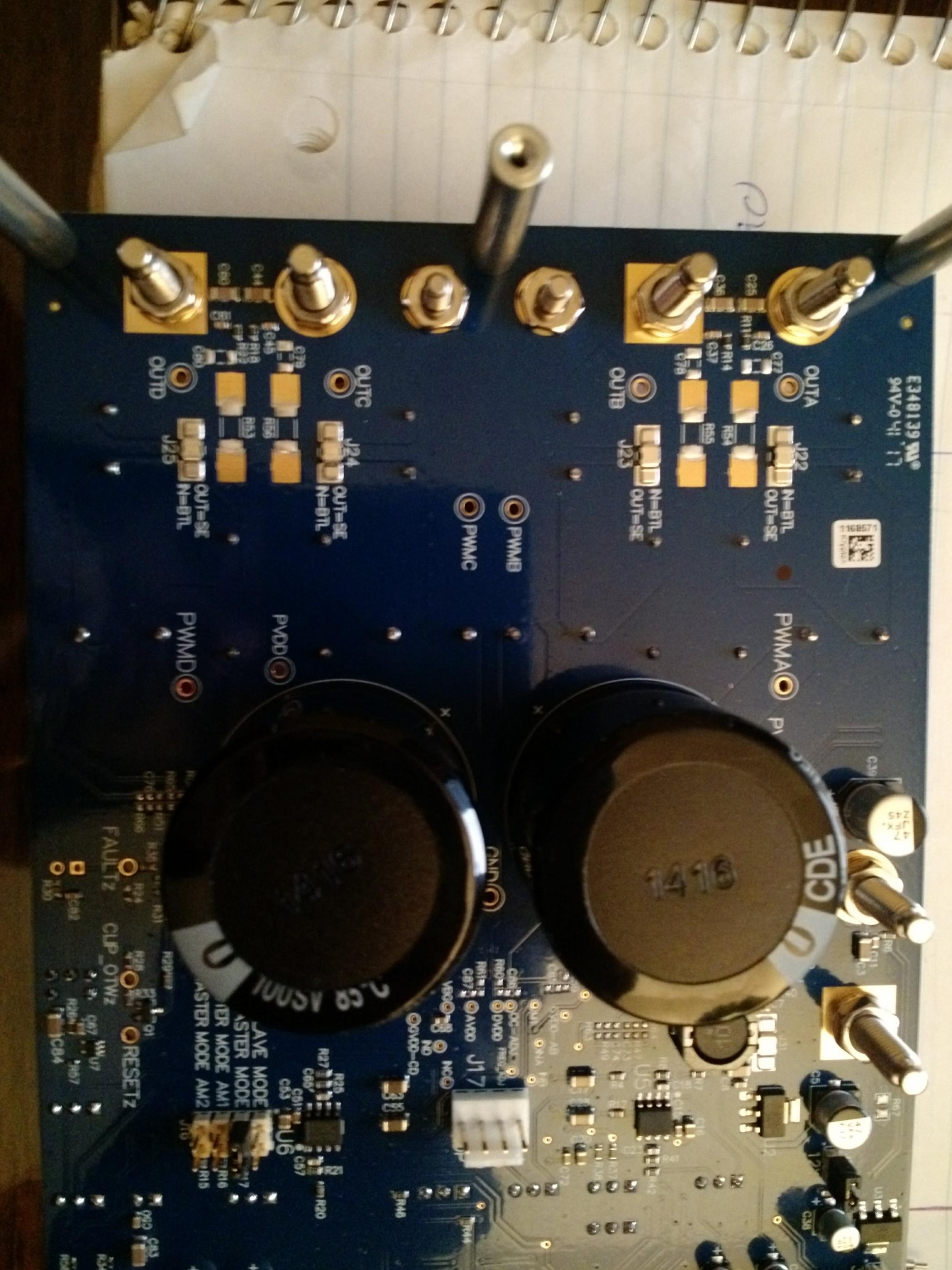

My board is stuffed into a chassis, so it would be a pain to take a picture of the bottom of the EVM. Here's the User's Guide
http://www.ti.com/lit/ug/slou441/slou441.pdf
On page 11, bottom image, the soldered jumpers are J22 thru J24 near the left side of the image. As delivered, the jumpers are all soldered in place. The instructions are are pages 6 - 10 for the various combinations.
They are pretty small. When the jumpers are removed, the output will pass through the four 1500uf caps on top of the board, so no need to replace the jumpers with coupling caps. Perhaps someone can post a picture of the bottom of the EVM.
One other thing. In SE mode, the gain is only 21.5db, not the 27.5db gain you would get in BTL mode. This may or may not be an issue, depending on the miniDSP you are using.
