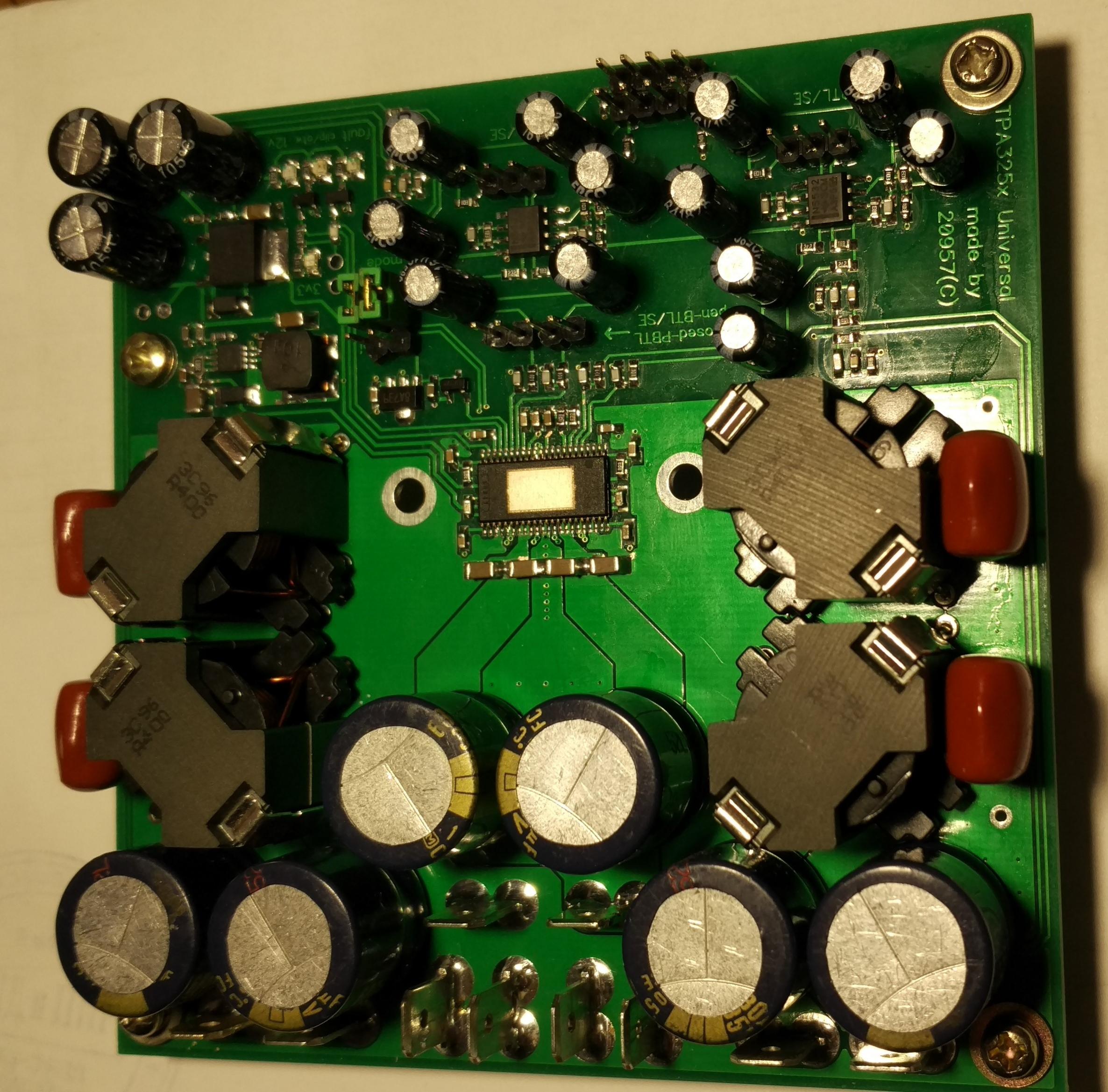

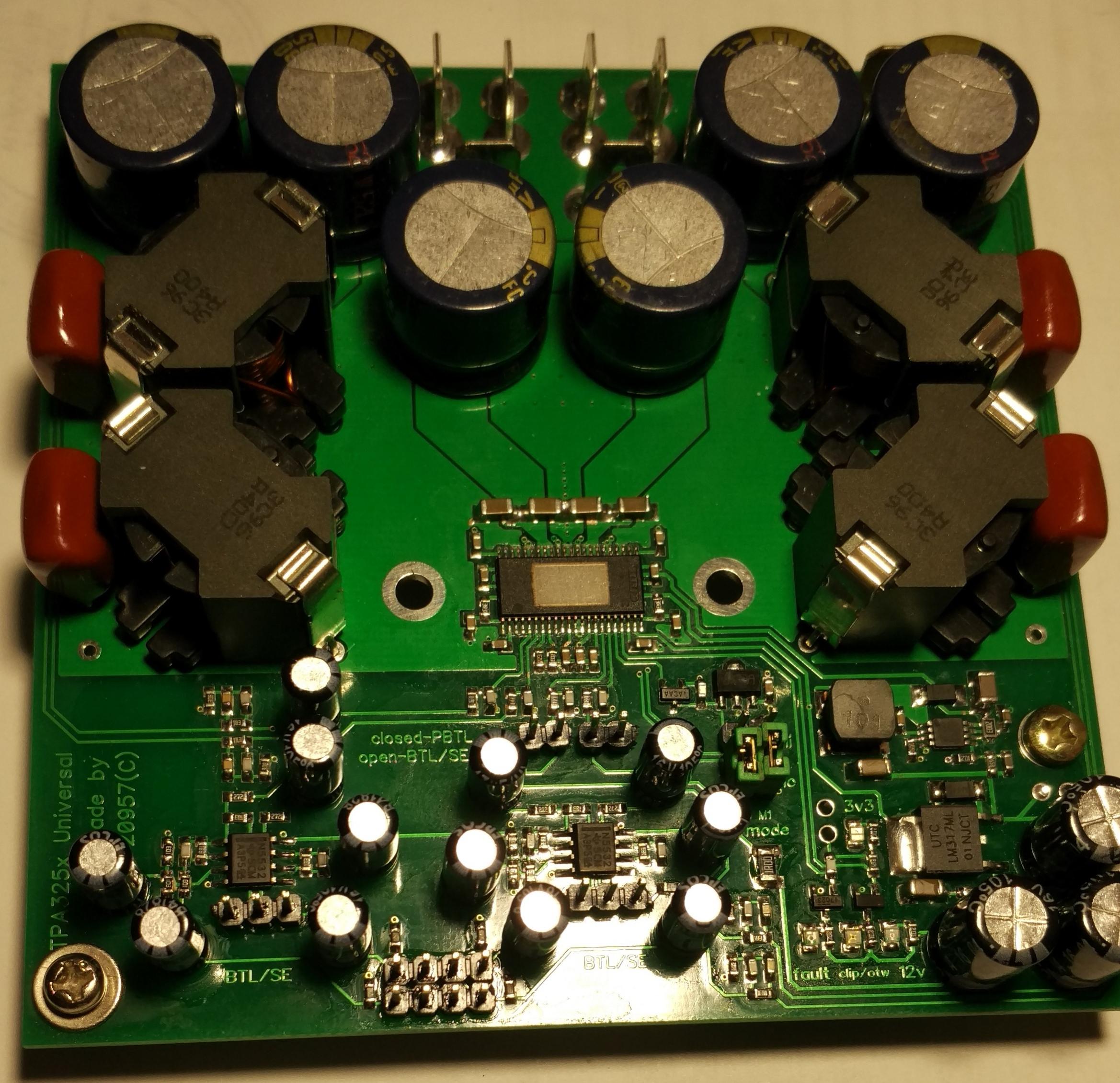

A couple of the 258rmb Taobao boards arrived yesterday evening - and I started looking at the power supplies for the signal stages (input opamps and 12V to the TPA3255). A quick listen first and that was promising, the usual classD clarity of bass lines - far from transparent in the HF though.
Checking the DS for the LM2575 (note not -HV so supplies above 40V won't be tolerated) and looks like the board's designer didn't take to heart the guidelines expounded there. The output inductor for this (buck) reg is marked on the silkscreen as '220uH' but what's fitted is a 22uH (220 marking). My reading for the nomographs in the DS (fig 30 pertains as its a -15) shows a recommended inductor of 2.2mH, which I just happen to have in my box.
The output capacitor fitted is a 10uF/35V SMT. I removed this and checked its ESR - around 5ohms. To replace it I went with a Sancon 220uF with about 0.1ohm ESR. Note the DS cautions against caps here with ESR below 0.05ohm - stability may suffer.
I've not 'scoped this yet but I figure having the correct inductor value (100X bigger than fitted) and an output cap 22X larger has to help with output ripple.
Next stage - an LC on the output.
