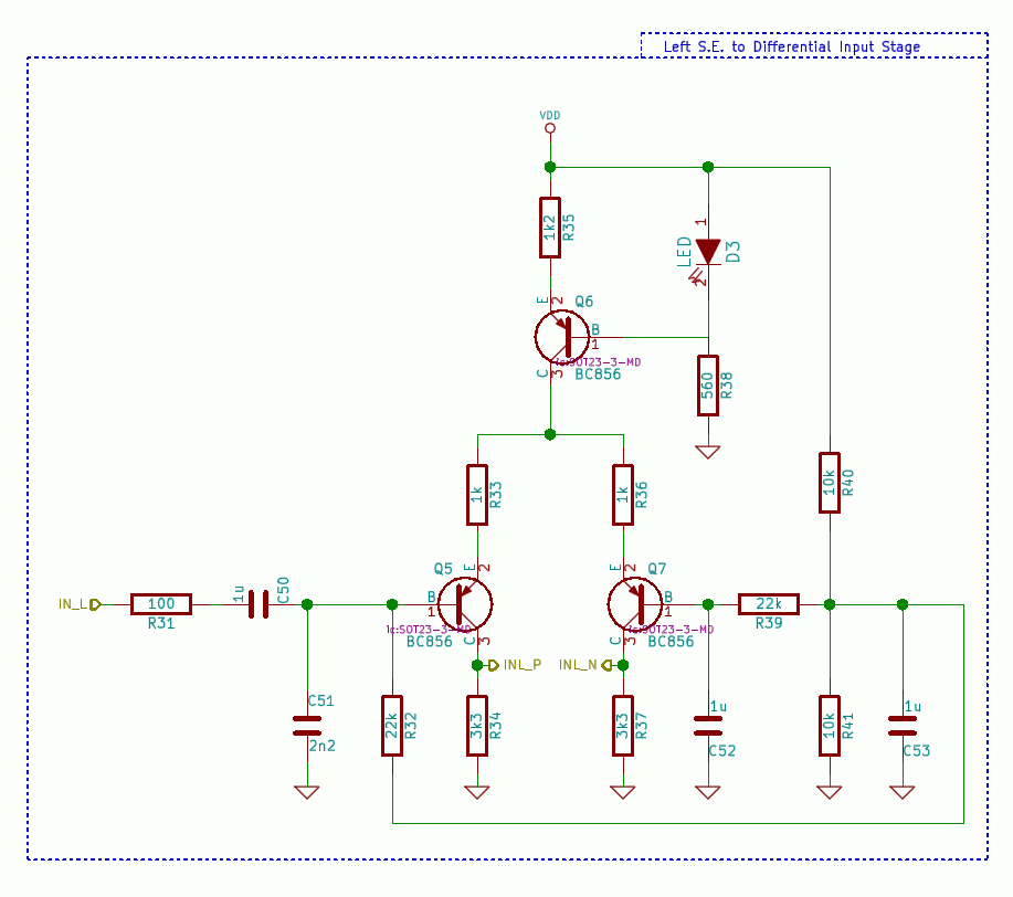

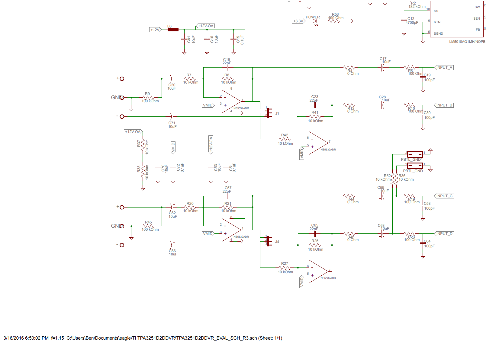

Hello all,
I managed to find some time to try to replicate the EVM's source input. I am having an hard time understanding the input jack schematic, such as the jack's contact and spring seems confusing to me. Anyhow, is this a correct way to implement single ended input?
I have also included a second attachment on what I had for differential input. I am assuming that this would not work at all?
Thanks.

Seems fine to me. You might want to have resistors on your (+) inputs from Vmid to further reduce crosstalk and improve immunity to possible EMI susceptibility, like GSM/3G/WiFi. (2k2 were needed here, even the AFE is a bit different)
VMid resistor divider might be more "low-impedance" and get a bit more of capacitance.
(like 1k/1k for the divider and 100uF for Vmid)
While the 5532 is sufficient for the AFE, we had good success with the OPA2134, which is a bit more "immune" to radiation.
Or you leave the opamps out and go the classic BJT way.

Thanks again for your expertise Doctormord.
I already ordered the parts but I will get some OPA2134s. I understand that they can be drop in replacements for the NE5532?
Would the differential input circuit in the 2nd attachment work. I want to have diff inputs but am unsure about it due to my ignorance.
Yes, they're dropin-replacement but there's nothing wrong to have the resistors on your (+) inputs as well. (if not needed, bridge with zero ohms)
Having more possibilities at initial start makes life easier. dropping them later is easier than fixing a layout by fly-o-wire. :)
The diff stage seems fine to me, same as EVM.
