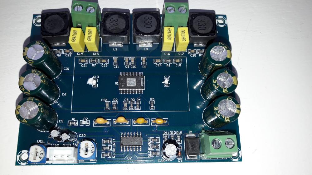

Looks like there are two chips on the board.I just find this board on Ali.
Any link?
What kind of problems have you had with the 2.1 boards?
I've been browsing them for a while, thinking that I would do a build with two FR speakers and a small sub. I was looking at this one, at least it has enough adjustments to get the levels matched:
TPA3116 2.1 50Wx2+100W Amplifier Board Digital HIFI 12-24V Super Bass Speaker | eBay
This is a great board; I have 2 of these. The board carpne links to, is just half of it and is probably from the same designer and manufacturer.

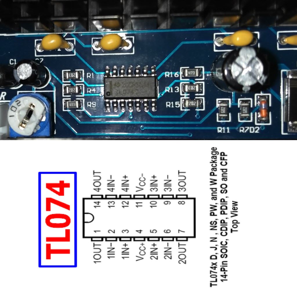

Long time lurker here, and I just got my first TPA3116D2 board. It's a dual chip stereo version called XH-M569 and well, I'm not too happy about it. It has the power, sound is ok but there is a problem that I don't see mentioned much here - background hiss is just unbearable! With pots turned down or up, input connected or not, doesn't matter. It has a TL074C opamp on input with and it looks like gain is too high, considering that when turned to maybe over 10% it becomes hard to control volume, and I'm experimenting with a mixer on input.
https://img.alicdn.com/imgextra/i3/199304554/TB2hlFne.EIL1JjSZFFXXc5kVXa_!!199304554.jpg
So I was thinking, since I'll be using it with a tone control/preamp board (not yet arrived), I could eliminate TL074C and possibly get rid of that hiss.
http://www2.ensc.sfu.ca/reference/data-sheets/TL07X.PDF
By the looks of it, I can desolder it and bypass input to output. Or just cut its power line? Any advice?

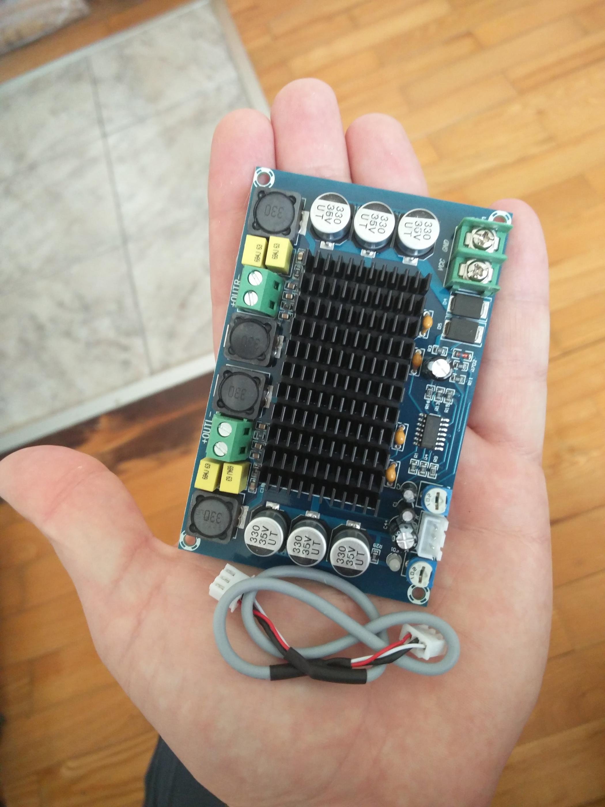

Are you sure it's a dual chip version.....Hello all,
Long time lurker here, and I just got my first TPA3116D2 board. It's a dual chip stereo version called XH-M569 ....
I am. Board is a bit different from yours, I haven't taken the radiator off but some people did and everything looks as it should. See here, there are some other sellers with more pics from customers:
M569 new AMP TPA3116D2 dual channel preamplifier 150W + 150W power digital amplifier board C3 004-in Amplifier from Consumer Electronics on Aliexpress.com | Alibaba Group
Plenty of power. Unfortunately, noise too.

That's what I thought so. But, how?
I should desolder it, and connect input to output, bypass it like it wasn't even there, right?
From what I've read in last couple of hours, Tl074 is an odd choice because it is better suited for microphone and instrument (guitar) inputs. Never thought much about it when I was buying this board
