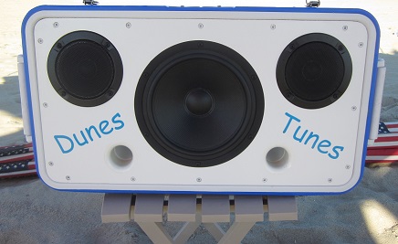

Here's my implementation using a TPA3116 2.1 amp (2x50w + 100w). The 8", 4 ohm woofer's sensitivity is 91dB at 1w/m (94dB at 2.83v/m). I'm running at 24v so I'm getting 108dB spl. I modified the amp's on-board LP filter by replacing two poly caps to include baffle step compensation. The mid-ranges only go up to 10K hz as I can't hear that high up (and your not going to get stereo imaging in a single unit).

Hope it's not criminal to post a picture of my completed Volt+
Love this amp with the Astron power supply.

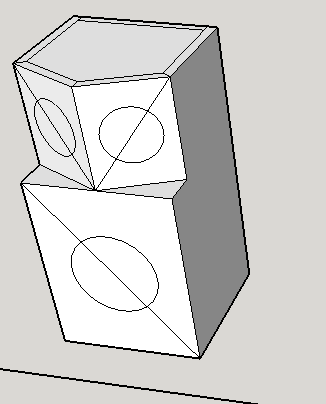

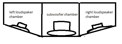

I think that for stereo sound in a compact factor, it could help at certain degree placing the loud speakers almost in diagonal angle, as the showed picture below I am showing. I made that design some time ago, although never build it, I was looking for an enclosure that is 2.1 and I gave it a vertical shape, looking for space saving. I think that each loud speaker should have its own isolated chamber, so the internal sounds don't mix together, ruining the intention of having some stereo sound. A horizontal shape should be even better, since the loudspeakers can be more separated each other (see second picture), of course all this is only possible doing some woodworking and throw away the intention of using any already made rectangular enclosure, although you can make some adapters to the loud speakers in order to give them some angle and increase the stereo effect.
Each driver needs to be in an isolated chamber by itself.
In a 3-way speaker the woofer's sound pressure will be imparted on the midrange's cone distorting its sound. So the mid-range needs its own space. Most tweeters are self contained so they are not an issue.
Two woofers sharing the same space come into issues with the differences between the L-R channel program. Say a bass guitar is mostly recorded on the R channel while a piano is mostly recorded on the L channel. The difference between these signals will cause each woofer to impart its sound pressure on the other.
I don't think you want to angle the speakers out. I don't know of any speaker modeling s/w that supports that alignment. And, if there was a benefit, many commercial offerings would likely have done it.
