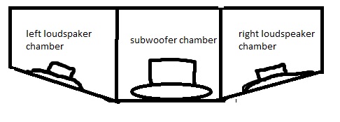

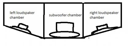

Each driver needs to be in an isolated chamber by itself.
In a 3-way speaker the woofer's sound pressure will be imparted on the midrange's cone distorting its sound. So the mid-range needs its own space. Most tweeters are self contained so they are not an issue.
Two woofers sharing the same space come into issues with the differences between the L-R channel program. Say a bass guitar is mostly recorded on the R channel while a piano is mostly recorded on the L channel. The difference between these signals will cause each woofer to impart its sound pressure on the other.
I don't think you want to angle the speakers out. I don't know of any speaker modeling s/w that supports that alignment. And, if there was a benefit, many commercial offerings would likely have done it.
That's why I said that each driver should have its own chamber, so the internal waves don't mix and interfere. Actually there's no need to build dedicated chamber for each loudspeaker, there are drivers that have a back enclosed. I don't know why you thought that thing about angling the directions of the loudspeakers, is not it like you have to modify anything, you simply are orienting their straight face to certain degree, so they are not "looking" straight at the front, but a little to the left and right, separating the stereo waves and so having a more remarkable stereo sound effect. This can be done thanks to the angle form of the board that has the mounting hole, you don't have to bend and or modify the speaker or something like that.

Two speakers pointing in two different direction won't give you the stereo effect.
Stereo effect only appears with the sound coming from different directions towards the point where listener is.
