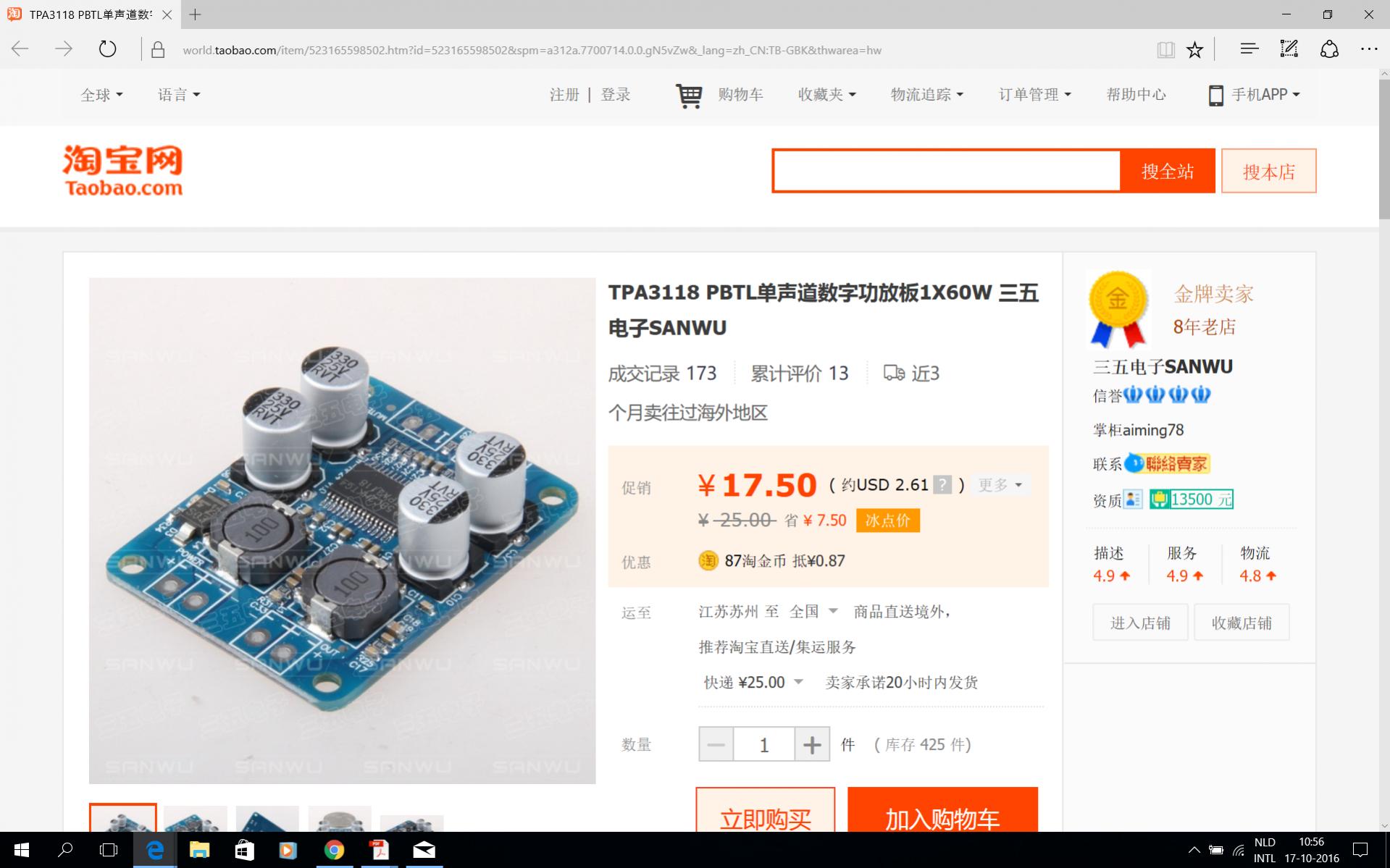

Why are those TPA3118 popular pbtl boards labeled as 60W? If i am correct, TPA3118 has the same capabilities than TPA3116, which can outputs peaks of 160W on pbtl with 2ohm driver. Is it just because they have small capacitors and no heatsink? so one should balance the output around 60W? (varying voltage input)
At the moment the version pictured by Sanwu themselves is below. But if you order one with blueline/tdk inductors pictured you will probably also get a board like below:)

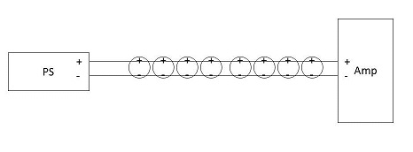

Wire them all in parallel, all the +leads tied together and all the - leads tied together. They don't have to all be physically arranged in single line as in the pic., just electrically. The 35V - 50V order really doesn't matter.
Thanks Mike. Very kind of you. What I did over the weekend, is making a trial run with 8x 1000uF stock caps from the dual chip board. When I hooked it up, I could be wrong, but the sound became worse! It sounded lazy, sluggish, and muddy. I took it off immediately and now listening to it supplied directly from the PSU.
My question: Is it simply because of bad caps used? Will all class D amp, or any amp for that matter, benefit from a properly designed cap bank?

Board should be labelled SANWU. Despite the low price, there are clones undercutting them.
