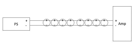

I am making a capacitor bank, can anybody me to a wiring diagram? How to connect the caps and how to connect to amp/PSU. I will use 8x 1000uF, thing is 4 of those are 35V and 4 others are 50V. Is there any order I sshould put them, or anyhow is fine? Thanks so much.
Wire them all in parallel, all the +leads tied together and all the - leads tied together. They don't have to all be physically arranged in single line as in the pic., just electrically. The 35V - 50V order really doesn't matter.
