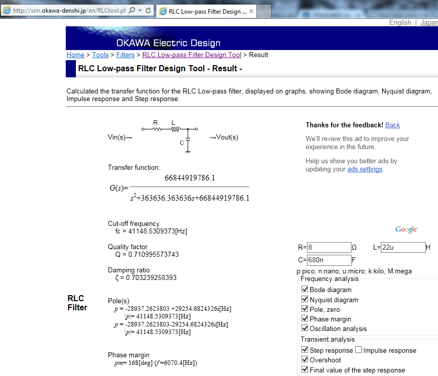

Joined 2008
Here's one more example, maybe simplifies things:
Using Okawa RLC Design Tool, I input R=8, L=22u, C=0.68u. Results:
Cut-off frequency, fc = 41148.5309373[Hz]
Quality factor, Q = 0.710995573743
Damping ratio, ζ = 0.703239258393
Now, I found this document: TI Application Report: Class-D LC Filter Design (referred to in this thread as "SLOA119A")
Bottom of page 4 has formulas for C and L:
C = 1 / ( fc_rad * R_L * sqrt(2) )
R = R_L * sqrt(2) / fc_rad
Where R_L = speaker impedance, fc_rad = cutoff frequency in radians/sec (little omega, i.e. cutoff freq in hertz * 2pi).
If input everything the same as the Okawa tool, except using R_L=4 (half of 8 above), then I get the exact same results.
Either one of these things is off by a factor of two, or (more likely), my application of dividing by two is wrong.
When I use the Okawa tool "Calculate the transfer function for RLC low-pass filter with R, L and C values" with input R=4 L=22u C=.68U
I get:
Cut-off frequency
Quality factor
Q = 0.703239258393
Damping ratio
ζ = 0.710995573743
Same or close to what you get for R=8. I am using this for an 8ohm impedance speaker and 1/2ing the impedance for R.
Confusing.
Joined 2008
I get:
Cut-off frequency
Quality factor
Q = 0.703239258393
Damping ratio
ζ = 0.710995573743
Confusing.
I did all those calculations at my work computer. Now I'm at home, and seeing your post, I assumed I did something wrong. But I just repeated it here, same result. Then I thought maybe it's a browser issue. But I got the same thing with Chrome, Firefox and IE.
What you are getting with R=4 is consistent with the TI application note document, as well as what all these PCBs are actually built with. I don't see how the tool would only be broken for "me", so maybe I'm using the wrong part of the website? Here's a screencap:
Edit: you used C=0.68u and my screencap shows 680n. I actually tried both, same result (as in reality 0.68uF = 680nF).
Browse down to L-C-R filter where you see R like it is connected speaker. You filled in R-L-C filter, that is only difference. All values in table are wrong, seperate posted Q=.7 for 680n/22u 8 ohm is correct

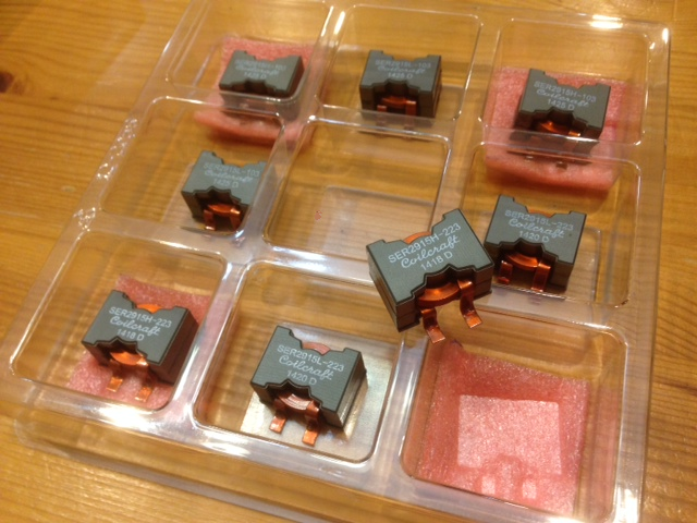

Here are my new SER Coilcrafts. They are a thing to behold - huge and very beautifully made. I have never seen flat thick soiled wire like this. Will put them on my gen1 DUG amp next. I have both 22uH and 10uH, deciding which way to go - maybe 22uH for 8ohm speakers? I have been using 10uH and happy.

Joined 2008
Yup, that's it. Using the calculator for the wrong circuit. I knew I was doing something silly. :)
Now that I think I know what I'm doing (you be the judge), I hacked up a little script to generate the following table. I spot-checked some of the entries against the (appropriate) Okawa calculator. Except for some small rounding error, I think this is correct. For every speaker value, I did four calculations:[list="1]

| 1.896
| c=0.68uF/l=22uF
