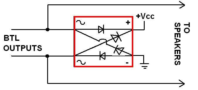

Sorry, did not see the little 1 and 2 from my phone's screen. As they go to the power rail and ground, they are clamp diodes just like Dug suggested. But why is this needed or helpful? Seems like it may add some sort of diode switching noise to the system at the crossing level of 0.6VDC?
No worries! I think you and Dug are right. Not sure what all the extended B.O.M. is doing but if it's hurting the sound, it's not too obvious. It's clearly the best (nearly stock) board I've heard to date and aside from the caps that I swapped, I'm not really chomping at the bit to change much. I'm ordering another one to see if it's a fluke.
Does it limit output voltage swing to PVCC voltage then maybe? Positive output voltage already is limited to PVCC voltage, so then it is kind of BTL that has as maximum the SE output swing if that is close to rail ??? It adds a little leakage noise to output on low voltage output and adds noise to powersupply on high voltage output, if swing isn't above -13.5+13.5, 27V (-10%) it won't shutdown tpachip ??? Like that? I don't understand it

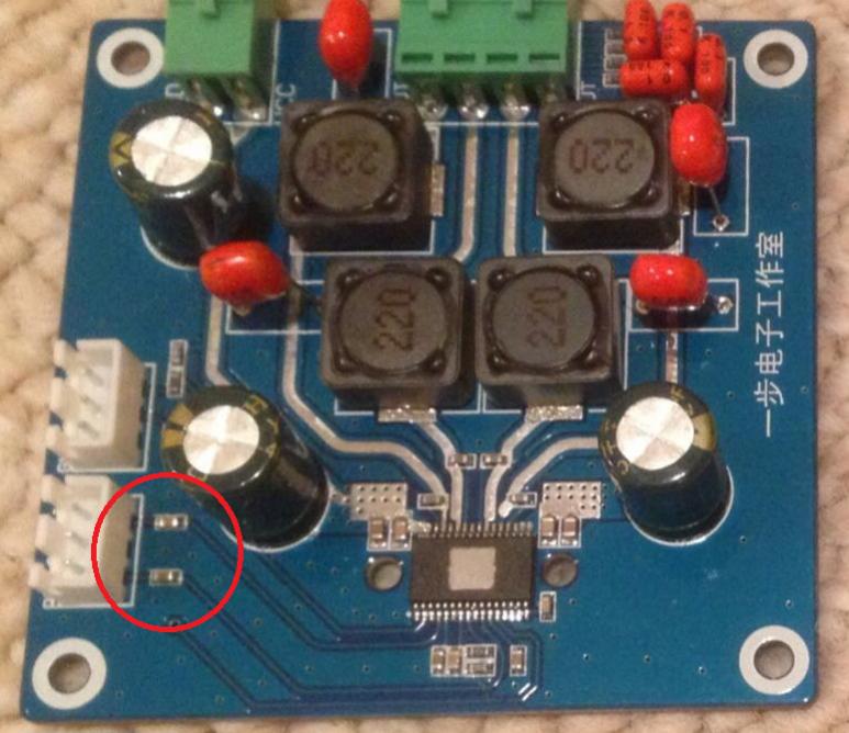

I believe you with 0805 caps but I am pretty sure these are not 0805's - more like 0402's or 0603's at the largest. Look at photo and for size comparison,the pin spacing on the 3-pin header is typical 0.100 inch, and pin spacing on TPA3116 is 0.6mm or 0.0236 inch.

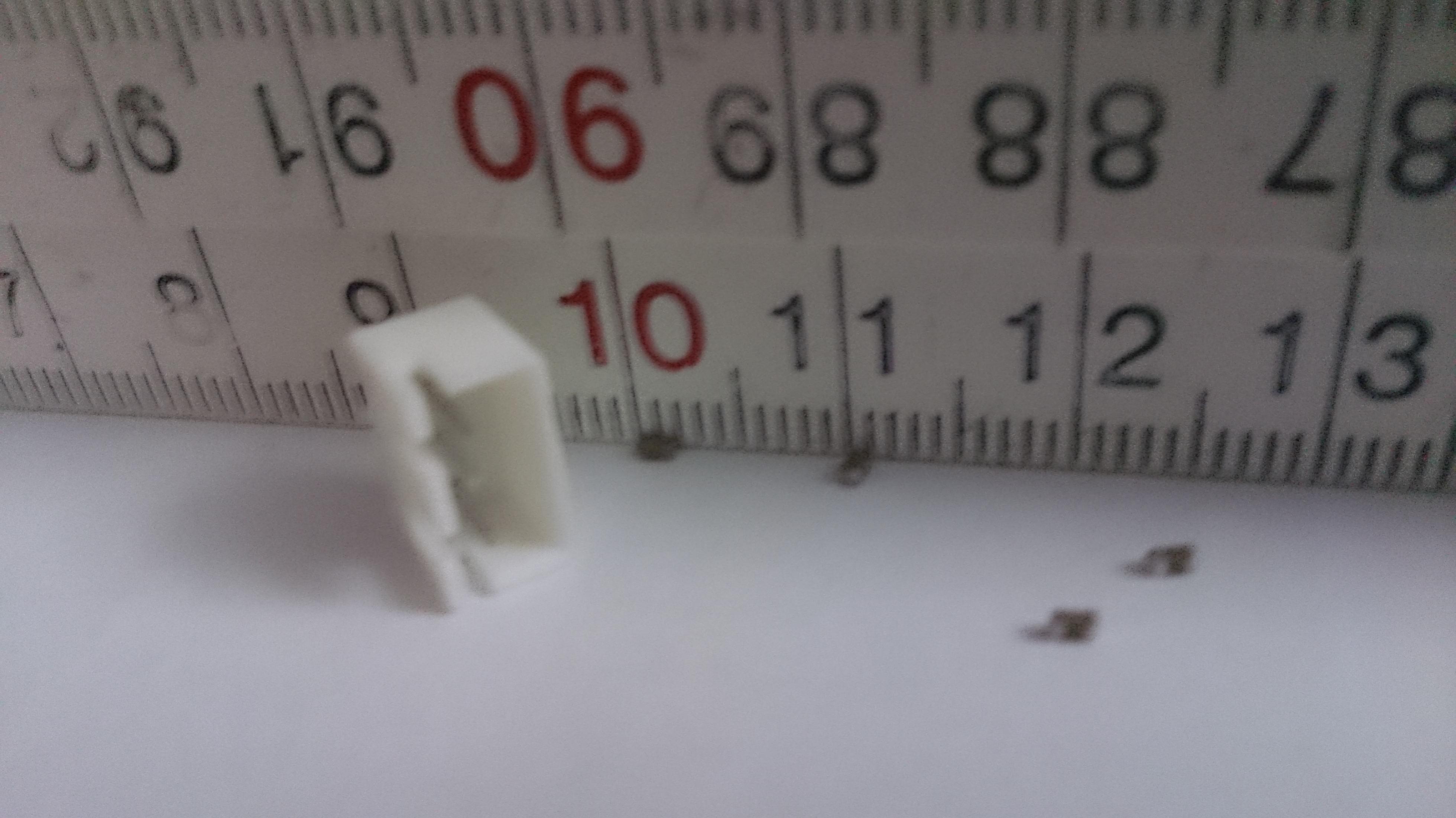

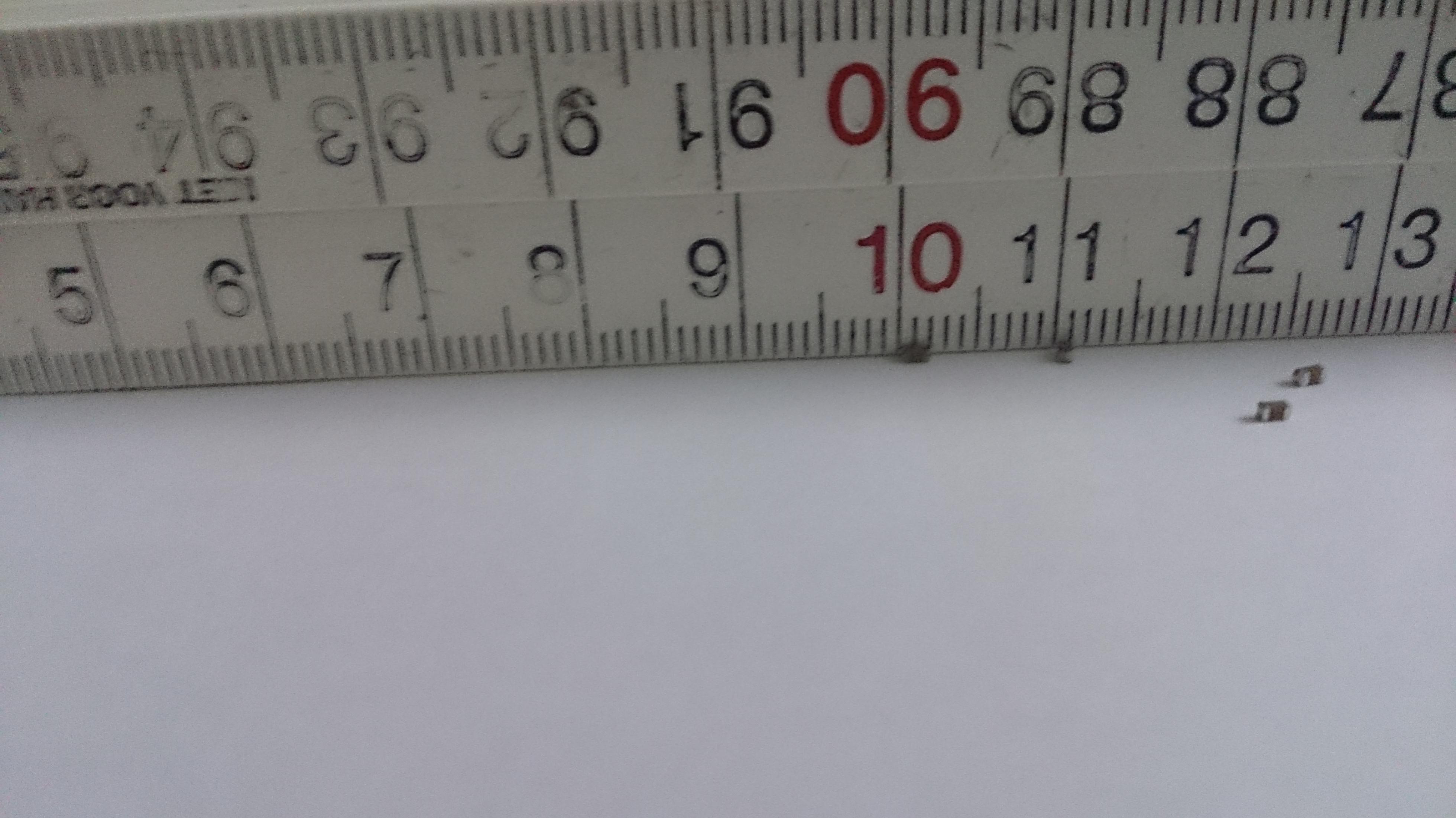

Correct that are 0805's :D Measure them and you will see these are the 10uF's off Weiner pcb:
