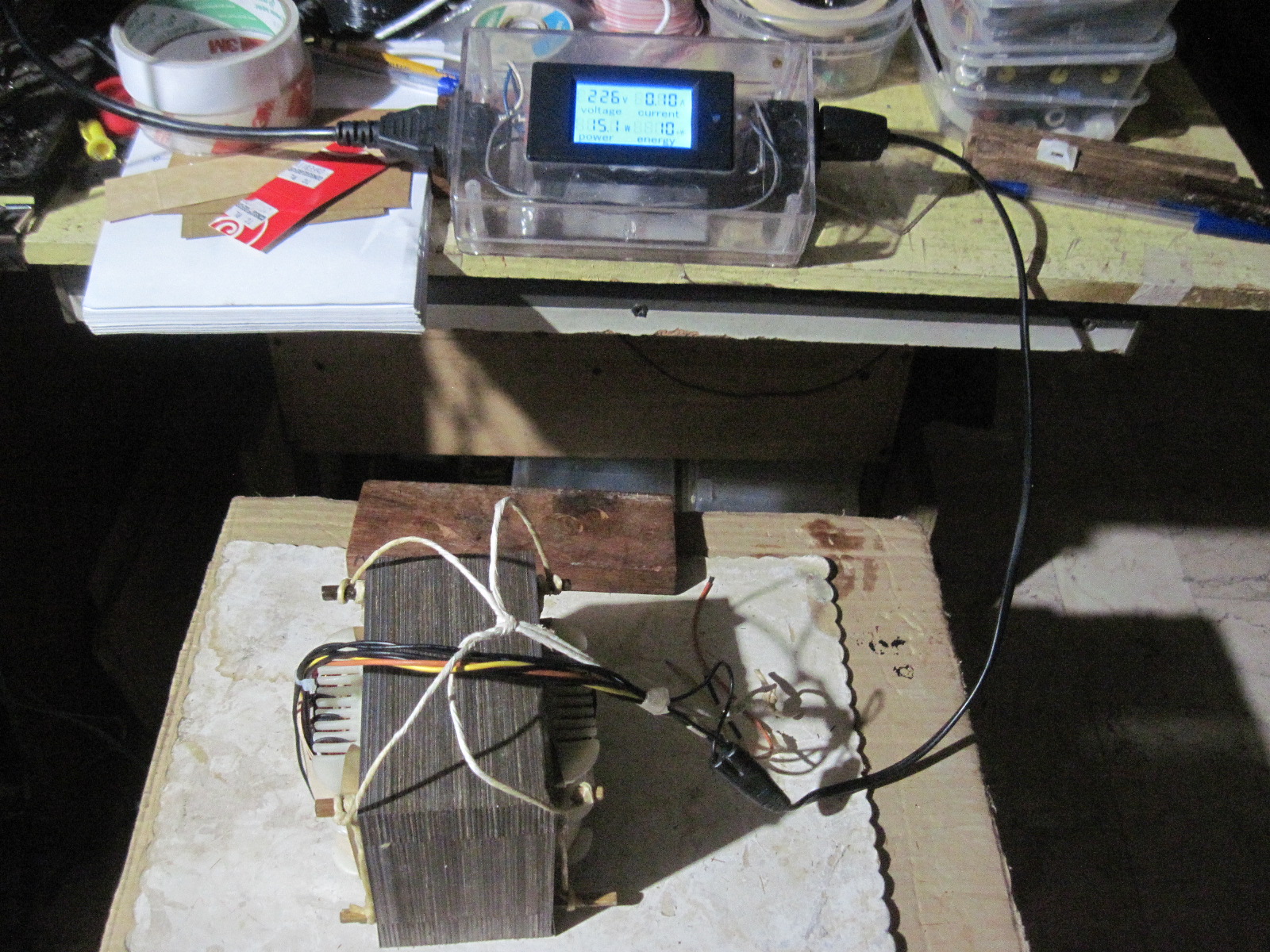

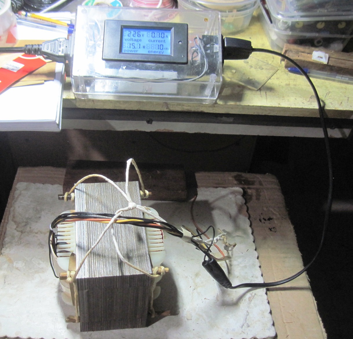

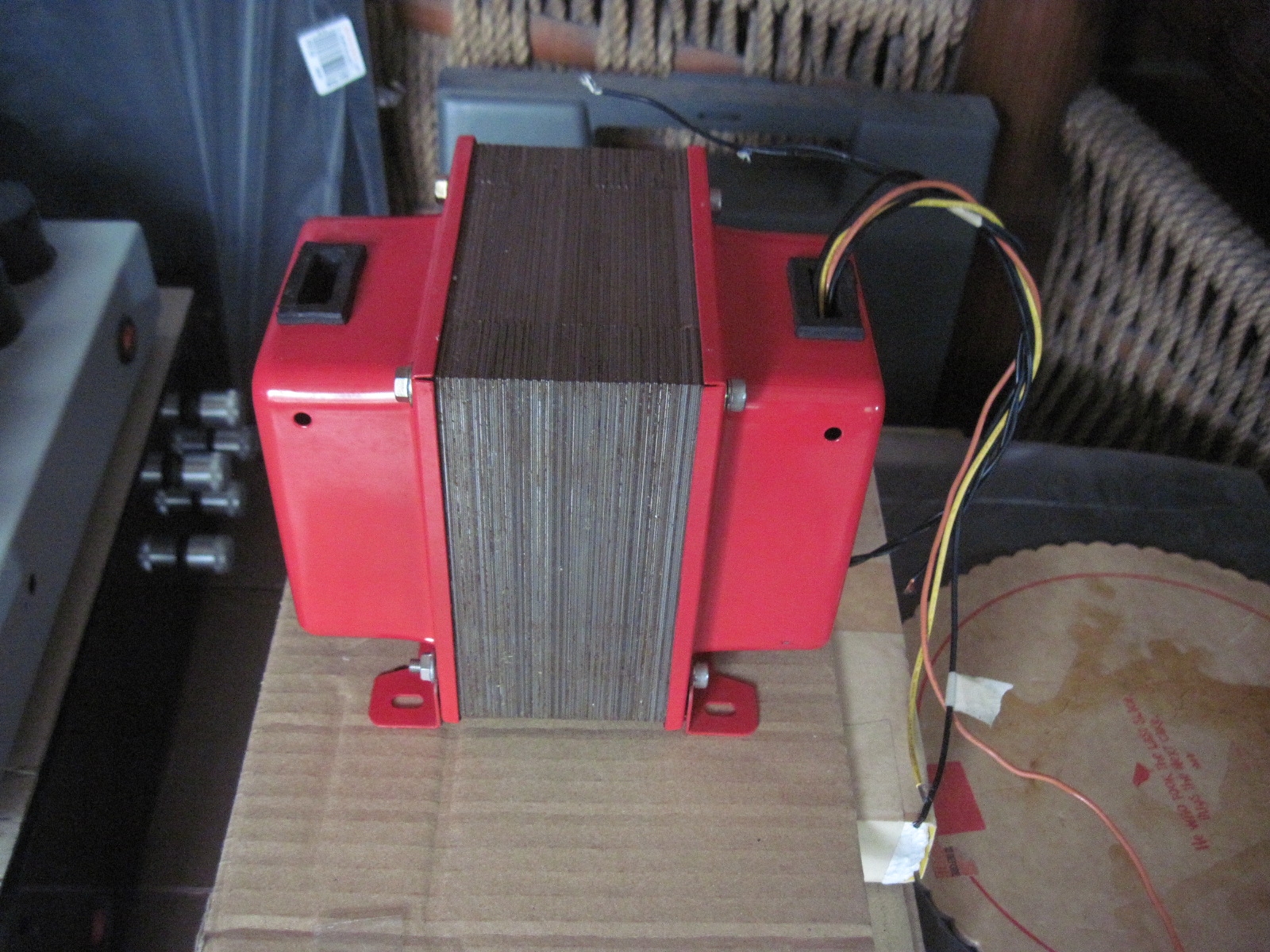

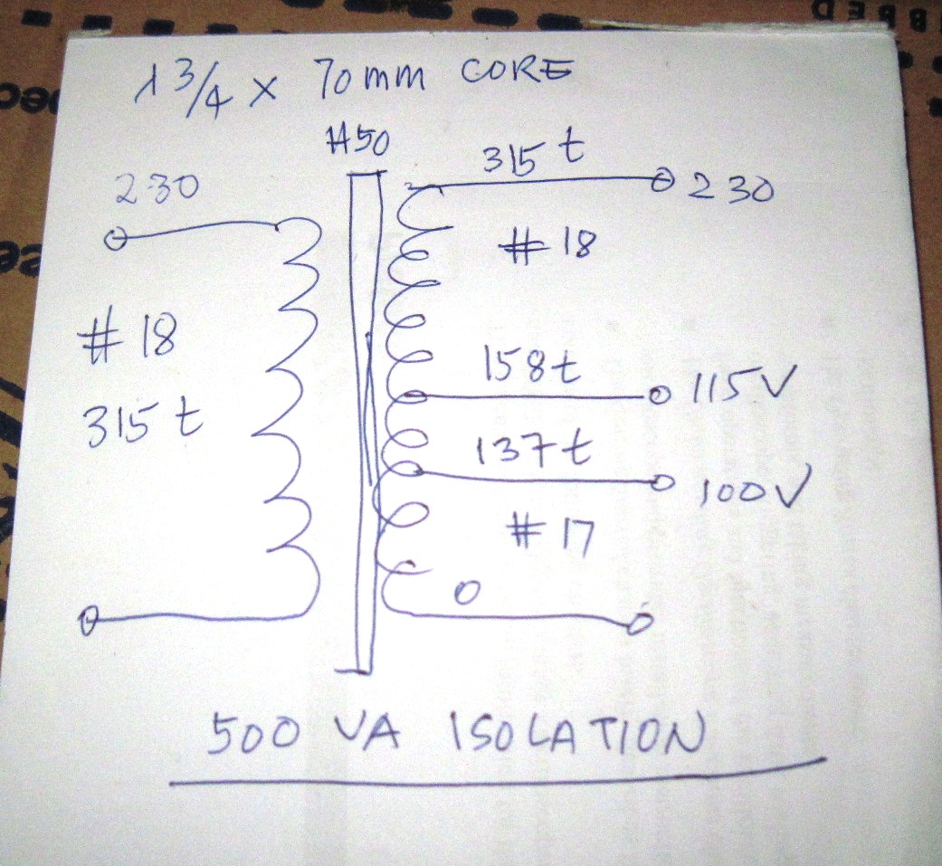

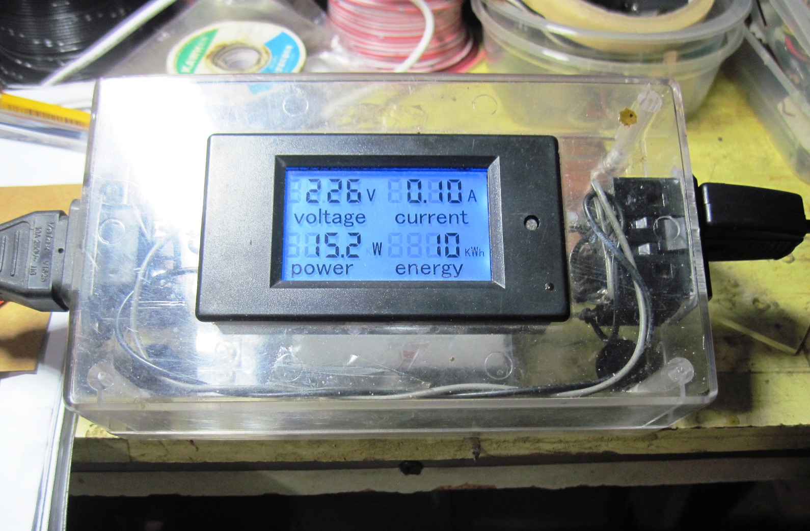

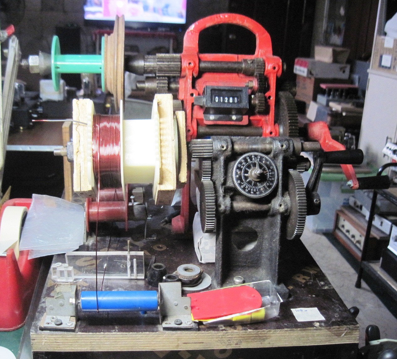

500 VA isolation traffo for my bench top...230 volt primary to 0 to 100, 115, 230 volt secondaries...

calculate if your chosen wires will fit inside the 1 in x 3 inches winding window...
way i look at it, more like #15 primary and #12 secondary...
i thought that too but first, are my computations possible (power:core) ratio?
secondly the way i look at it as i have samples of number 14 wire
in a window of 1"x3" less the bobbin roughly i would take 7/8 x 2 3/4 allowable winding area, so based on actual #14 magnet wires can turn up to 38 in a 2 3/4 bobbin size. I multiplied 38 x 5 = 190, and 5 turns of #14 occupies about 3/8 of an inch.
next the available window left was 1/2 x 2 3/4 unfortunately i do not have #11 sample but as i look into your table turns per linear inch
enamel D.S.C. or S.C.C. D.C.C
#14 15.0 14.20 13.8 i used 14 turns per linear inch as presumption = it works
#11 10.7 10.3 9.8 i used 9 since i do not have sample to compare with.
the bottom line here are my interpretation and calculations based on your table correct?
thanks
regards
the coil build up is what we look at, if that fits then you can go...
#14 has a diameter of 1.63 mm
#11 has a diameter of 2.3 mm
so how many layers for primary?
how many layers for secondary?
this will guide you to make the final decision...
ok sir thank you for the quick reply
i used english system as i saw it on your table
using metric 25mm x 75mm
#14 actual size at hand was 1.83 into (75mm) 70mm on bobbin 70/1.83 x 5 layers = 191 turns
5 layers x 1.83 = 9.15 or 10mm
for #11 i used the next size guide say for example 2.7mm
#11 @ 2.7mm into a 70mm area will allow 25turns per layer, it needs about 4 layers that will also occupy 10.8mm
that is 9.15 + 10.8 mm = 20mm
by the way i am ordering #11 wire sample to have final measurement.
thank you sir.
20mm is too tight, remember that calculations do not take into account winding factor,
if your calculations give you 20 mm as build up, do not count that that will be the actual buildup once you start winding, that is why i always end up with one size lower, better safe than sorry...
but if you can squeeze them in, why not? use mandrels and a big vise to flatten the coils so it fits...or g-clamps cam be used...
