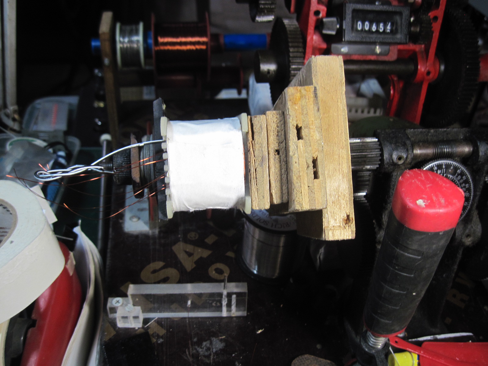

yes, that is my workhorse machine.....

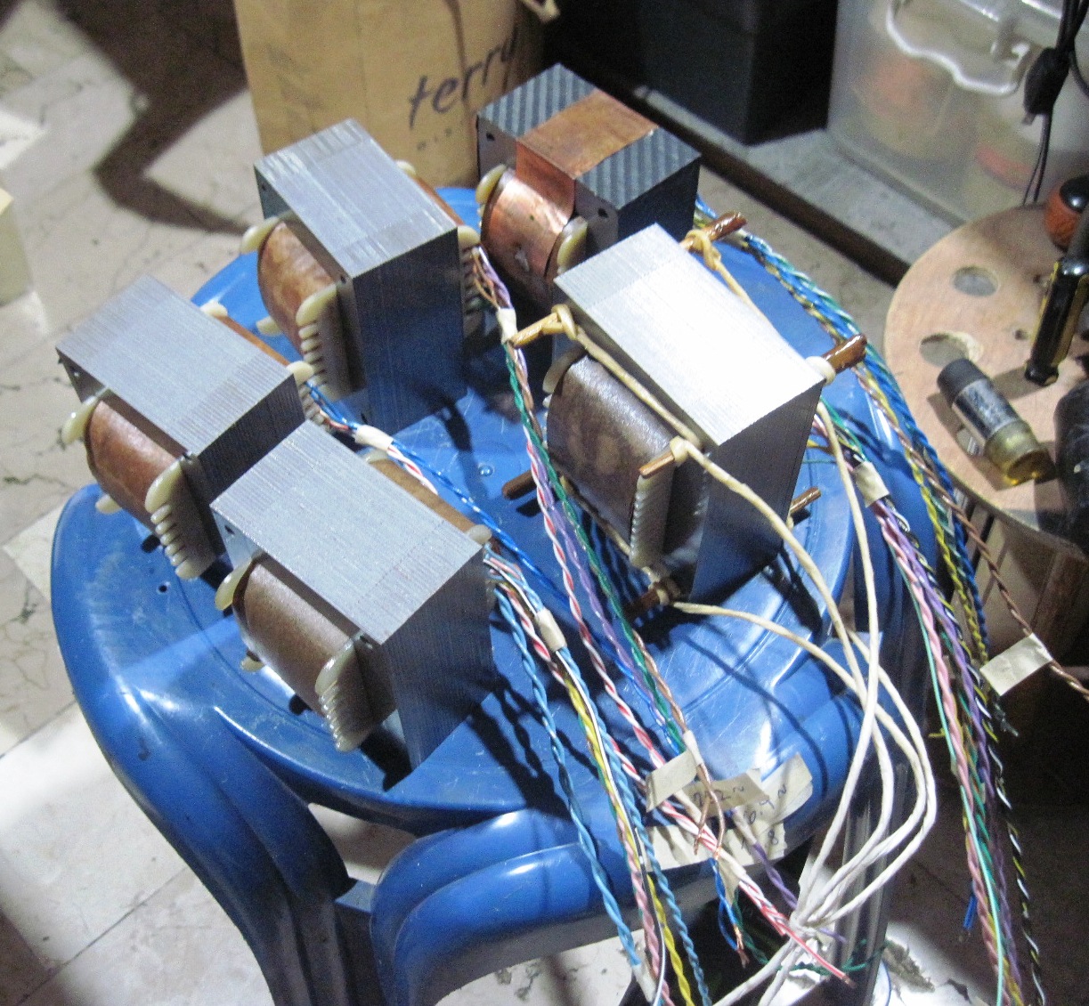

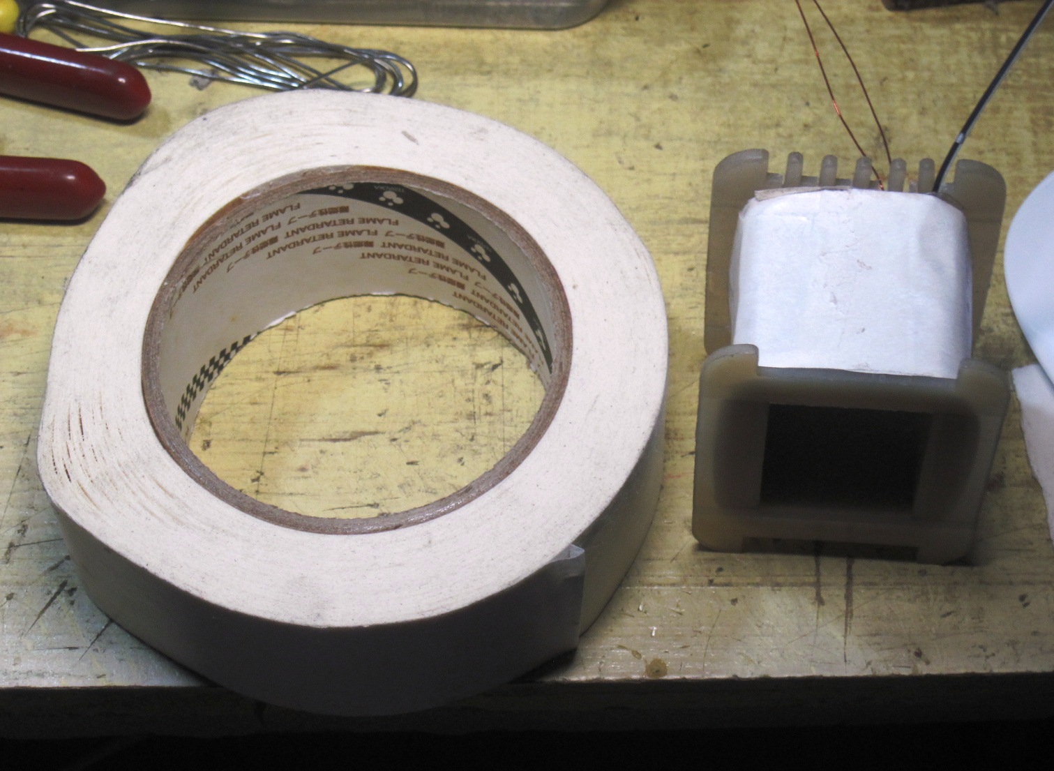

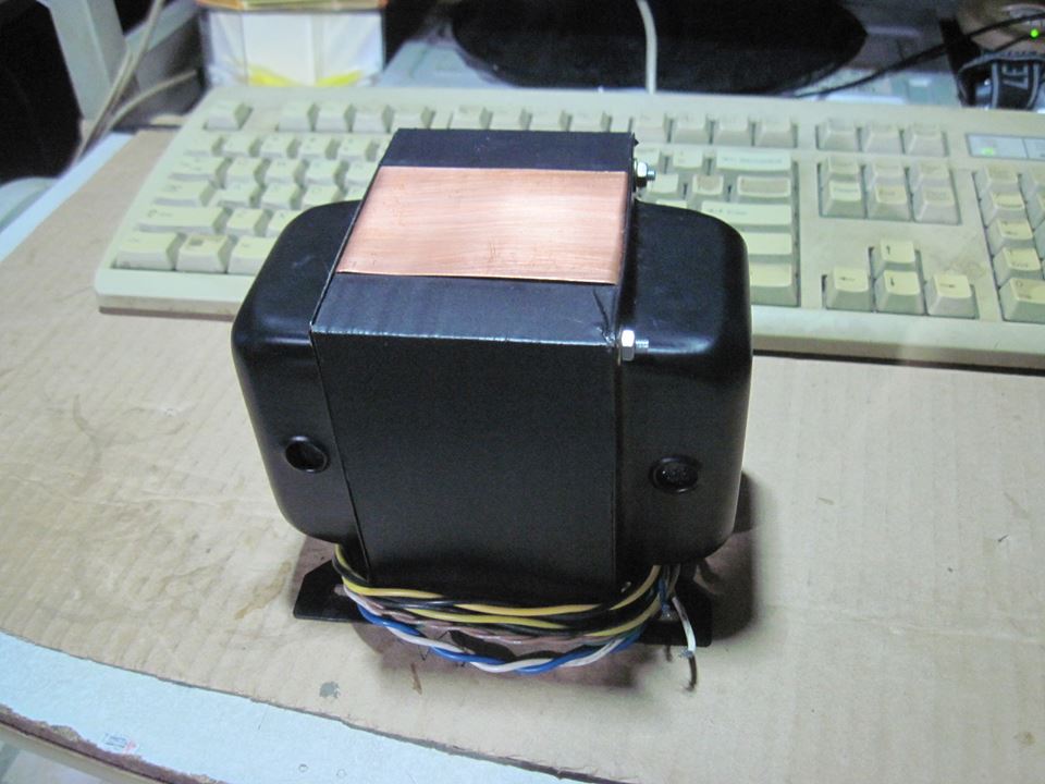

transformer for tube amp....Nomex paper tapes were used and copper strip eletctro static sheilds.....

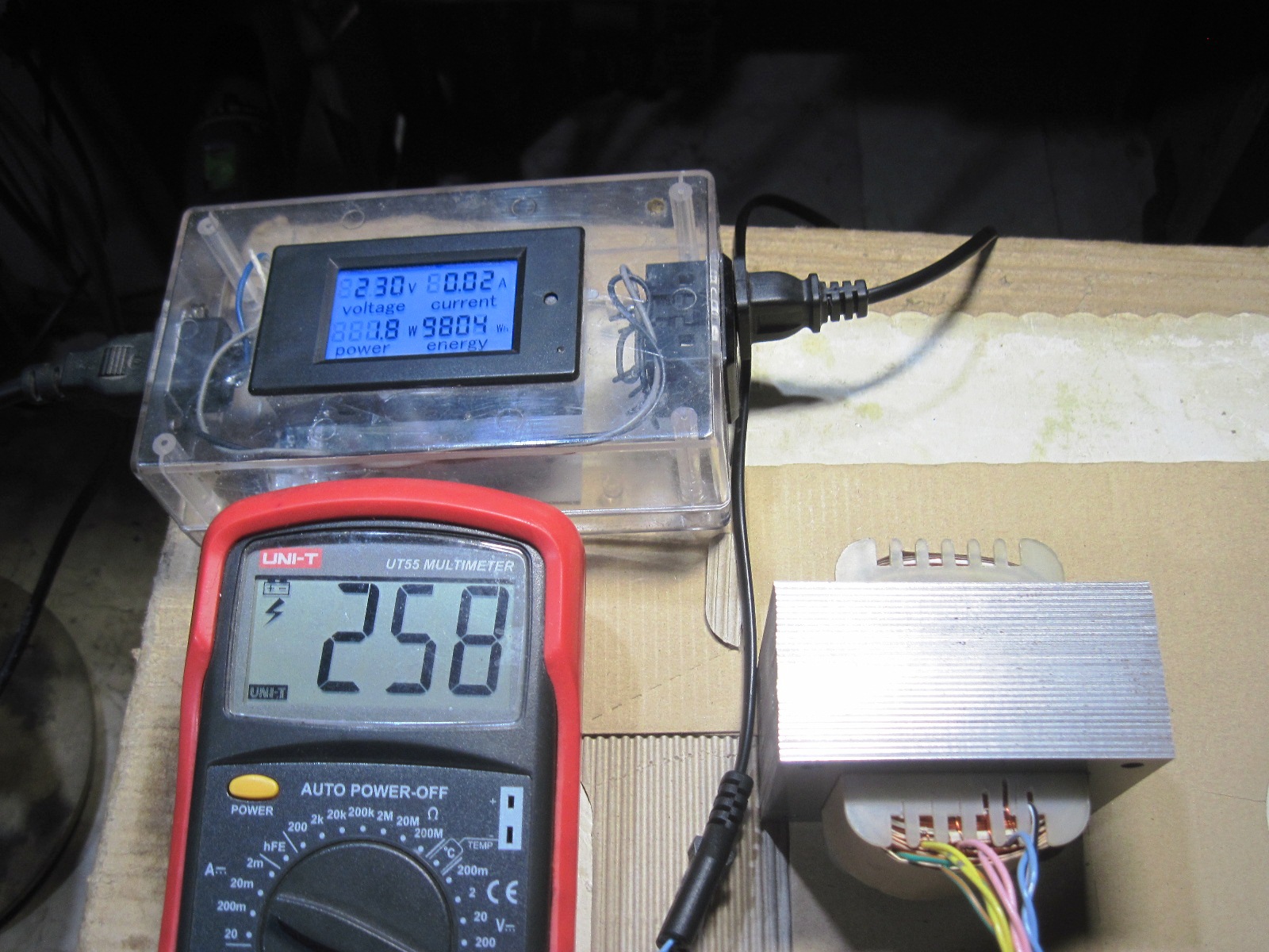

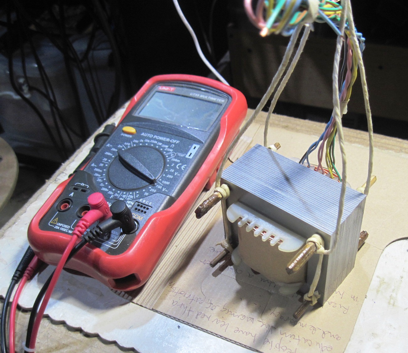

idle current is 0.02 mA and 1.8 watts idling loss using an H18 core, 0.35 mm thickness.....

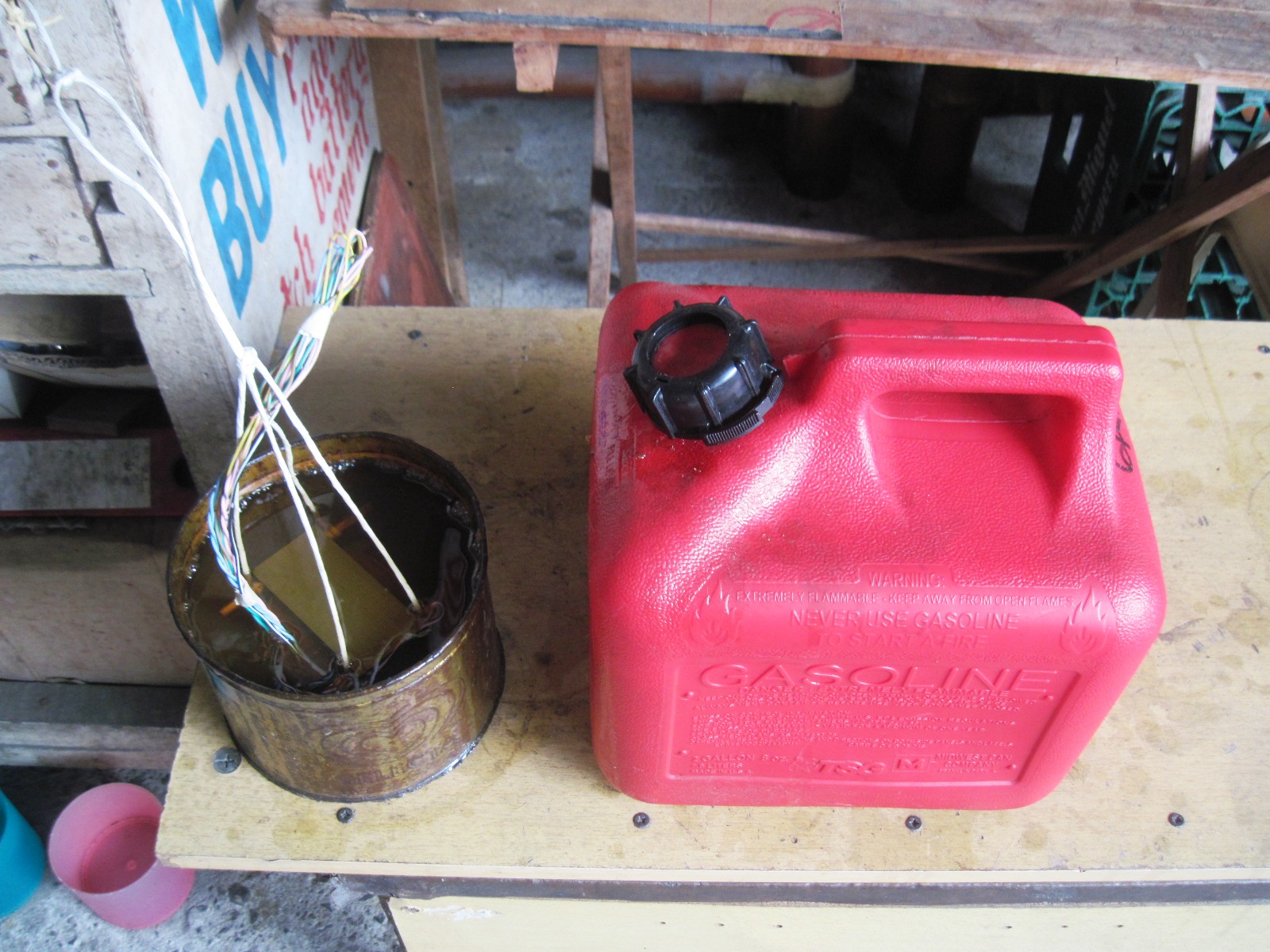

core is 1 1/8 inch center leg stacked to 40 mm..soaking fully submerged in varnish for 30 minutes and then hang out to dry...

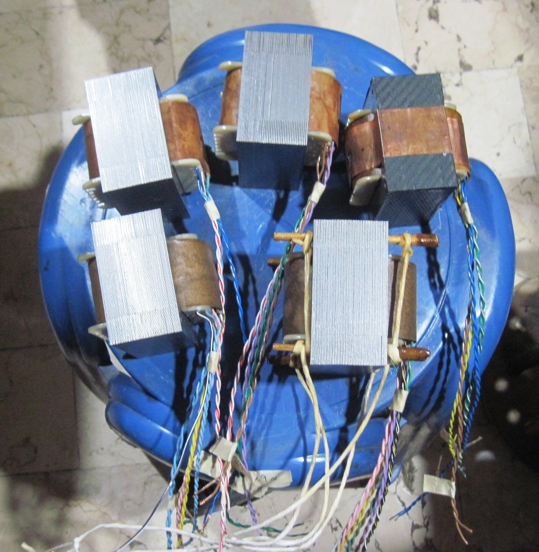

traffo for tube power amp using tv scanning pentodes.....6LQ6/6JE6....B+ pf 500 volts at 400 mA and grid bias supply of -100 volts available...core is 1 1/2 stacked to 60mm using golden mars surplus cores, idles at 4.8 watts and 40 mA...0.3 mm copper belly banding...

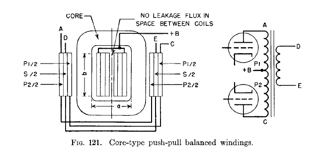

do you wind your output transformers strictly in accordance with Pat Turner's designs .. in terms of his secondary layers and how he sort of *breaks each layer up* into sections with different numbers of turns in each section and then joins turns in different secondary layers so he can get his 2/4/8/16 ohm windings etc ?
Or do you decide to provide a basic 4 or 8 ohm tapping and leave it at that ?
Some of his designs are quite complicated.
Reason I ask is I have downloaded a copy of Ruben Lee's book [1955 edition] and he has a drawing of a push pull transformer using a c-core on page 164 and it would be virtually impossible to apply pat turner's designs to such a core, he probably states somewhere anyway that his designs only apply to laminated cores.

i use a 4 section primary and 3 section secondary,
the total primary turns are broken into 4 equal coils,
section 1 and 4 are series connected, and sections 2 and 3 seriesed together.
the three secondary sections have 4, 8, and 16 ohms in single layers
i am quite happy with these arrangements...
stacking the cores, i divide the cores into three equal groups...
i use 0.35mm cores for OPT's...
i find this practice good enough for my taste,
i have no access to C cores yet so i can not comment...
BudP, YvesM, cerrem are members here who do OPT's,
Patrick Turner is one heck of an excellent practitioner, i learned a lot from these masters...
Patrick Turner welcomes emails...
i hate complicated designs and avoid them, simple is just as good...
but otoh, what seems to be complicated at first sight may not be that complicated at all once you get to build it....
we can give you all the details, but you still have to make one on your own, and that is where the magic is at.....trust me....

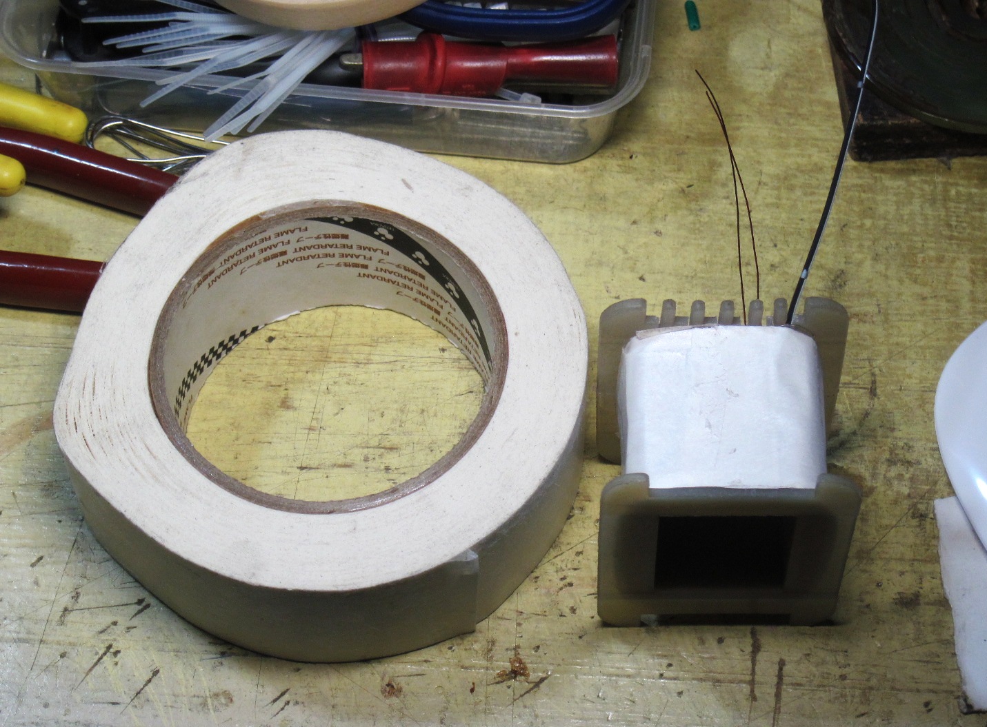

tony,
when you are taking your leads from inside the transformers is this the stuff you are
using or do you use the heatshrink plastic/pvc stuff ?
Polyurethan glass sleeve F class - GP 25 type
