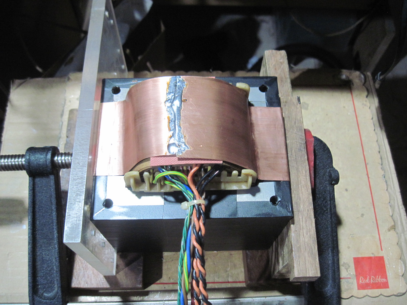

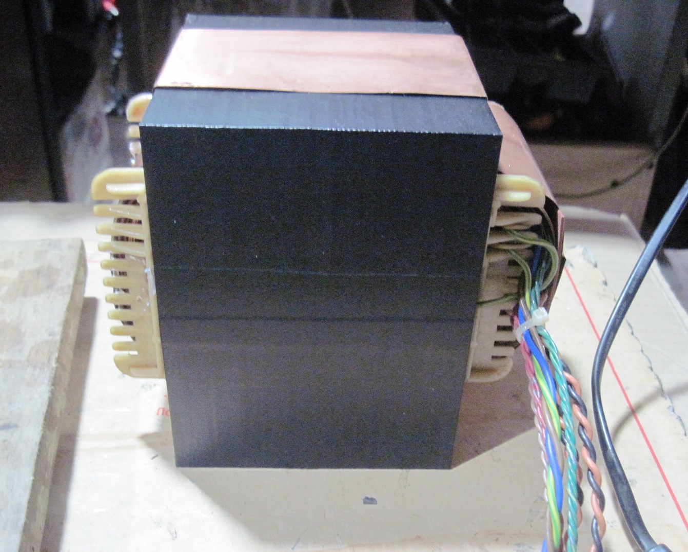

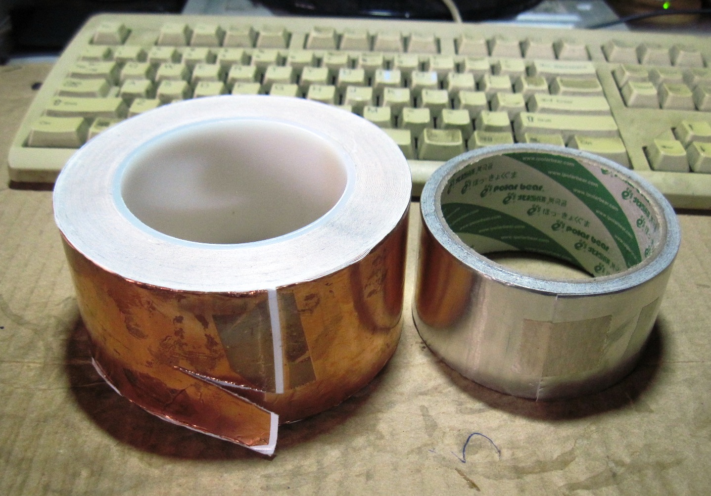

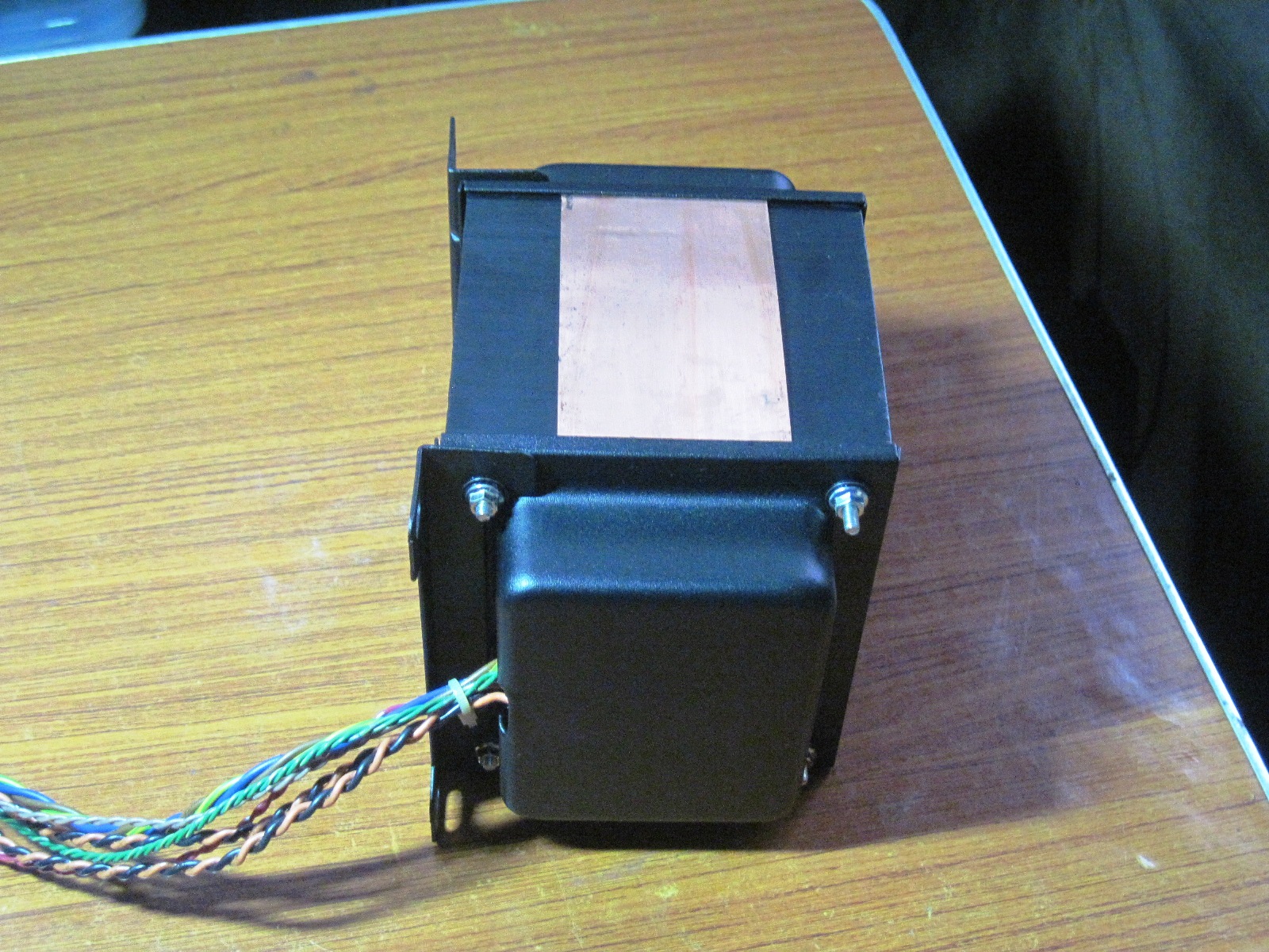

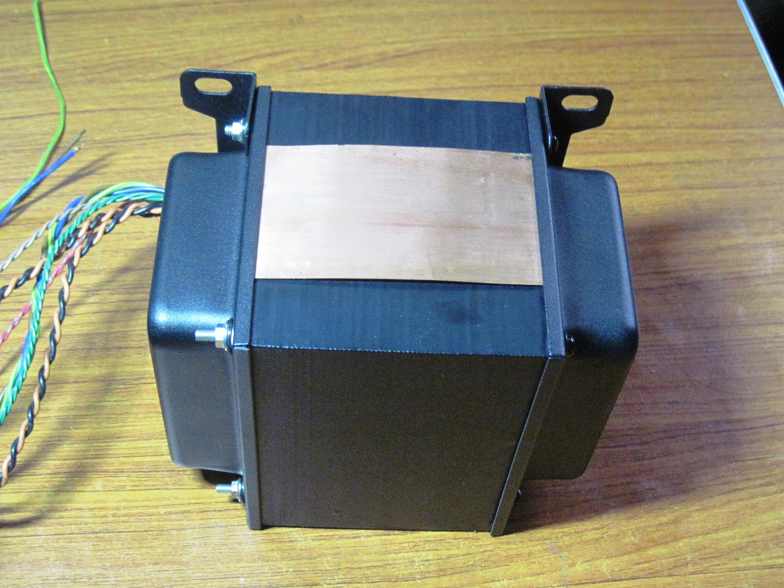

Tony's latest traffo DIY build
0.3 mm copper banding installation....

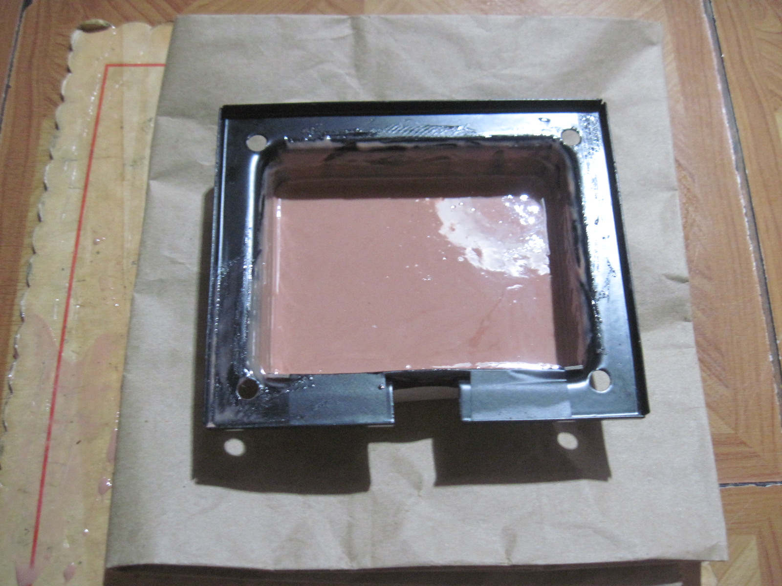

traffo is for a 4d32 pp amp i am building....1 3/4 inch center leg stacked to 4 inches...
end-bells tend to buzz so i added a 6 mm thick epoxy lining on the inside of end-bells....

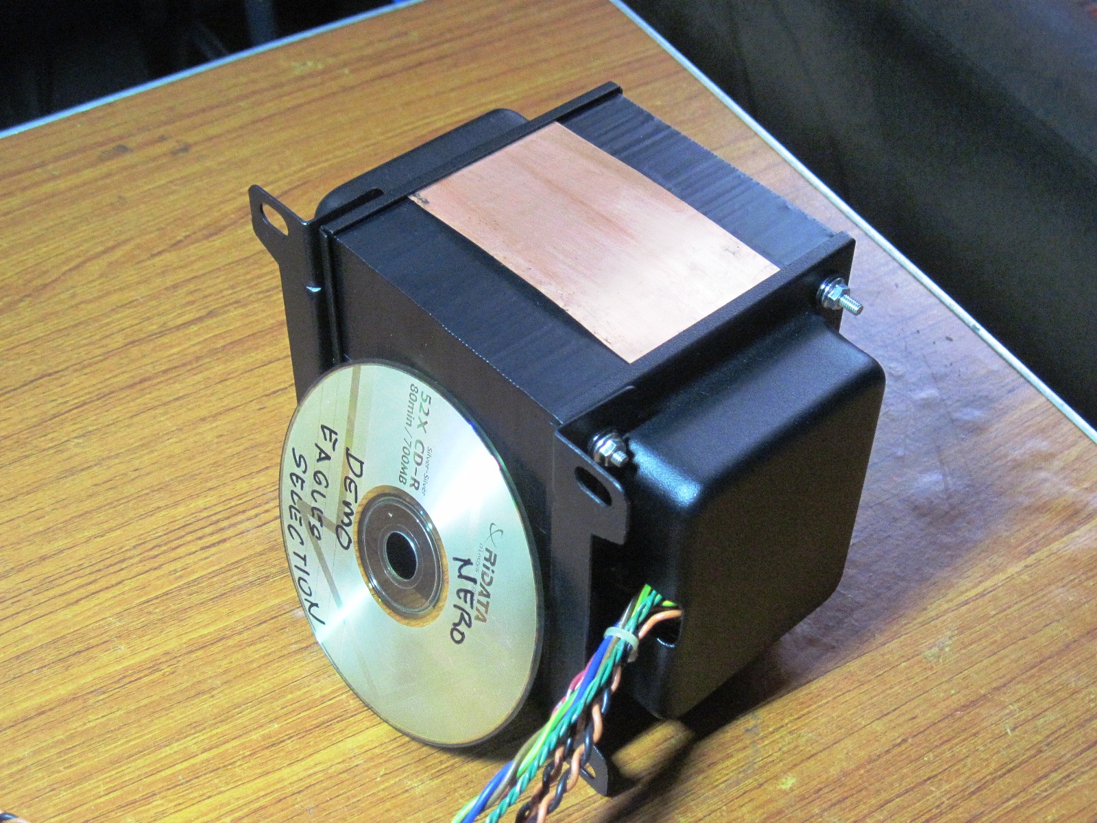

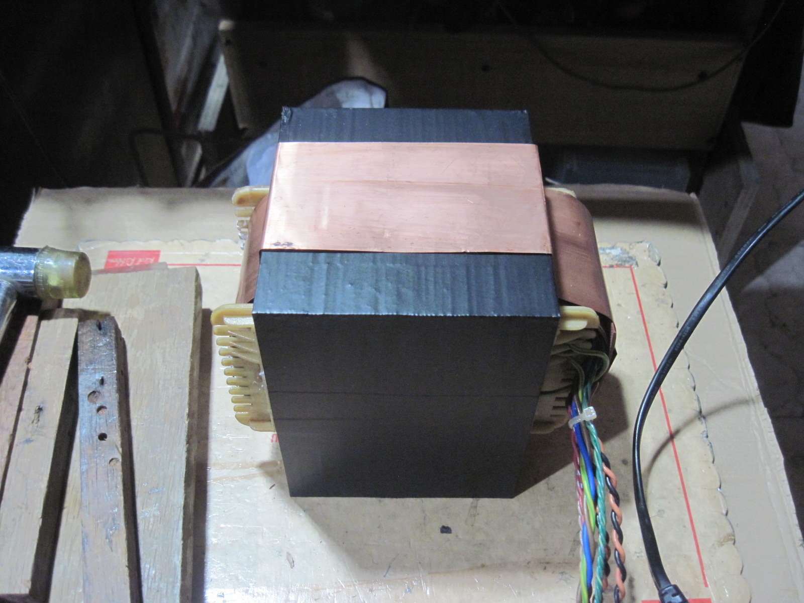

helps in stray field and noise reduction,
unfortunately i can not measure...
on many Japanese traffos that i rewinded,
they even put a metal band one or two laps
around the outside of the traffo core.....
i will do that one day....
i got all these ideas from tearing down many gears
coming out of America and Japan.....

.... are grounded secondaries used in SE transformers ?
"it works" ?
What does it achieve?
How do you know it works?
What if the belly band was 1mm thick and 1mm wider than the iron core window height?
Alternatively, what if it were 0.1mm thick and only 10mm wide?
Do both work as effectively, or does only one work? How do you know?
just DIY it and find out for yurself...
what i mean by "it works" is that the traffo operates
as it should, no smoke comes out....
sensible DIY means that building the traffo so that
there is no chance for any windings and pigtails
touching screens and belly bands, this is a no brainer...
hey this is my DIY, i am happy doing it and that is all that matters to me...
not for me to question what Amercan traffo makers found as good practice, i find it makes sense to me and i follow it..

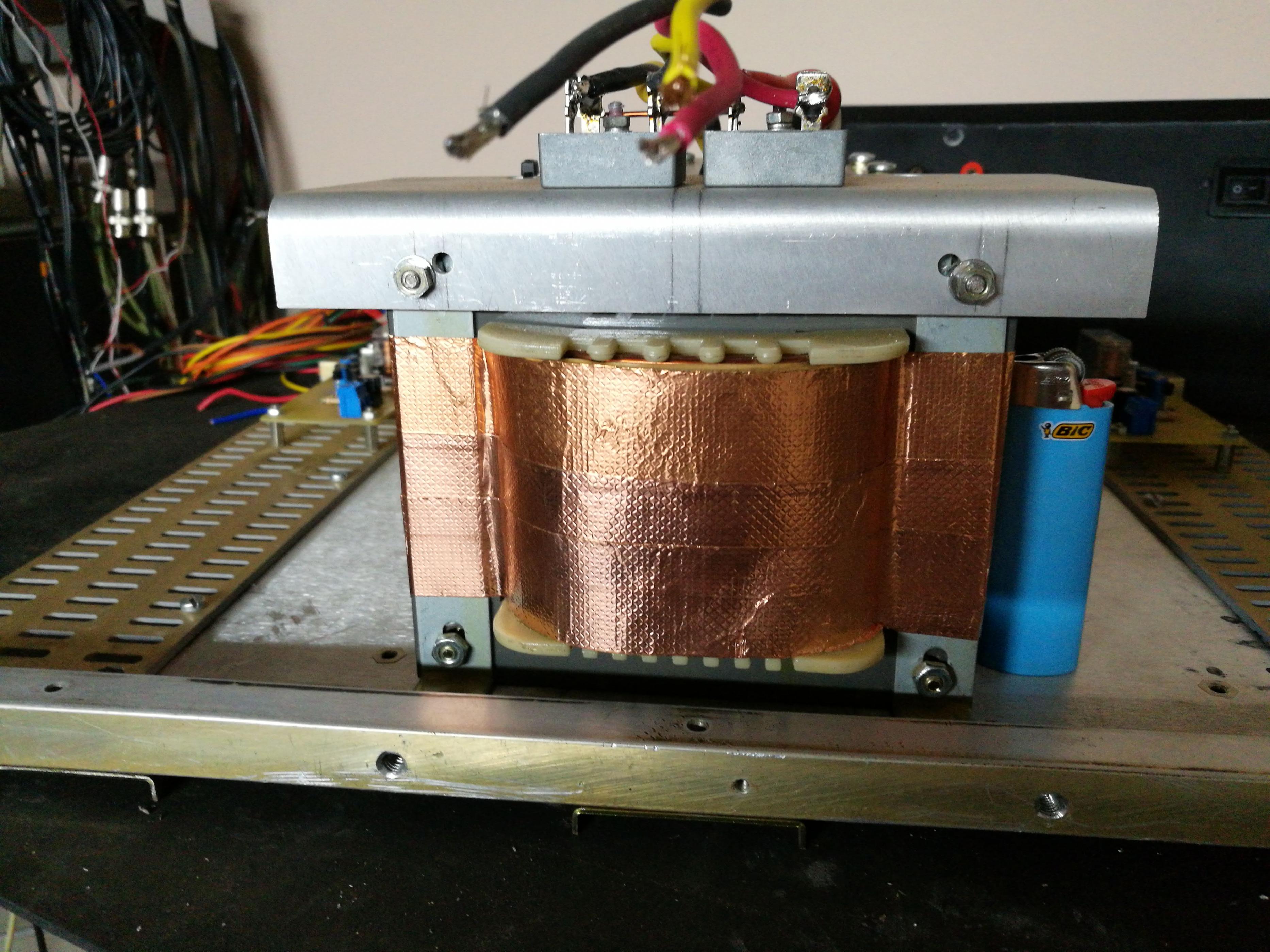

internal copper shields are electrostatic screens, and have the following constraints:
- must not create a shorted turn
- needs to have its ends insulated.
- must be connected to an appropriate AC return. A primary screen should be connected to either +Vdc_in or -Vdc_in (the input supply return). And a secondary screen should be connected to either Vout or 0V (its return)
[note my careful avoidance of the term "ground" - I use "protective Earth" when I mean exactly that]
- should have its connection in the center (lowest impedance from either end)
- must be very thin (to minimise eddy current losses)
- must have high resistivity (to minimise eddy current losses)
- needs a low inductance connection - the interconnect inductance controls the HF behaviour of the shield. this is true of all shields, be they internal electrostatic shields or external belly bands. long skinny wires pretty much ruin shields.
one cute trick for a foil winding is to add one extra turn after the DC end (usually 0V) as a shield with a free interconnect. its very easy to do, but may increase shield losses because the foil is invariably a lot thicker than a separate shield could be, and the shield connection is highly asymmetric. on the plus side its really, really easy to do.
A Gauss Band, or belly band, or flux shield has an entirely different set of constraints. Unlike an internal E-screen which is fully immersed in the transformer flux, a belly band is loosely coupled - its only the leakage flux that cuts it, and that ought to be fairly small.
so no matter how thick you make your belly band, you have almost no influence on the transformer operation at all (which is what we expect) - or to look at it another way, the eddy currents that leakage flux causes in a belly band are pretty much constant. its loosely coupled, so behaves like an independant current source.
So to minimise losses in belly band, you need to:
- form a closed loop
- use thick shield material
- use conductive sheet material (these two minimise I^2R by minimising R)
all three of which are the exact opposite of an internal electrostatic screen.
it also needs:
- to be insulated (thats an electrical safety thing, it wraps around the xfmr so gets close to pri and sec and core)
- to have a low inductance connection to a suitable AC return (I have used both -Vdc and 0V in different designs, for reasons of convenience)
a belly band can also be used to connect the core itself to some convenient AC return.
