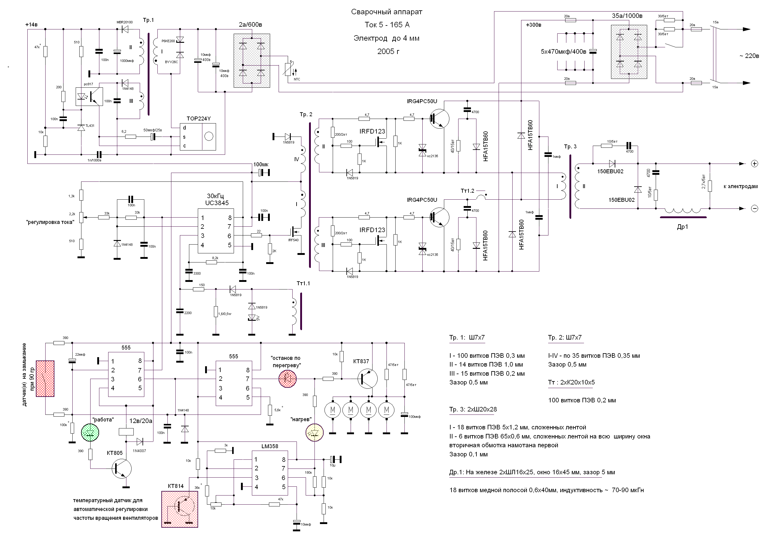

Can you post the dimenstions of the lamels of your trafo? I can try to make a normal trafo who has a triac/thyristor power arrangement what makes it possible to go from 0 to 140 amp.
The E71 core can put out a lot of power, it is the biggest I can get, I did indeed see a invetion where there a 5 stacked cores.
core 7 by 7 mm:
100 turns of .3mm
14 turns of 1mm
15 turns of .2mm
core three: two 20 by 28mm cores stacked, for a cross section of 20 by 52
18 turns of 5 times 1.2mm wire
6 turns of 65 times .6mm
that all sounds about right.
the output choke is two 16 by 25mm cores, or 16 by 45mm cores, with an air gap of 5mm. i can't make the turns out.
looks like the current transformer is 100:1 ratio, wound with .2mm wire. sounds about right as well.

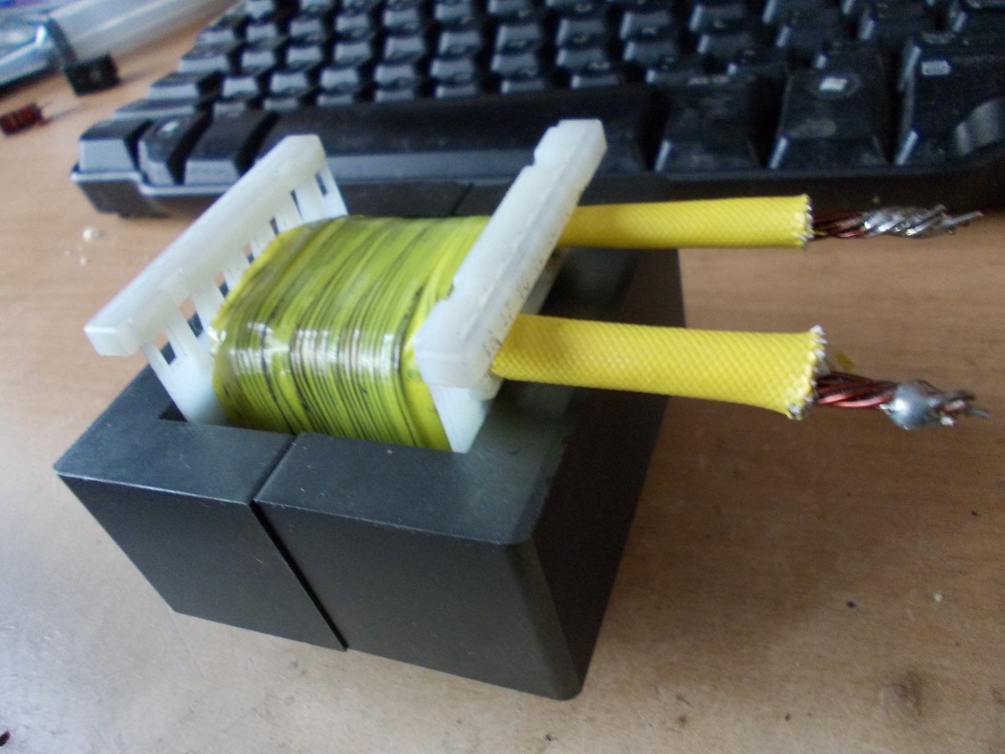

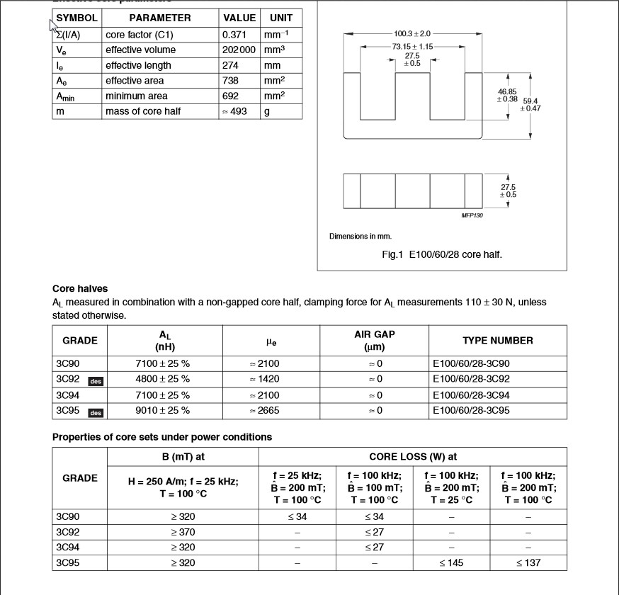

I have only two E71/33/32 cores who are some bigger, it is 3C90 material and al is 10800 without a gap, here she talk about a gap of 0.1 mm if I did see right.
the current transformer is indeed 100 windings and one winding of thick copper because it is in series with primairy.
Output choke is most of the time the same windings as the secondairy, read that somewhere.
Can I not use copper band for the secondairy? I did see that also a lot, I do not now how it behave what concern it,s skin effect.
I have a rectifier who is for a three fase welder (380), I ask this because I maybe go wind a normal transformer for it, with single fase but two windings output, I did sim it and it looks like that works, however I am not sure.
I go make the inverter but first I try a normal trafo with a thyristor current regulator to get started fast, I need to weld a car before winter.
You now everything about it I do see, and thanks again for your interesting help.
It wil be a big job to get this windings on that core, the 65 x 0.6 is normally litze wire, so I have to twist them, the primairy is more easy 5 wires in one go next to each other, I did one and has not enough space.

The cores are no problem, I think a 1000 watt pc supply core and some stacket will help.
but both are some to small.
here I have this core and is 71/33/32 who alone is already sufficient. These has primary 8 x 0.8 wire but secondairy did not fit because the bobbin was 1.2 mm wider then core.

try and wind it without a bobbin? carve up a wood block to wind the coils on, then wrap them in mylar and slide the finished coil off the block onto the core.
Can you be more specific about the mylar? how to use, between the windings or make a bobine with it.
Is it better and safer to use two 71/33/32 cores? stacked because welder builder use one.
what thickness do i need.

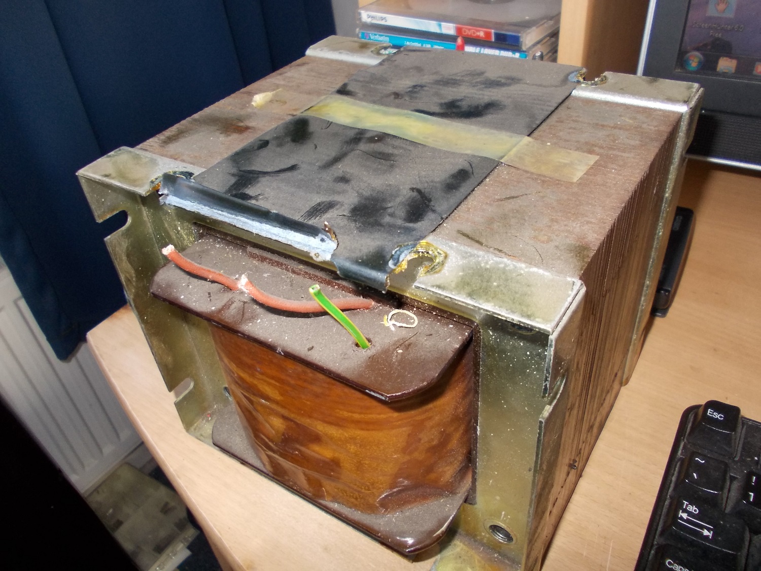

Hi
I have buy a old transformer for the build of that weld trafo, I put it tp 140 amp max with 22 volts, it has to be go dc so I use a rectifier and a big capacitor like I do see in the better welders, (why?).
dimension of the core middle leg is 10 x 6 cm, and the whole thing is 16.1 cm x 10.2 cm x 13.4 cm weighs 18 kilo.
This program I do use to get the windings however I do need 100 % duty cycle on max ampere, and I go make a secondairy SCR because this seems better.

he do use some smaller core then i have, maybe when I use two E71 20 wires 0.5 mm can be used in stead of 14.

the dimensions you gave for that 18 kilogram transformer don't check out right for a lossless cut.
can you give me the window area? (cross section available for the copper)
anyways, if its really that big, you should be able to wind something like 100 turns of 10 awg wire for a 240v 60hz primary, and 4x 10 awg wires in parallel for a 60 volt secondary.
you might split the secondary into two windings so you can have 8x 10 awg wires in parallel for a 30 volt winding.. or do a 40/80 volt winding.
