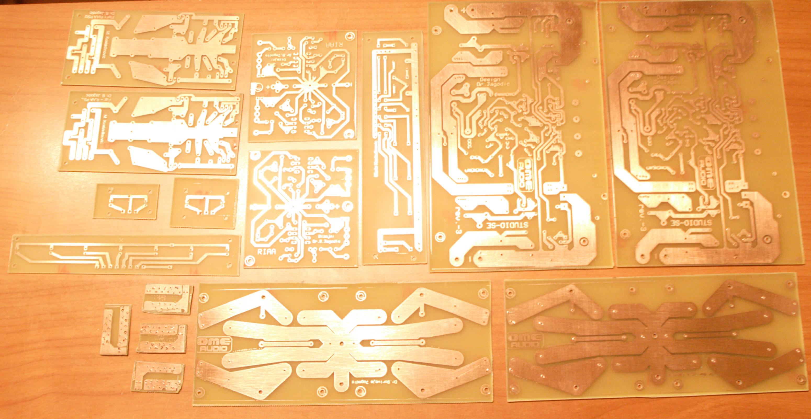

A PCB maden at home
This PCB it is 380 X 270mm (two pieces of 190 X 270mm in reality joined between them with gold plated pins). It is double sided and used wire jumpers to pass the tracks from the component side to the solder side. The PCBs are presensitized type (blue adheshive! it needs about 10 to 12 min of UV exposure for good developement) and the films used are ready printed Epson transparencies from my old Epson SC660 inkjet. You can see with your eyes the result. The beatiful green protective lacker it is Peters solderable.
Fotios
Fotios
