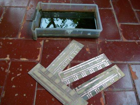

After a short (30+ years) break in PCB making...
As title says, the last PCB that I made was 30+ years ago and it was done using letraset (and marker). Now, thanks Dr. Bora Jagodic (boraomega) and Viktor Bradjan (viktor1986) for being patient with me, providing schematics and PCB layouts, as well as Sylvain Bergeron (algar_emi ) for support to make my own PCB from the scratch, here is what I done couple of days ago. These small buggers on the lower left side are made first (I guess that you can tell) so I am not that proud of them, but rest is not that bad.
To make them like that I used a photo exposure process. All layouts are printed (twice) on transparent sheet, using a laser printer. Photo sensitive boards are exposed for about 8 minutes under the UV light, then immersed in developer for 5-10 minutes to remove exposed parts and finally etched using Ferro chloride.
Before drilling I made a small guide hole (using several nails), then drill them using a Dremel drill with drill press and carbide drills. The small (0.8mm) drill broke after 20 holes but I wanted to see will broken one still work, and it did B-)
Am I happy with result, well, you should see the wrinkled smile on this old farts face B-))

Very nice!
For your drill press, you can probably stop breaking bits if you take a long spring and connect it on one side on the back part of the drill (on the part that doesn't move) and pull it around the front of the part (that does move up and down) and then connect it to the other side of the back part (that doesn't move). It should take most of the "play" out of the drill press itself. I used to break them at least every 200 holes or so. But now I can usually get about 2000 holes, before I accidentally break the bit by hitting it with something.
For etchant, you would probably MUCH prefer this type that you can make yourself, using "always available" chemicals, by adding one part hydrochloric acid (sold at hardware stores and at swimming pool chemical suppliers in the USA as Muriatic Acid) to two parts of the common 3% Hydrogen Peroxide, as sold at pharmacies et al.
Oh, also, just put the drill guide holes on your PCB artwork and etch them out. That works perfectly to guide the drill bit into them.
Have fun!
