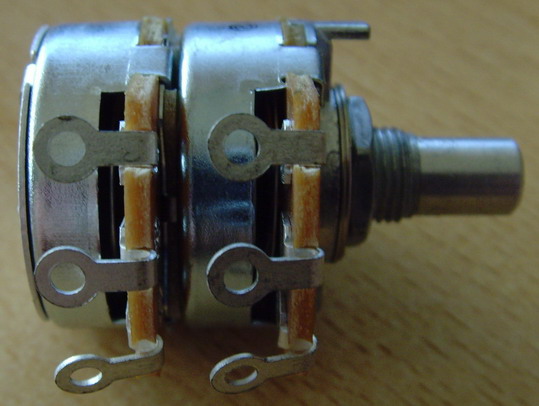

Rudi,
Should I decide to put a volume control on the amp, what value pot would be the best to use? And should be a log pot? I'm not inclined at this point, but I may want to do it down the road. BTW, I configured the front-end (gain) for use with an active pre that I have too, but I would not use it and a pot together.
Thx,
Rick
Rick, you can of course feed the power for both channels with the same single transformer secondaries.
Move your transformer as close as possible to the front of your case (as far as possible away from the SYMASYM frontends).
I do definitely not hear any hum from a build like this.
Use a dual log 20K potentiometer for the attenuation.
I have used in the past and have always been content with ALPHA-brand potentiometers. ALPS potentiometers will do it as well.
Best regards - Rudi

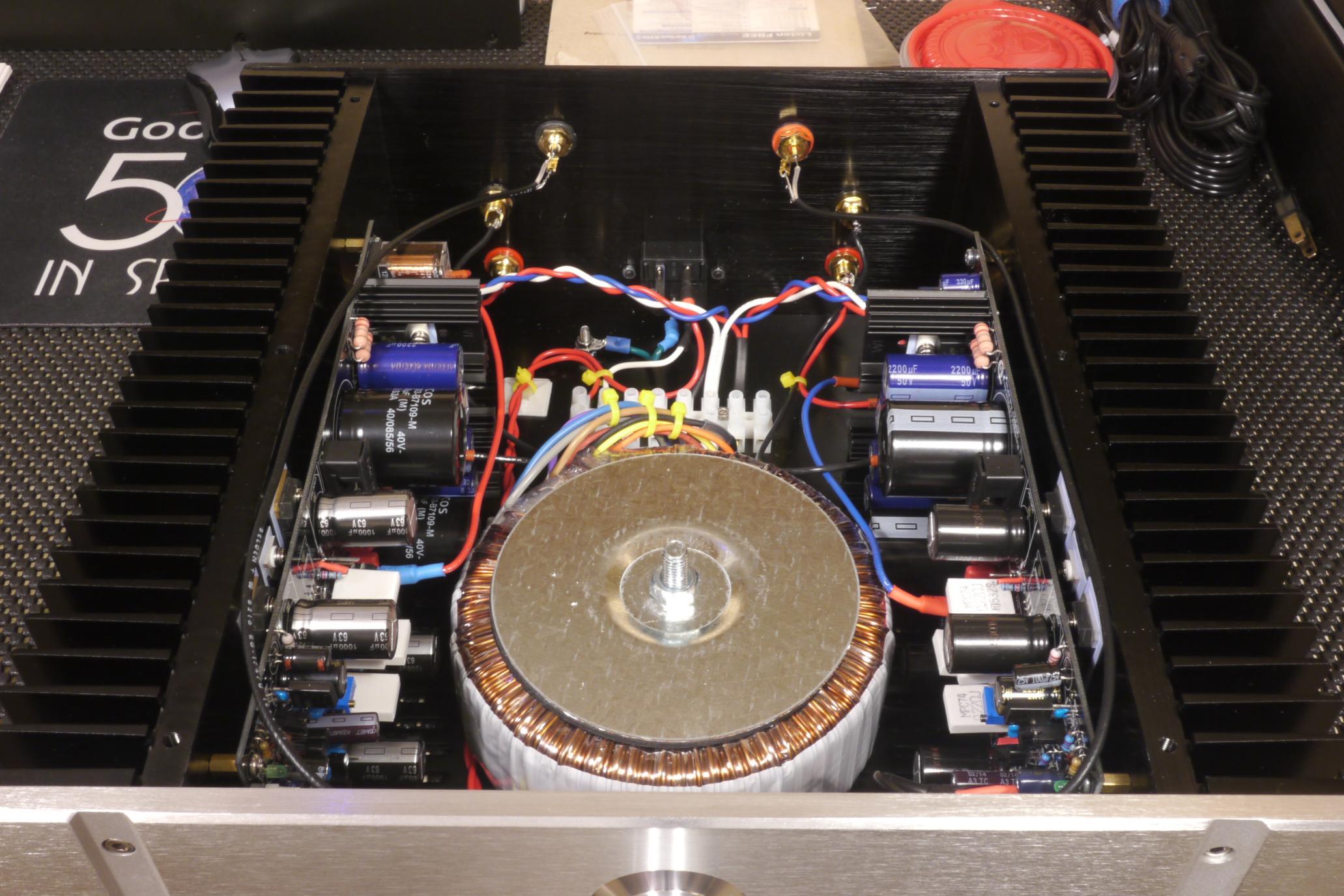

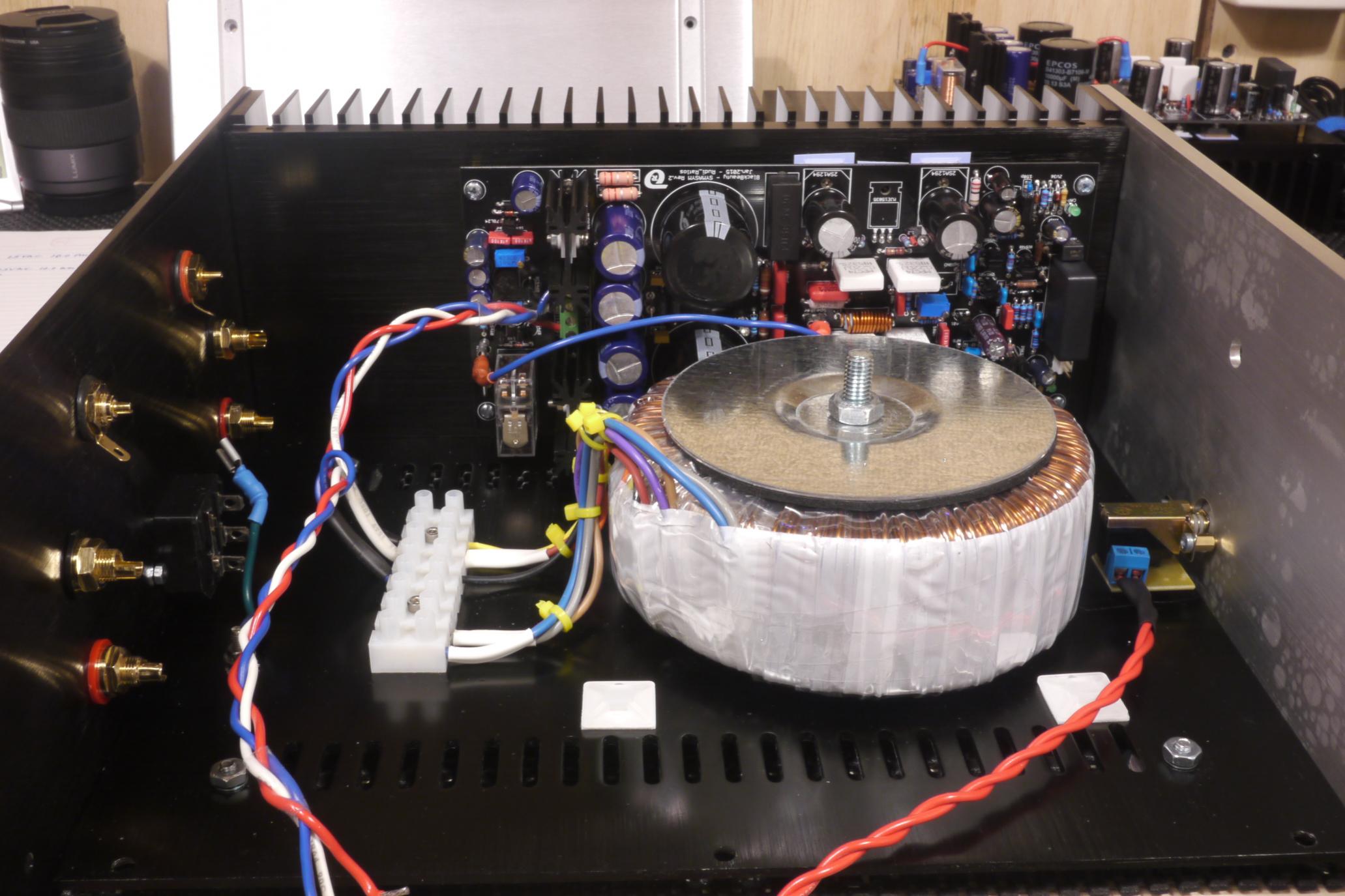

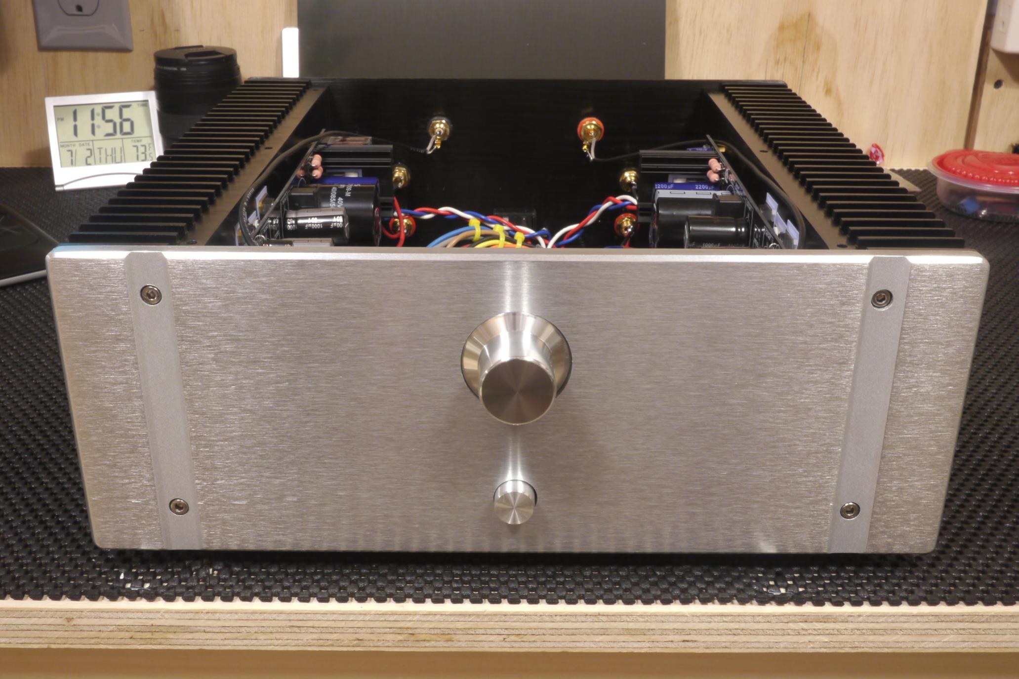

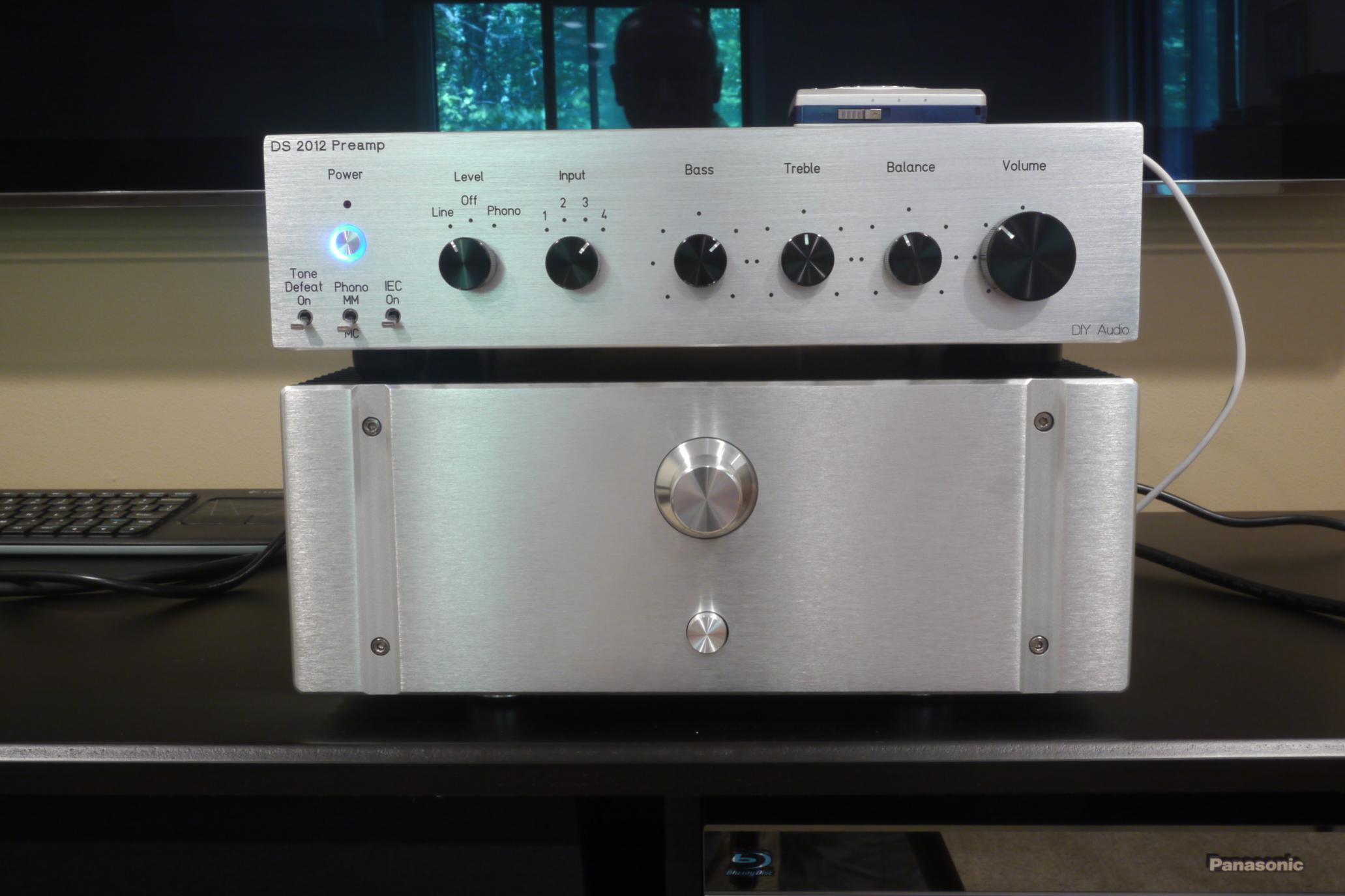

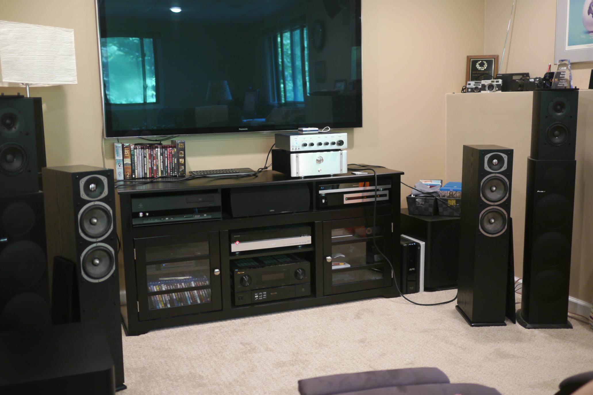

It is finished!
I finished up the internal wiring yesterday and managed to get everything in the enclosure. I'm listening to it now as I write this, and the amp sounds pretty amazing - at least with my modest Energy RC speakers. I'll give it a critical listening test later once I let it break-in a bit. At moderate volume the heatsinks are barely warm. I can't hear any hum whatsoever.
Included a few more pics of the build and internal layout of the enclosure. The last couple pics show it with my Doug Self pre-amp I built a couple of years ago. I configured the front-end of the SymAsym to be used with an active pre so I thought the DS pre would fit the bill nicely. At the moment they seem to go together well. :) BTW, the volume control is not connected, just covering up a machined hole on the front panel. :D
Since the PSUs are part of the amp boards, I've kept the signal ground in the domain. Meaning I carried both the input signal and output grounds from RCA to speaker binding posts. Normally, I would tie the input ground and speaker returns to a common or star ground. Essentially I believe I have a floating ground scheme as it is now. The enclosure is earthed at the receptacle, but internal grounds are all floating. I believe I need to tie everything to the case at some point. Yes?
Thanks Rudi for a great project and a wonderful sounding amp - and having the patience during my senior moments. It takes me awhile, but I'm always proud of my results - especially when no magic smoke is released. :) Also, I'm sure someone will point out that I missed twisting the wires from my tranny. I know, but decided I didn't want to re-work them for such short distance. :) For those interested, the enclosure I used is this one.
Rick

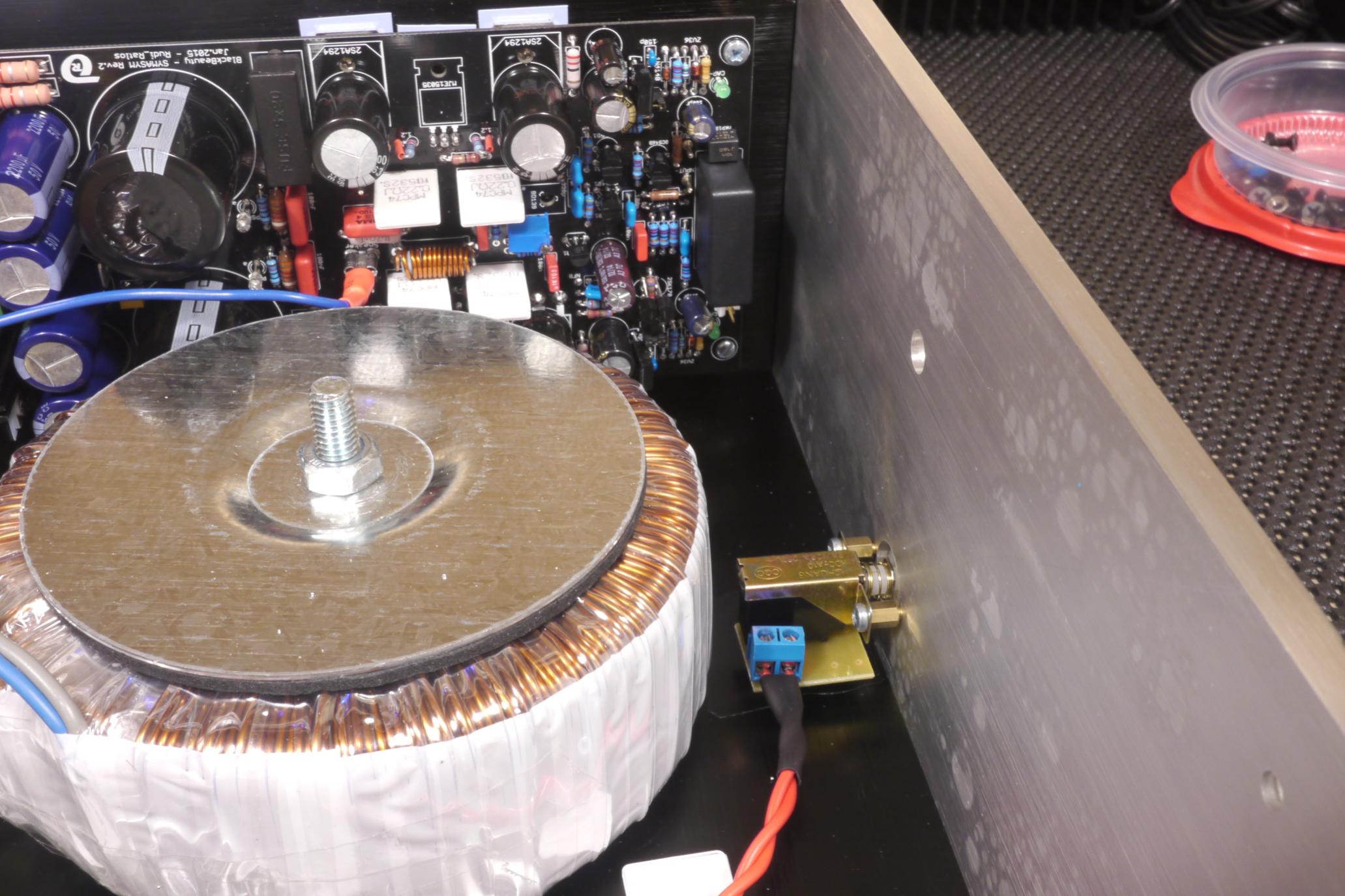

I noticed over the weekend when I still had the top off that the tranny I'm using has a slight, but noticeable hum to it. It's not a ground loop hum from the speakers, but the tranny itself is humming. For this build I choose a different manufacturer (AVEL-Lindberg) for the tranny. I noticed that it did not have a shield lead that I usually ground on other trannies I have used in the past.
As I also mentioned in the post above the amp is not earthed and probably should be, so when I do that, it may help the hum issue. Will give it a try.
Rick

Rick, you have built a beautiful piece of work! Looking alone at the RCA-input cables ... ! I appreciate your passion!
I have been using "inexpensive" toroid-transformers (brand: TALEMA) for my builds in the past and have never experienced any transformer-hum!
As Paul stated: maybe you have some DC-offset on any of the outputs (please mesaure DC between GND and output on both channels - short the input during this measurement, please) or:
may it be that your way of using one transformer to drive the backend-PSUs of both channels induces the hum? I don't know!
My current build uses a 4x25VAC toroid, whereas in the past I used a 2x25VAC toroid and 1 (!) PSU-PCB to drive both channels.
I am not an advocate of the "Star-Ground" topology and have never before used it in my builds (I hardly dare to say this).
Connecting ProtectiveEarth of the mains' inlet to the case is the only thing that I do.
I hope (keep my fingers crossed) that you will find the reason of your hum.
Your SYMASYM is worth playing without any hum!

Rudi, Thanks for your kind words. I think at times I'm meticulous to a fault! Always trying to think ahead for any pitfalls I might run into. That generally slows the process down when I'm always in planning mode. As it turned out, the enclosure was just a bit too tight for my liking and I had no other choice but to have the tranny right up against the components on the PCBs. I hope that's not the source of the hum. I usually use toroidal trannies from a local supplier (AnTek) in my neighboring state New Jersey, but this particular size/rating was not available at the time, so it was sourced elsewhere.
Speaking of hum... The hum is ever so slight and with the top on and from my listening position you would never hear it. I just don't know if it's leaking into the signal path per se. I hear absolutely no hum from the speakers.
This was a fun project and helped boost my confidence level with building discrete amp PCBs. I now feel I could tackle any 'difficulty' level of amp. My real forte' however is being the integrator - bringing everything together in a professional way into a nice enclosure with the finishing touches.
Thanks again for the project.
Rick
