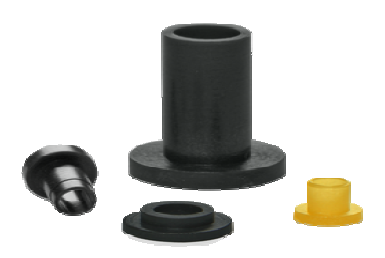

As I wrote on page 35 of my "Builder's Manual": move a MICA washer or silicone thermal conductive foil between the transistors' backs and the ALU-L profile.
Insulate the srews by means of "shoulder washers (? - see attached image) or polyamide screws and verify after soldering that all of the legs of all transistors
have infinite resistance to the ALU profile.
I hope that the BD139 was the only part that you fried.
I wish you good luck - Rudi_Ratlos

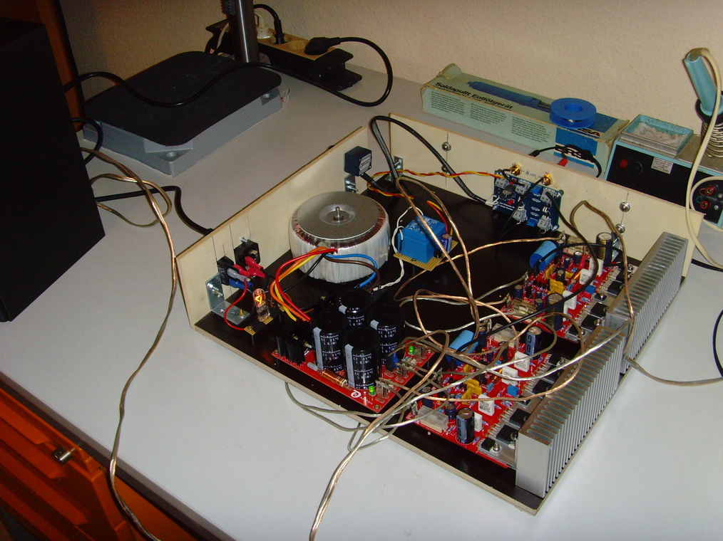

I finished the SYMASYM for my brother yesterday night.
It is playing beautifully.
