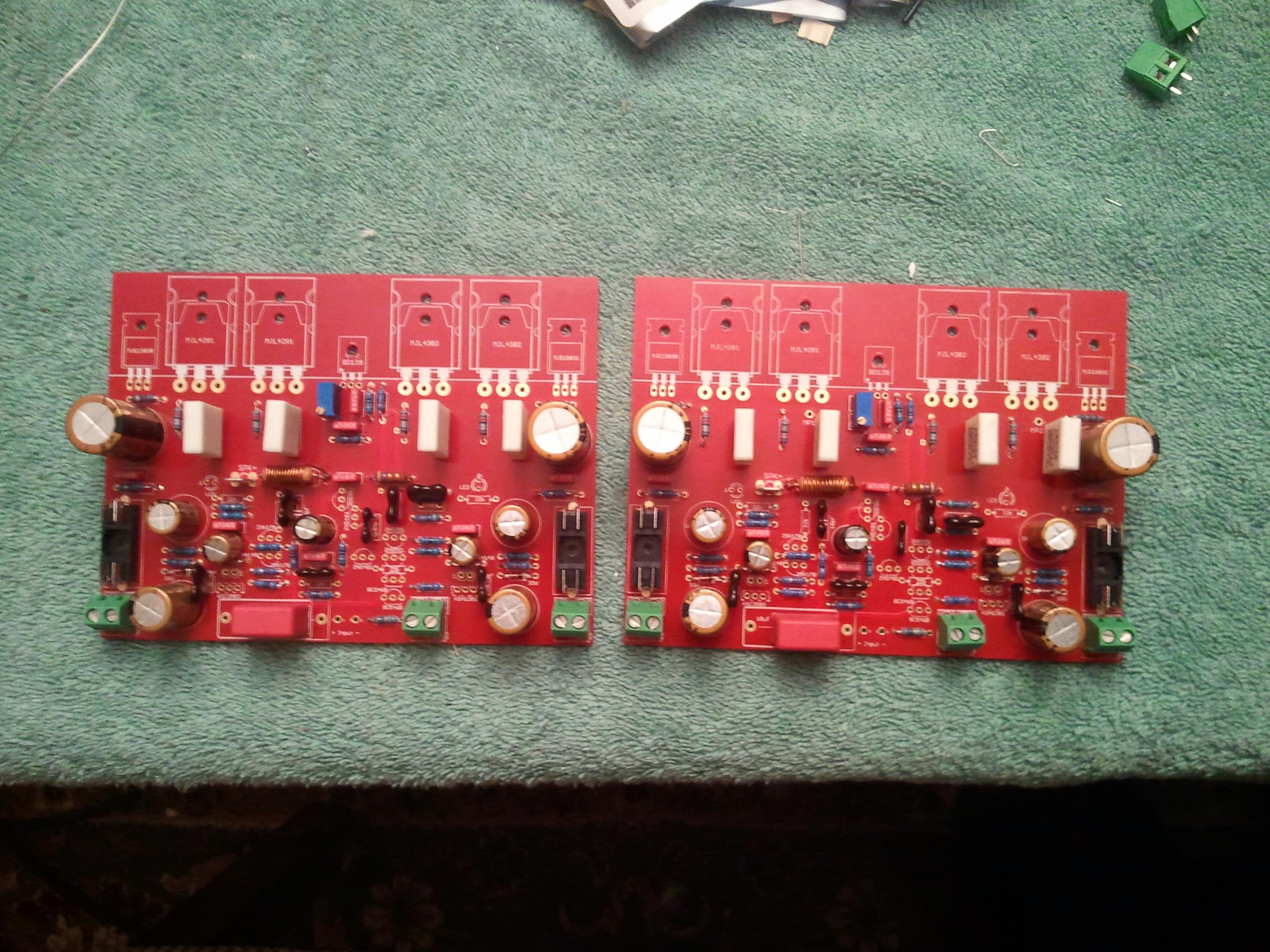

Carl, what is up? I did not hear from you for quite a lot time.
Did you receive the PCBs?

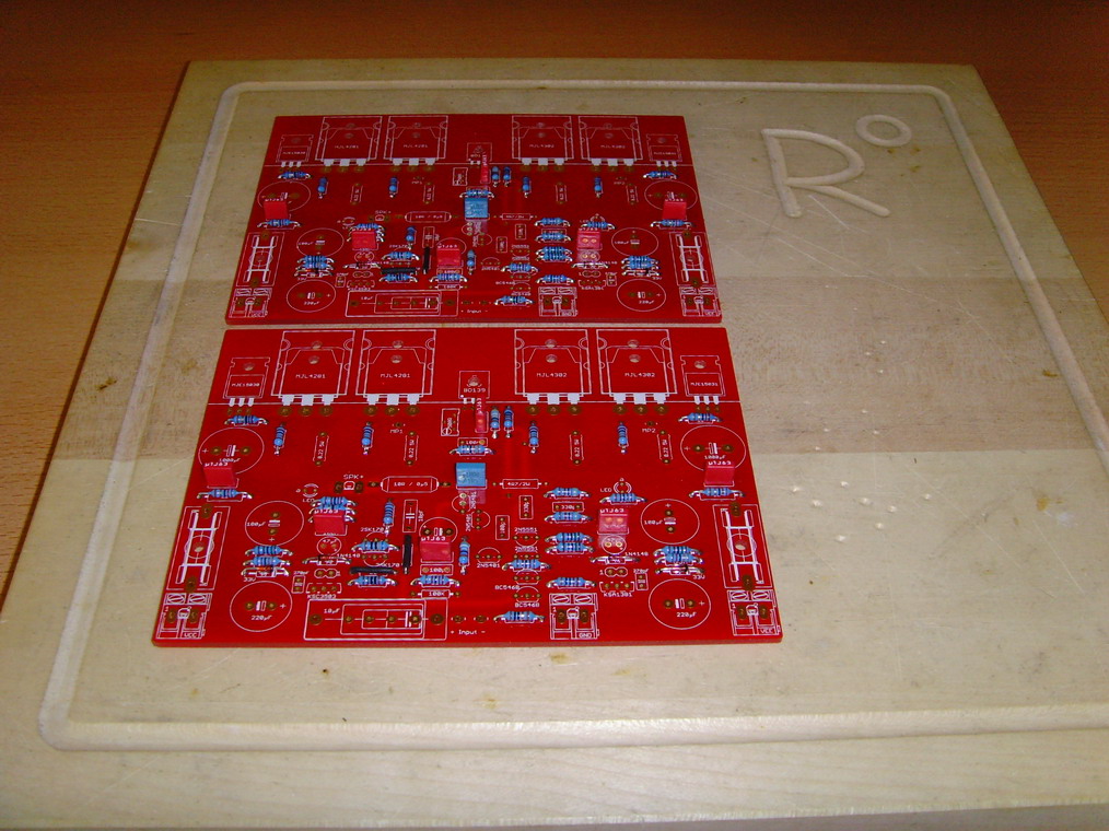

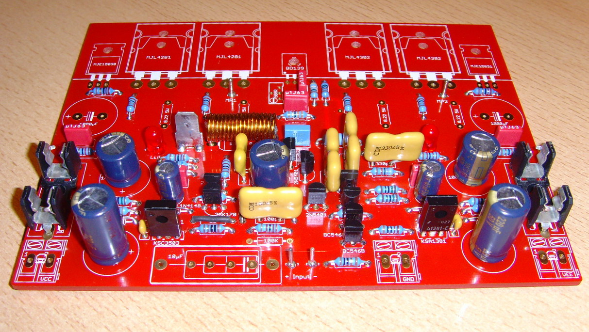

I have finished the "1st floor" (small resistors, diodes and capacitors) this morning.
Best regards - Rudi_Ratlos

Carl, please check the polarity of C4 / 470µF / 16V.
I will have a closer look at it later on.
The MICA capacitors that your ordered, are very good!
I ordered the wrong ones, :mad: ,with a much too wide grid and too thick legs, and I spoiled the nail-file of my spouse. O dear!
Carl: you do not have to do a new DIGIKEY-order for the 22K resistors!
They are just to delimit the current flowing through the LEDs!
Take a 10K, 6K8, 4K7, ..., use Ohm's law: 35V rail-voltage - 2V forward drop across the LED - divided by some mA - giving the value of the resistor.
