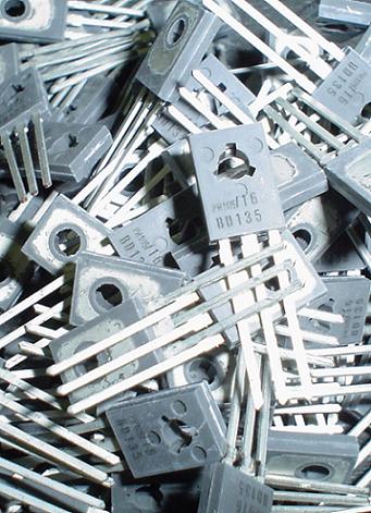

jacco vermeulen said:Aaah, groupy bye bye, just as i thought "wtf should i do with this sht".
Those look sheeety Jacco!
Looks like real drekkk (may I have some ? )
manu
Manu said:
Looks like real drekkk )
manu
Yeah, too few legs, and not hollow. Must be real drekkk
