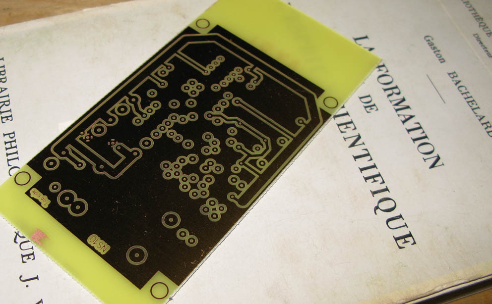

In the meantime I also drekked NS10 pcbs ...
Looks neat ...
If I could find a victim to drill the holes ...
Looks neat ...
Tony : as the boards are already very small I have no problem with 10 mm more in the width ...
Manolo
That is a good etch. Good work.

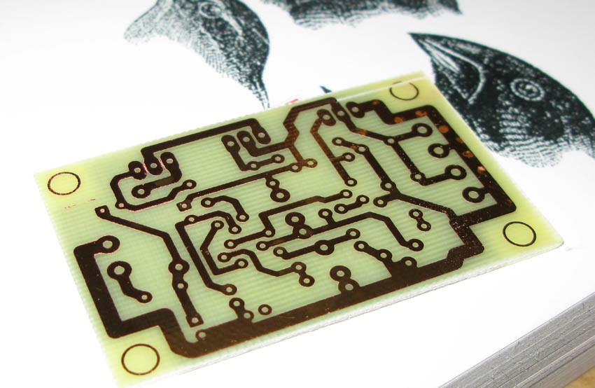

Babowana said:Thanks Manu,
Getting better day by day.
Now, that is good news

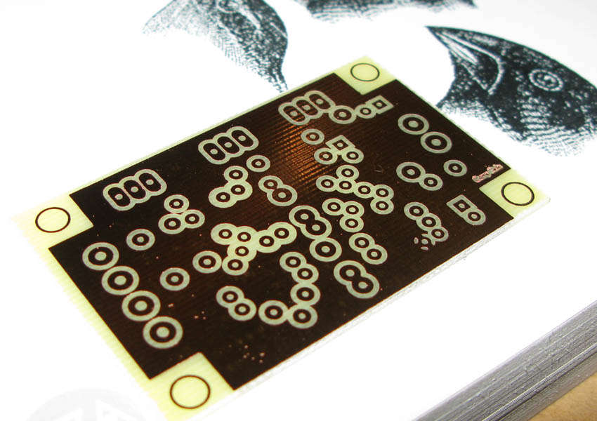

twitchie said:Any chance we could get bottom layer pdf to etch?
Can we use any 12V zener for Z?
Are you referring to the NS10 or the Tooleregs?
Yes, on the regs you may use any 12V zener, the small 1/2W may be better thou.
