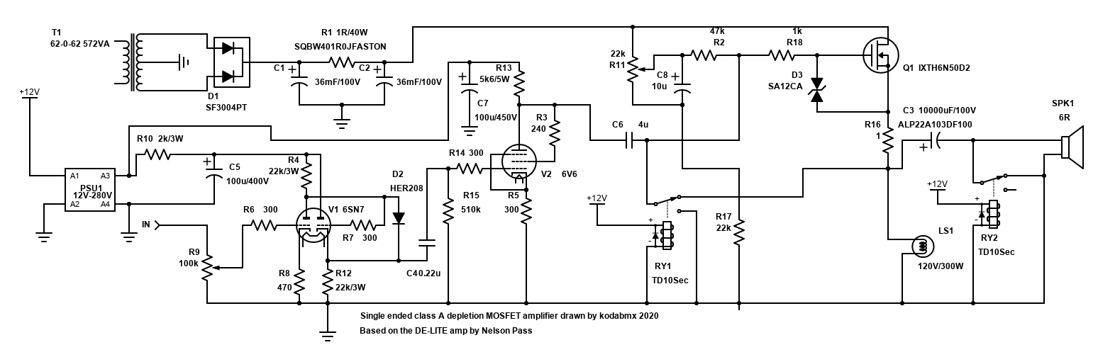

Fair enough, but it really doesn't matter... In the following circuit, the 6V6 doesn't GAF if that TVS is there or not... Without that SA12CA, the MOSFET quickly turns into a wire (especially without RY1!). A lot of MOSFETs have a protection diode built in anyway...
RY1 is drawn incorrectly. It shorts the MOSFET G-S for 10 seconds, then opens. There's no connection to ground.

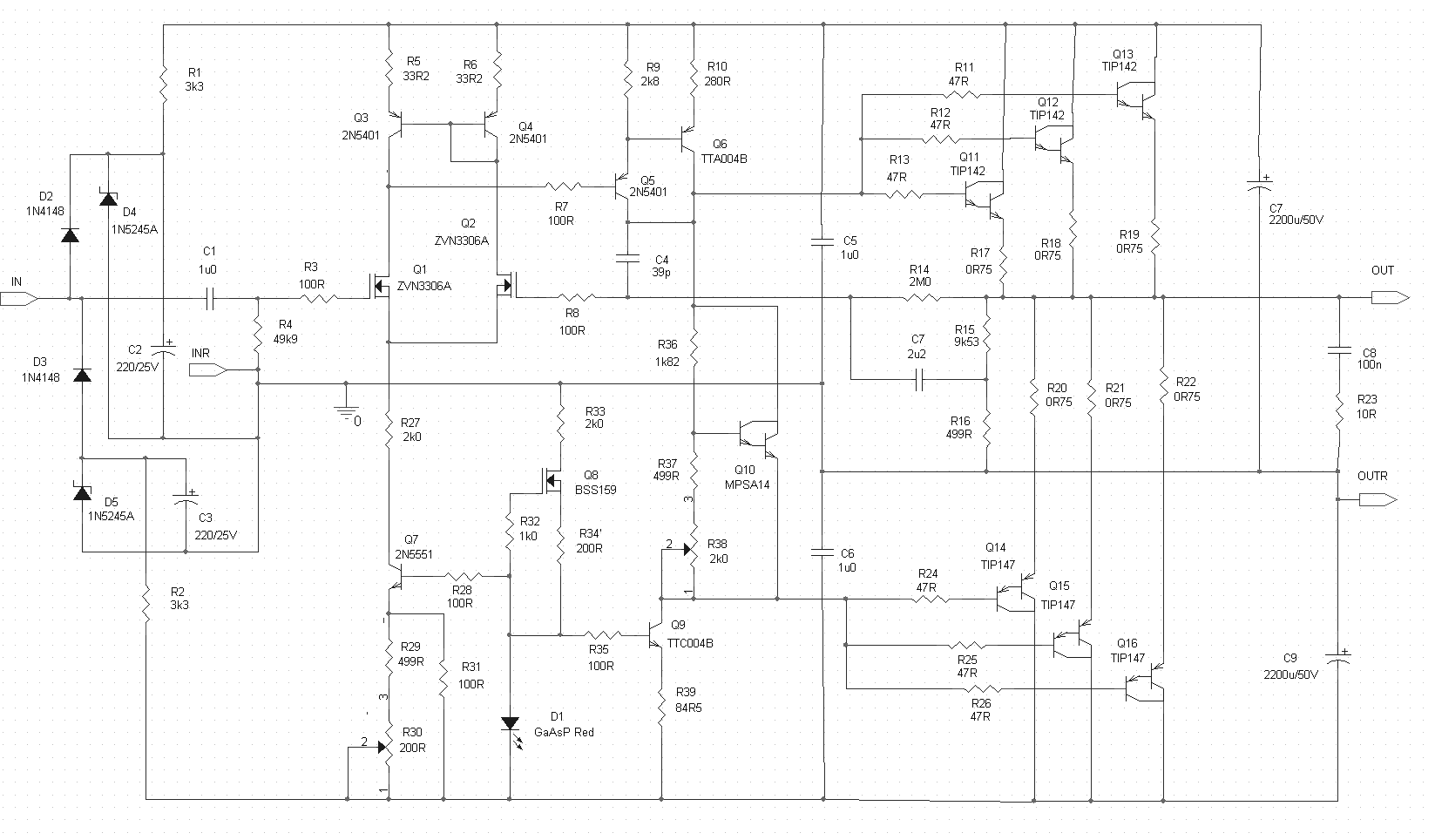

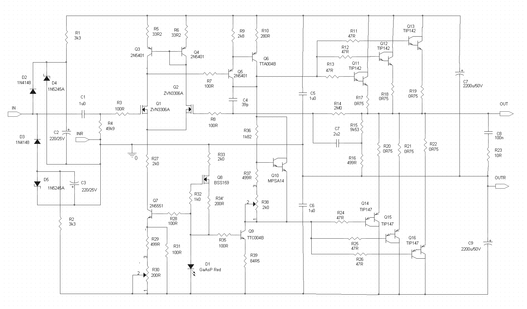

Can you tell us more?My only beef with the gate protection is that the fet inputs will see all of the capacitance of the TVS diodes, since they are essentially being operated at 0V. I have a scheme that biases up the protection zeners to reduce the capacitance they present to the diff amp gates, and keep them out of the way until they actually encounter an ESD event..
Here's a sample circuit using an n-channel enhancement mode differential front end. The diodes connected to the input are already low capacitance in nature, but still more so, as they are reverse biased by about 15V. The capacitor and zener backing the diodes help absorb ESD energy. So, it's definitely more parts than a pair of zeners/TVS, but a lower and more controlled capacitance directly connected to the input. If you're feeling a mite paranoid, you can use larger diodes at the input instead of the 1N4148. The larger diodes will still have reduced capacitance due to the reverse bias.

I don't understand why my post illustrating an alternate clamp circuit for a mosfet front end was deleted, as it was in response to a poster that was using back-to back zener clamps for a mosfet diff stage feeding a tube output. Yes, it was an SS amp but it was illustrating an alternate clamp circuit for a mosfet differential front end.

Sorry you feel that way... I thought it was relevant to the thread. We were talking about MOSFETs and how some people think strapping a TVS diode across gate and source destroys the circuit or something...

I don't like putting a nonlinear junction capacitance across the inputs of my projects. Tubes are nicer that way, as the capacitance comes from pieces of metal separated by a vacuum - pretty much the most linear capacitor there is...
i agree...
