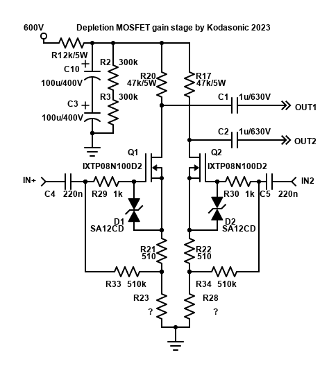

As an aside, I was looking into replacing 6SN7 with a MOSFET...
So far I get this... IXTP08N100D2... Not bad for 3 resistors and a MOSFET (and the coupling caps). 600V B+, 47k drain resistor, 510R on the source, 1k gate stopper. mu=~60 AC load = 1µF into 100k. SA12CA strapped from gate to source.
Adding 2k7 between 510R and ground makes it ~ mu=6 - much like a 6SN7 in the same circuit.

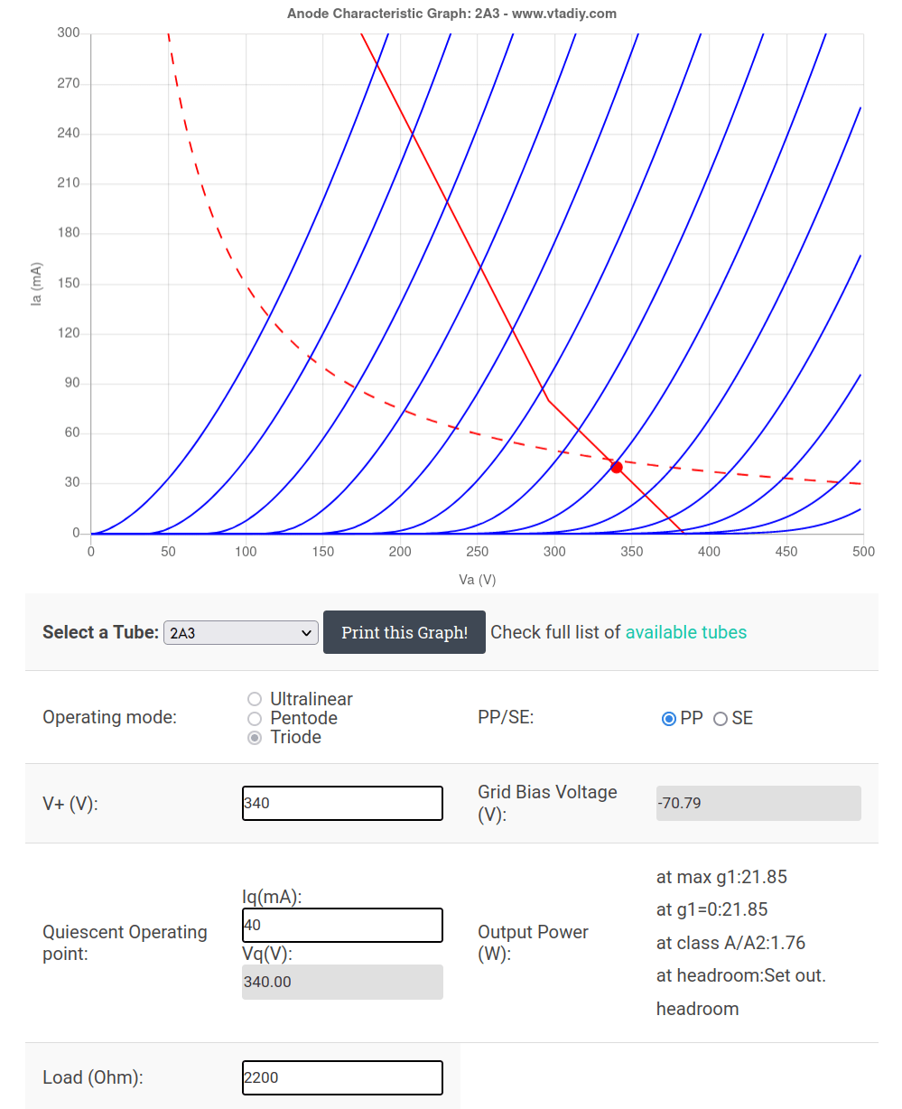

If I'm not mistaken the 6BQ6, 6CU6, and 6AV5 are the same electrically. Pin-out and top cap are what differ primarily and account for some of the ratings.This runs out of current at 25WRMS

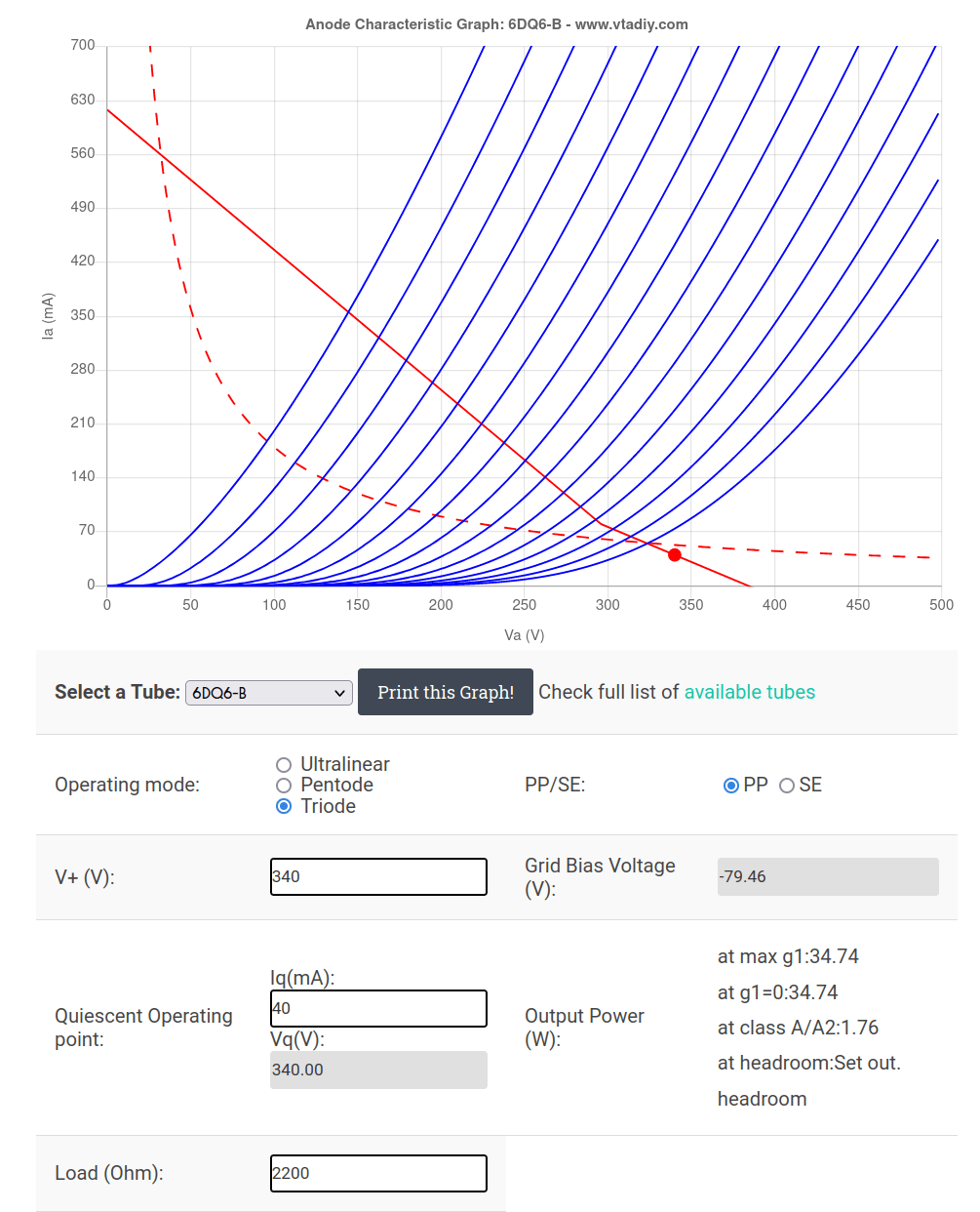

Isn't 2200R a little on the low side for linearity? I would think 3-4k or so to be a better fit.
As long as they have the current, the gNFB does the rest... I run 6P45S (*LW6 and the like) and 6P36S (not sure, EL500 is smaller) at 1k3.
If you used 5k, you'd get less max power. If you limit yourself to that same max power with the lower load, the Dtot is the same... You just get to make more power if you need it (great for dynamics...).
Besides, they are running as triodes... Rp is <1k. I'm sure running a pentode connected stage with this load would be crap though.
Really? Go and tell this Mr. General Electric (see page 2) .Some thoughts: EL86 runs our of current to give long before it makes more than about 12WRMS...
And as discussed above, the Hohners did even more with 'em.

Not sure what is being demonstrated here? Where did you get the quiescent current figure from?Some thoughts: EL86 runs our of current to give long before it makes more than about 12WRMS...
35mA Ik is not possible I don't think, and triode mode is probably not possible either since g2 would be at too high a voltage. The experience of that Orgaphon amplifier example earlier is that they do seem to be able to operate at regulated g2 of 200V, and 18mA quiescent Ik, 350V on the plate. That is very different to the published tube data.

Here's the circuit I made... R23 and R28 were 2k7 I think.Hi Koda,
Can you share the diagram for replacing 6SN7 with a MOSFET? I think I get it right, but just to be sure (and safe).
Could be fun to try!
Regards, Gerrit

My only beef with the gate protection is that the fet inputs will see all of the capacitance of the TVS diodes, since they are essentially being operated at 0V. I have a scheme that biases up the protection zeners to reduce the capacitance they present to the diff amp gates, and keep them out of the way until they actually encounter an ESD event..
