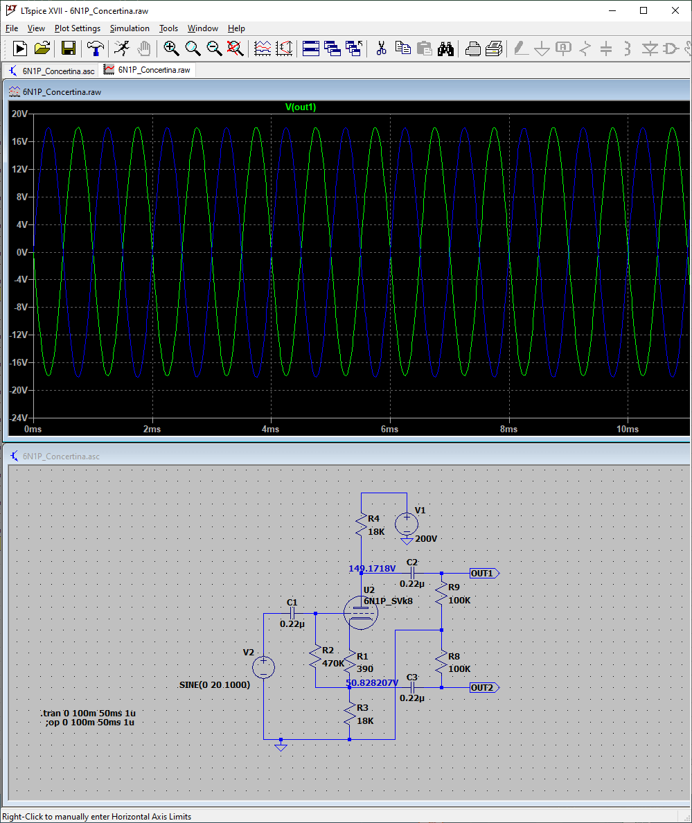

I just might. I have some toroids on hand that will come out to 3k~ or so with an 8 ohm load, should be good for a single or parallel pair in triode- minor differences (1.5~2 watts) in power output between 6k and 3k reflected load. Might just use them for the V8 build, 4 per side, 6N1P drivers, since I already have a couple sockets wired up for the volt-amp/concertina front end. Just gotta buy a new hole saw as I smoked my last one that I usually use for noval sockets.
Only problem is my power supply toroid that's set aside will give way more volts than I need at 2x150VAC, unless I parallel them to run lower volts and higher current. Then I would need to look at a different driver maybe? You think a 6N1P concertina can swing the volts with only a 200 volt supply? Assuming fixed bias, Power per 6P43P-E pair at 200 volts will drop to like ~5 watts out with 6k, 7 watts with 3k, which seems wasteful honestly. Drive requirements are cut almost in half though.

Low supply voltage, high signal voltage demand and Concertina won't fit well. You'd better look for another PI design, maybe a LTP or a Paraphase.You think a 6N1P concertina can swing the volts with only a 200 volt supply?

Admittedly, I'm not much of an adept of the Concertina, mostly due to it's very different output impedances and it's relatively limited output voltage swing. Instead, I prefer the LTP with a SS CCS tail, especially if the power tubes are fix biased and a negative voltage rail is available.

According to Spice it is doable:6P43P-E triode with ~200 volts supply will only need ~18 volts peak per grid to drive. Should be doable with 6DJ8 or 6N1P concertina. That, or a LTP with a 6N2P, 12AX7, or 12AT7 would work.

18 volts output uses up all the headroom in that concertina. 64 volts at 3.8mA is damn near vg=0. More power hungry tubes and you’d need a higher supply. Not that I haven’t abused them myself or anything - my latest cute little amplifier runs the concertina within an inch of its life and still sounds clean… with no NFB at all.

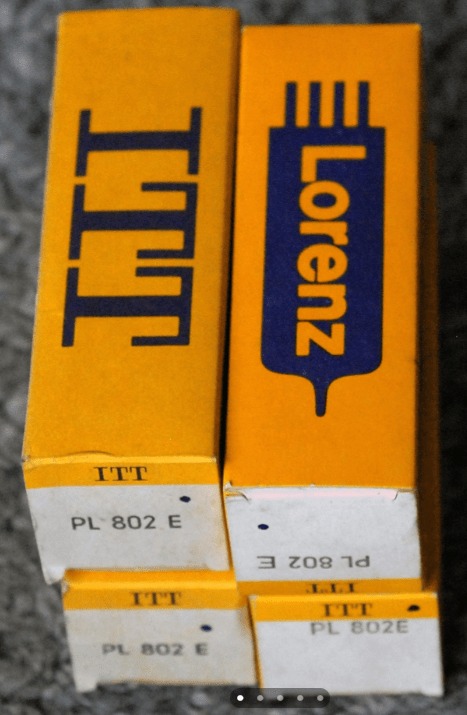

PL802 falls in the 12HG7/BY7/ rank....cheap, fat cathode, with high gm. In audio work I use them as triodes giving excellent 25-28dB in RC config. There are a couple of caveats using these tube types.
1. Note high g1-Cath capacitance on data sheet. Use no greater than 100R as a g1 stopper. If one goes to 10K or sim, then HF response falls off fast. Using a low value grid leak pushes the onus on to the previous stage that has a lowish output impedance.. Otherwise one could be blaming another component for lost HF response!
2. Through the 1950´s through to early 1970´s, these tube variants were produced in the millions, and consistency especially H2.H5 distortion varies enormously.
To get sensible matched pairs with equal Va, distortion etc I needed to delve through my stock of several hundred NOS to achieve 50 matched pairs. Tedious work. Some were way, way out, but who cared for video distortion when the specs in those early days were very lax ?

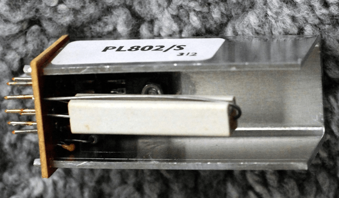

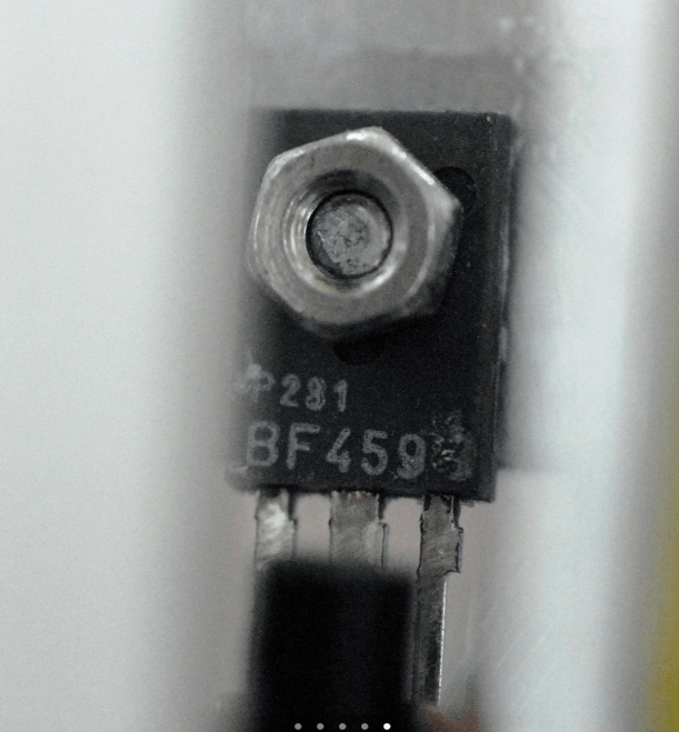

I don't doubt your statement, but am astonished anyway. In the 1970ies PL802 had become an extremely scarce, sought after, and expensive tube. Tube manufacturers were even forced to develop and market SS replacements like this one by Valvo/Philips (sorry, in German).PL802 falls in the 12HG7/BY7/ rank....cheap, fat cathode, with high gm.
