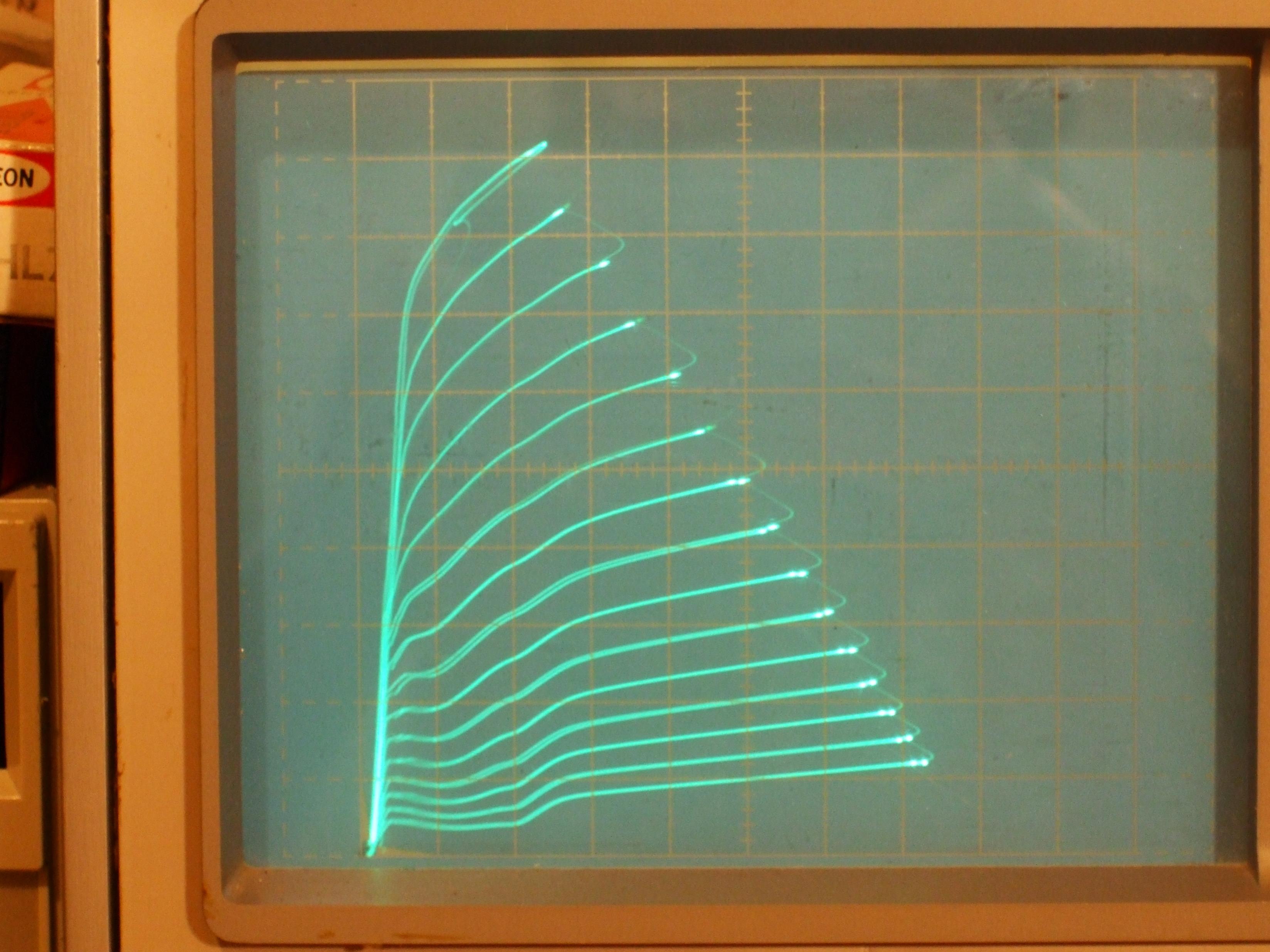

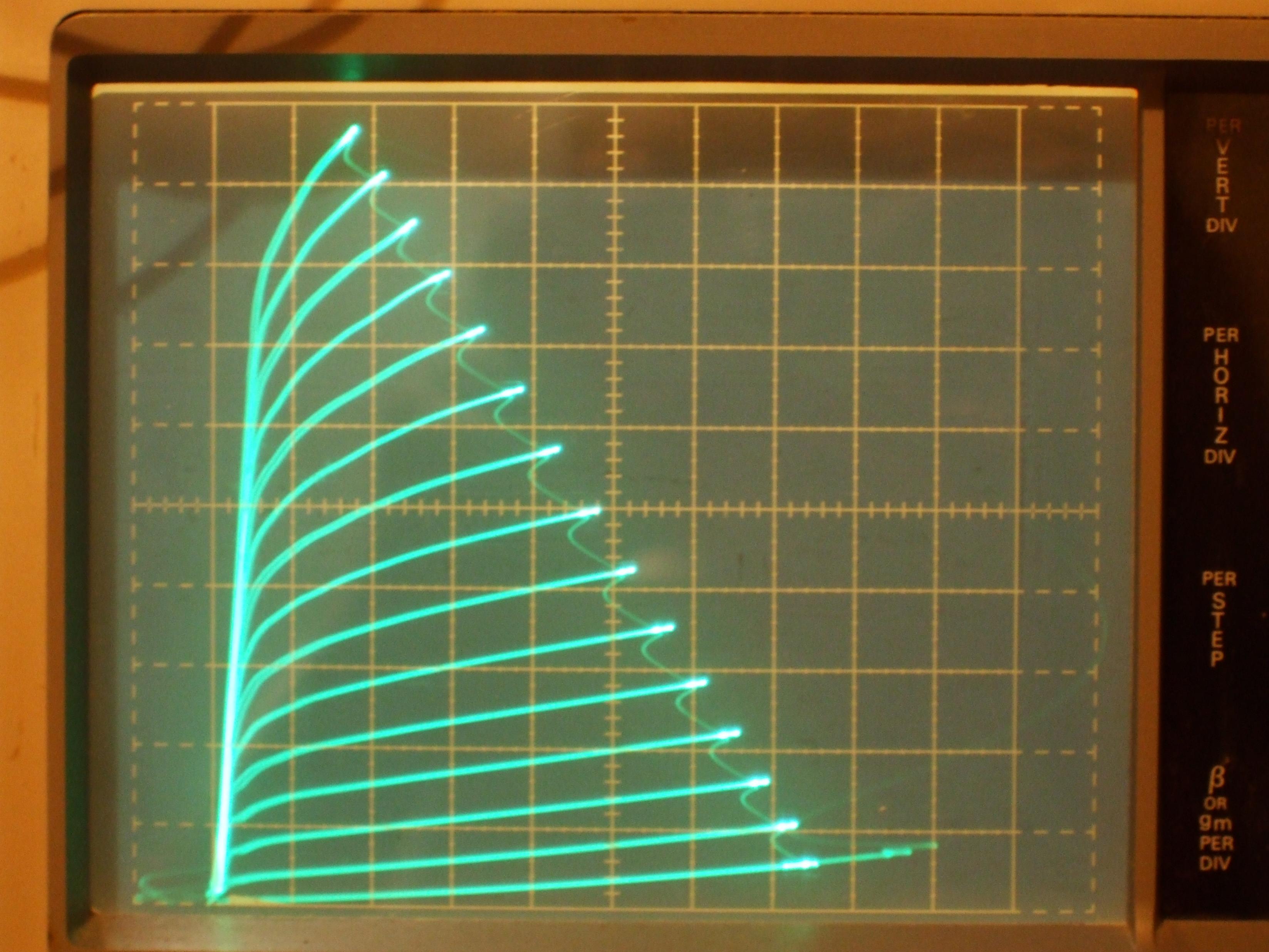

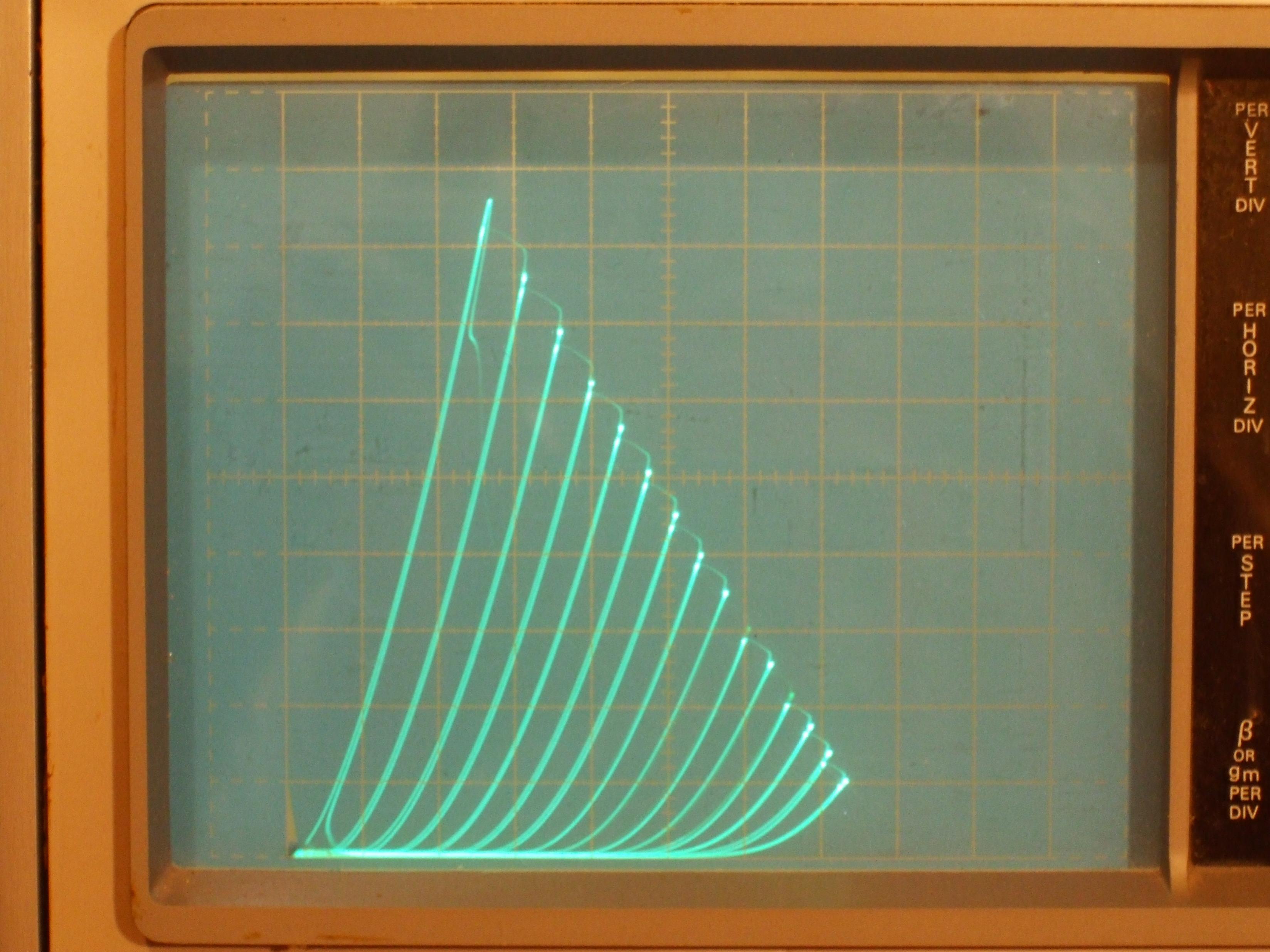

Here are some curves for a Sylvania (USA) 25HX5
a) pentode 50V/div Horiz., 50mA/div Vert., -2V steps, 125V grid 2
b) triode mode (plate conn. to g2) 50V/div Horiz., 50 mA/div Vert., -6V steps

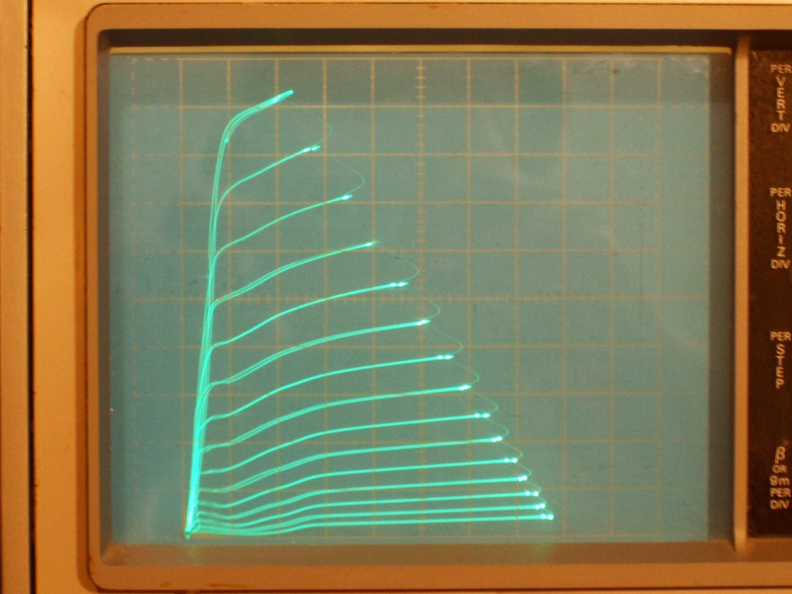

Here are curves for the National (Japan) 25HX5.
a) pentode 50V/div Horiz., 50 mA/div Vert., -2V steps, 129V on grid 2
b) triode mode 50V/div Horiz., 50 mA/div Vert., -6V steps
Th National Pentode has a little more screen current wiggle in it at low current. And it took 129V on grid 2 to get the same peak current as the 125V on the Sylvania. The triode is pretty close, just slightly higher Mu. (like 129/125 ratio times 4.65 = 4.8)

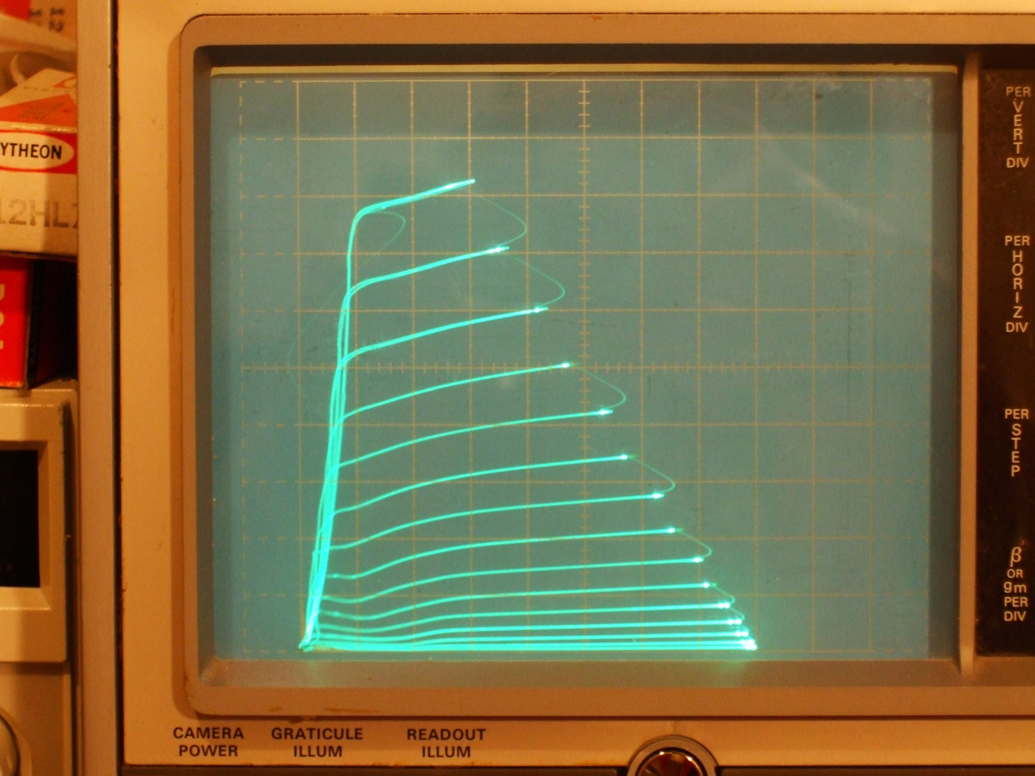

Here are curves for an RCA 25DN6, George has mentioned this tube.
a) pentode 50V/div Horiz., 50mA/div Vert., -2V steps, 140V on grid 2
b) triode mode 50V/div Horiz., 50mA/div Vert., -6V steps

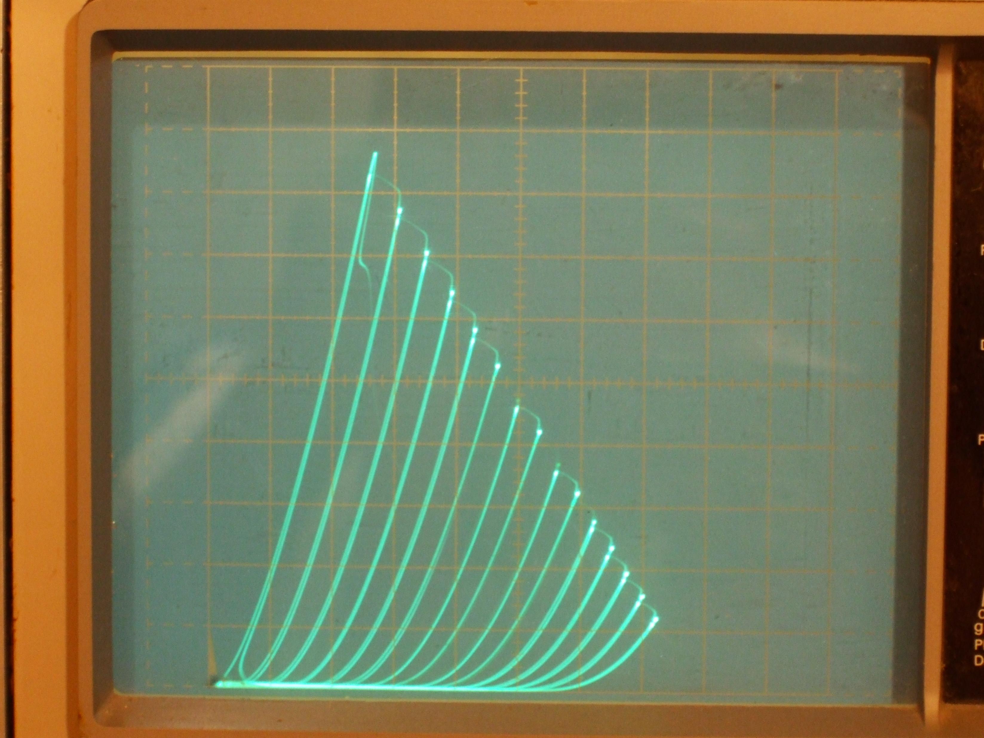

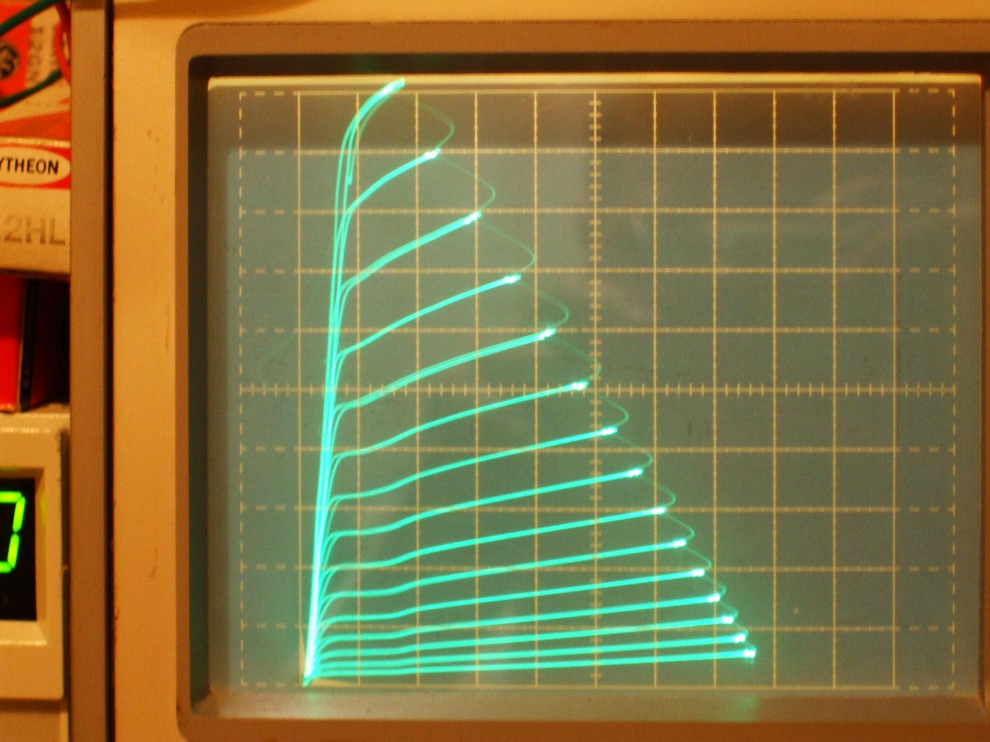

Here is that 25DN6 using Grid 2 drive. 50V/div Horiz., and 50 mA/div Vert. Grid 1 at 0V.
a) +10V steps on grid 2
b) approx. +10.7V steps on grid 2
Looking at the datasheets for 6DN6. 6DQ5, and 6LG6 I see screen current as 10%, 5% and 2% respectively of plate current, so that grid 1 drive wiggle may be normal. 6DQ5 starts to show noticeable kinks.

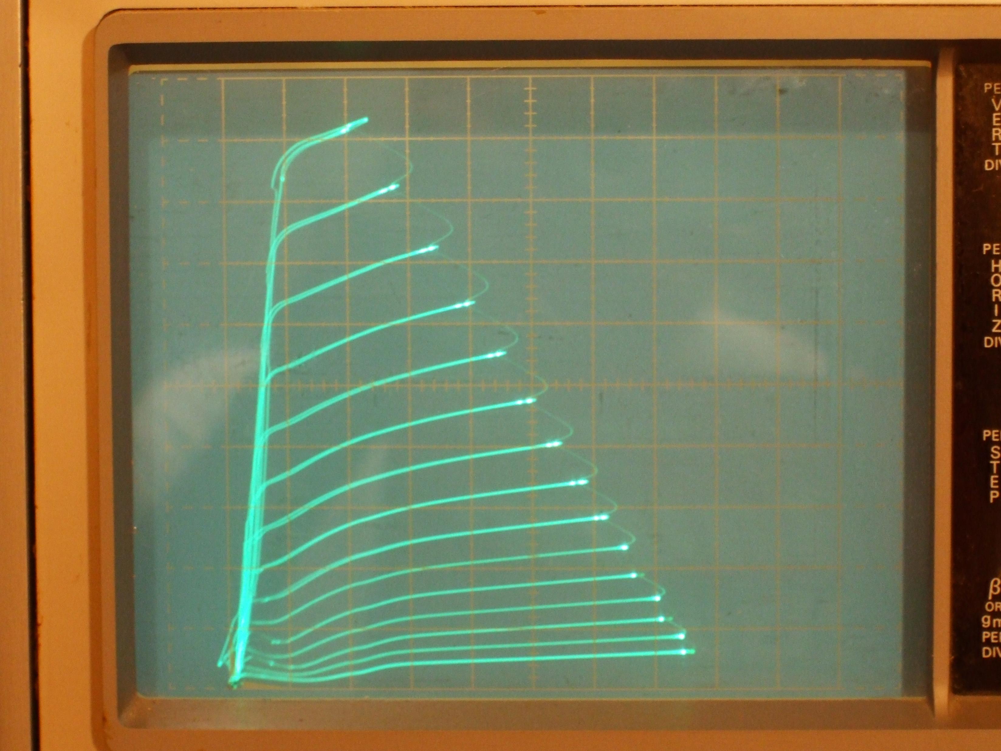

Here is a Sylvania 6DQ5 for comparison. Grid 1 drive.
Screen current wiggles are becoming obvious on 6DQ5 at 5% screen current to plate current (spec).
50V/div Horiz., 50 mA/div Vert., -2V steps, 110V on grid 2

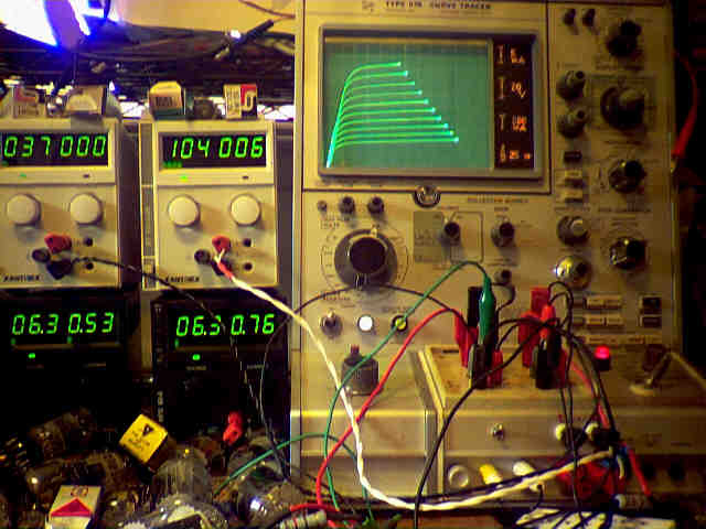

These curves are using a Tektronix 576 Curve Tracer (normally for SS components) which has had some mods to allow higher "gate" (grid) voltages for stepping.
Up to +/- 168 V step range (or 14 steps of up to 12V) so it can do grid 2 stepping as well. (even higher with a fixed supply added in series) The step amplifier got some mods obviously with higher V transistors, normally does 10 steps up to 2V/step for FETS. I just had to pull one IC pin out to get 15 traces, instead of the usual 1 to 10 traces (well, a mod to the step D/A too).
A few more mods done too. Has a variable knob for step size now, beside the usual switchable step selector (so I can adjust display to full screen). The 1500V max collector (plate) V scale got dropped to 750V max for safety. (rectifier wiring mod), although I usually use the 350V Max (400V peak) scale for tubes as for the above curves.
The DUT module (bottom) got modded so that each DUT position (toggle switch front, Left or Right) gets its own Screen V selected from external Xantrex power supplies. Also another two Xantrex supplies for heater power, which keep the 2 DUT tubes warmed up full time. So even different tube types can be compared by flipping the DUT toggle lever.
The wiring to the tubes is done by banana plug to individual 0.04" pin sockets/terminals. I use some Pomona or Vector tube extenders on the tube so that the pin-out wire-up only has to be done once for a tube type. Can run a bunch of tubes thru test then. I also have adapters made up to convert Octal, Loctal, and Magnoval and sub-mini wire to 0.04" pins.
Some connectors added on the side for X and Y display options (I just brought them out to BNC connectors, TEK had them available in the plug-in DUT module for fancier tests). Can use a Tek AM503 / A6302 DC current probe (clip on) to display screen current for example.
Can test tubes up to 220 Watts or 2 Amps. Switchable load or max Watt ranges. But works just fine for those sub-mini Lilliputions too.
OH, and I bought a spare working TEK 576 (EBAY) for spare parts. You can not get parts for these from TEK anymore.

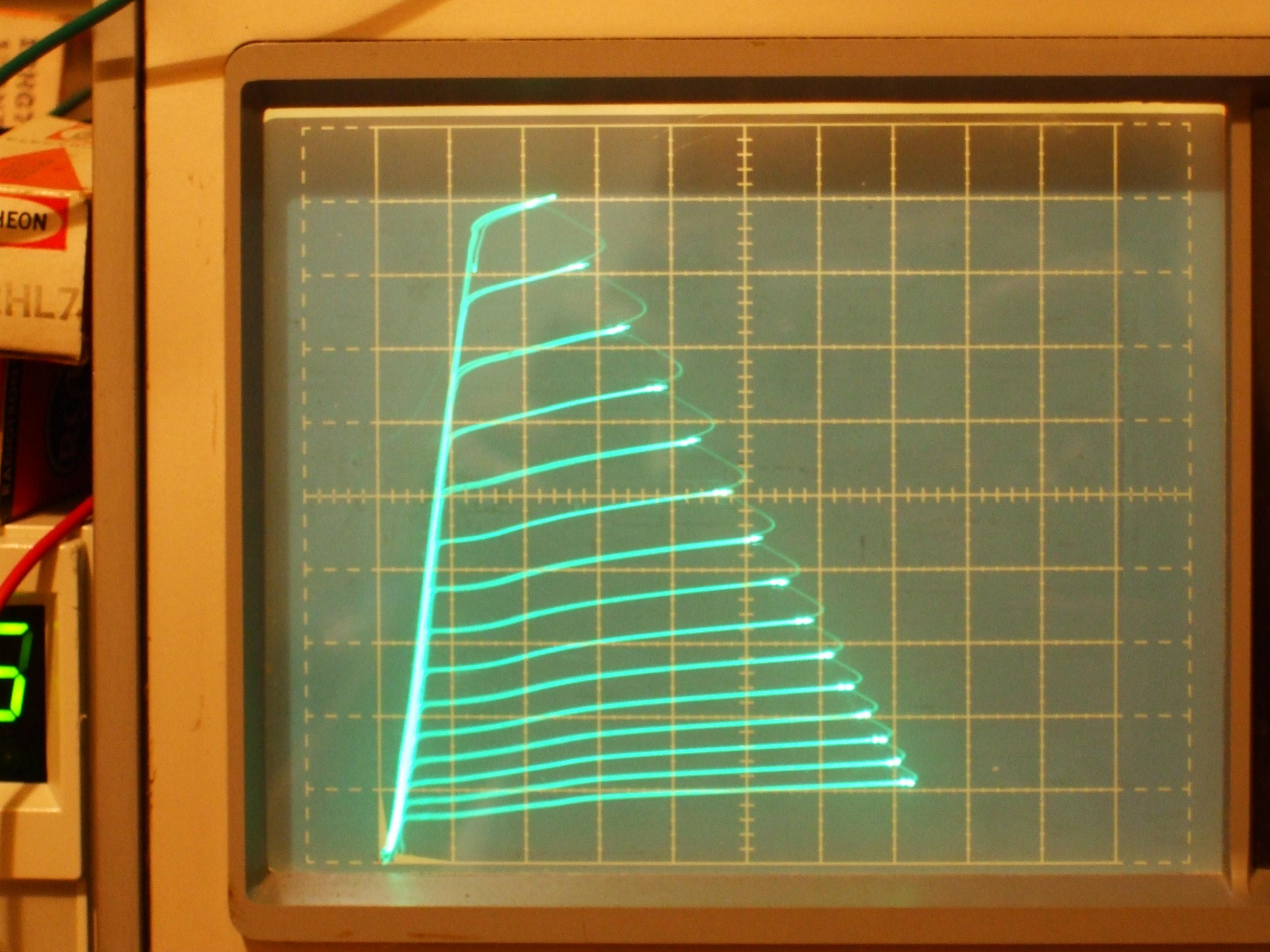

And the winner is ..... 12GE5 (from the $1 tube list, 17.5 Watt tube)
What screen current!
No kinks here.
50V/div Horiz., 50 mA/div Vert., -2V steps, 156V on grid 2
