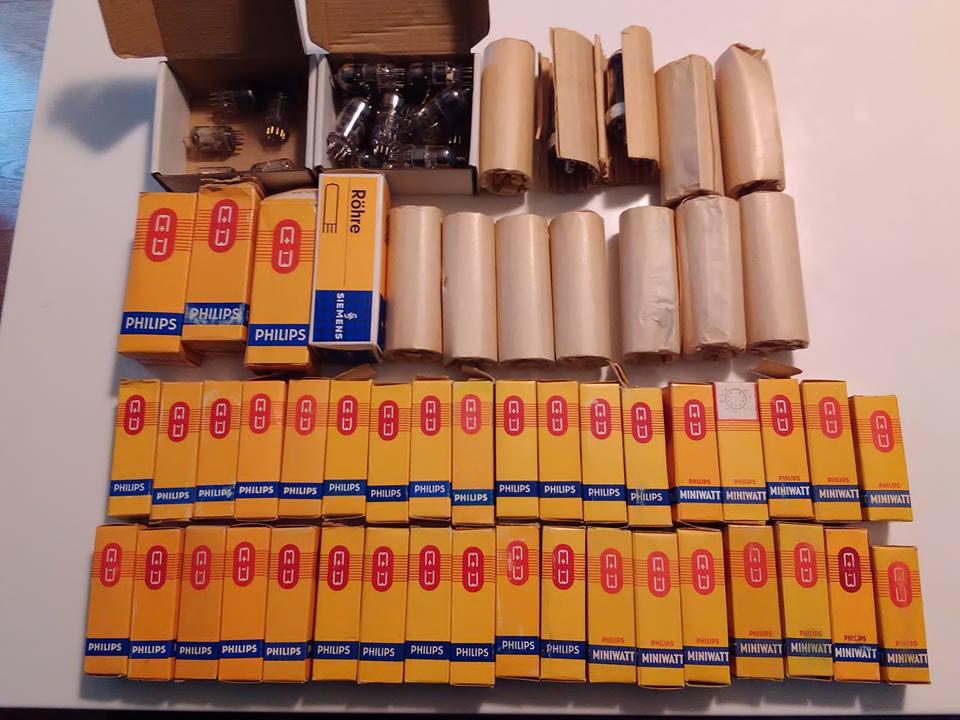

Happiness! Thanks to yesterday's flea market on our national radio hobbyist's day, I got my hands on plenty of original, new Philips TV tubes - PL36, PL82, PL83, PY82, PY80 and EZ41. The ones on the top are 4P1L, EAA91 Telefunken and some 6N2P/3P, but they aren't TV tubes. Don't ask me for the cost, it is ridiculously low. The seller claimed they were picked from an old TV repair shop in Switzerland.

great find.....a couple of years ago, we also picked a shop of 1800 pcs of tubes, shops like those are still being discovered in Manila...
those who stopped selling tubes in the 80's are now taking out their stocks and again selling.....srill we hear some stories of shops dumping them on trash bins....

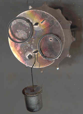

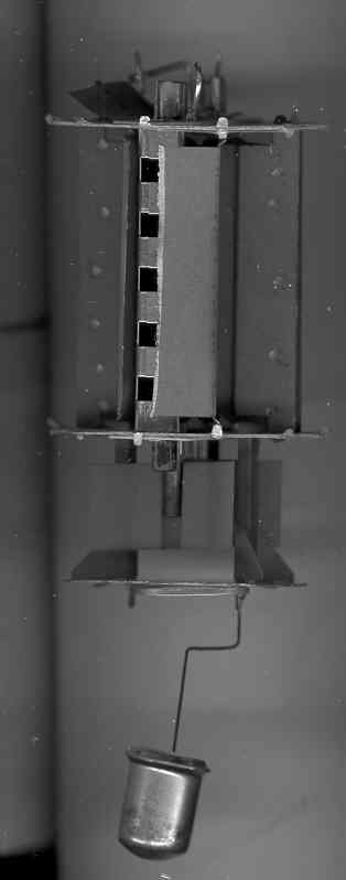

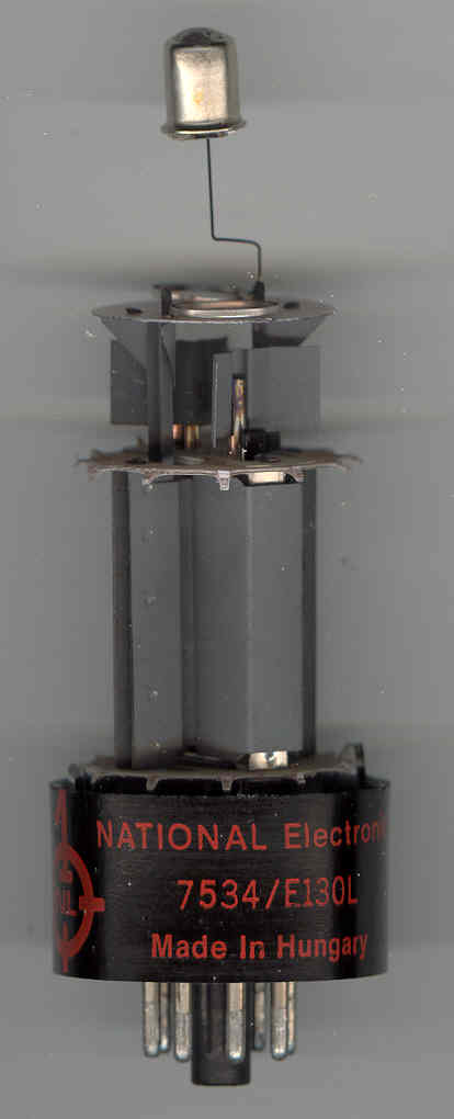

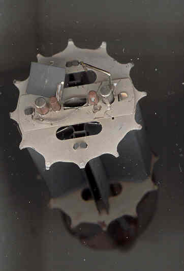

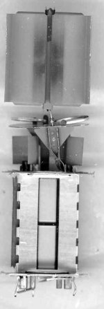

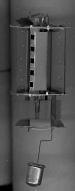

I got a couple of National (Tungsram) E130L tubes off Ebay, and one of them was defective. (it got replaced!) So the opportunity for tube dissection of this interesting tube has arisen. Where's my hammer!
Pics:
1) E130L busted. Notice the extended cooling fins up top for grid1 and also the plate.
2) E130L bottom view, notice the grid1 bonding plates (one fell off), these were not properly spot welded to the grid1 support rods. No connection between grid1 and the base pins. Notice how big the grid support rods are. This is making for some rather long grid2 wires.
3) E130L side view of plate after grinding off a corner from it
4) E130L half of plate removed to see grids and cathode, the inside of the plate is above (notice the burn marks on the plate, this was used some before failing apparently, or maybe the loose grid1 could not restrain the beam current and burned the plate on first use)
5) E130L top mica with getters

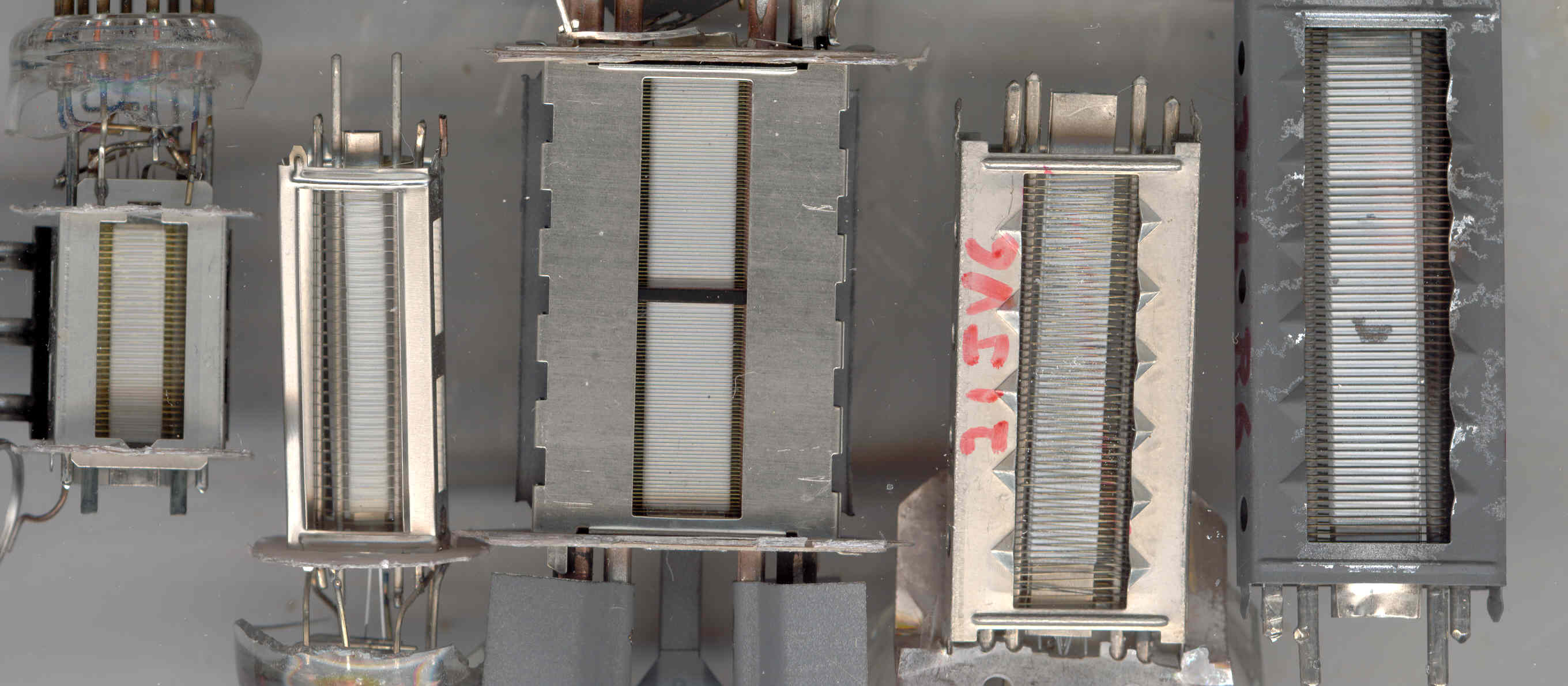

6) E130L close up of grids 1 and 2 at high resolution, surrounded by the shiny beam forming plates. note they both are wire aligned frame grids. Also a cross beam strap (black) between the grid2 support rods. There is also a hidden copper cross beam strap below that for the grid1 support rods.
7) grid comparison of some tubes L to R:
12HL7, 6HB6, E130L, 21JV6, 35LR6
The 12HL7 and 6HB6 have a coarser grid2, which is what you see, the grid 1 on these is like 5 or 6 times as finely spaced as grid2 (you can just make out the 6HB6 grid1 wires at max magnification) (the 12HL7 wires are too small to see, just seeing the grid2 shadows at max magnification) 12HL7 is a frame grid. 6HB6 is not, but has nearly the same wire spacing as the 12HL7. 21JV6 and 35LR6 are typical TV Horizontal Sweep tubes.
I'm wondering if the other tube was a failed pull now too. Both were in National boxes. The other tube does perform satisfactorily on the curve tracer. Will have to run it for a while I guess to see if something goes wrong.

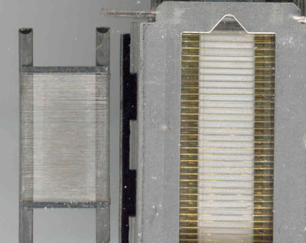

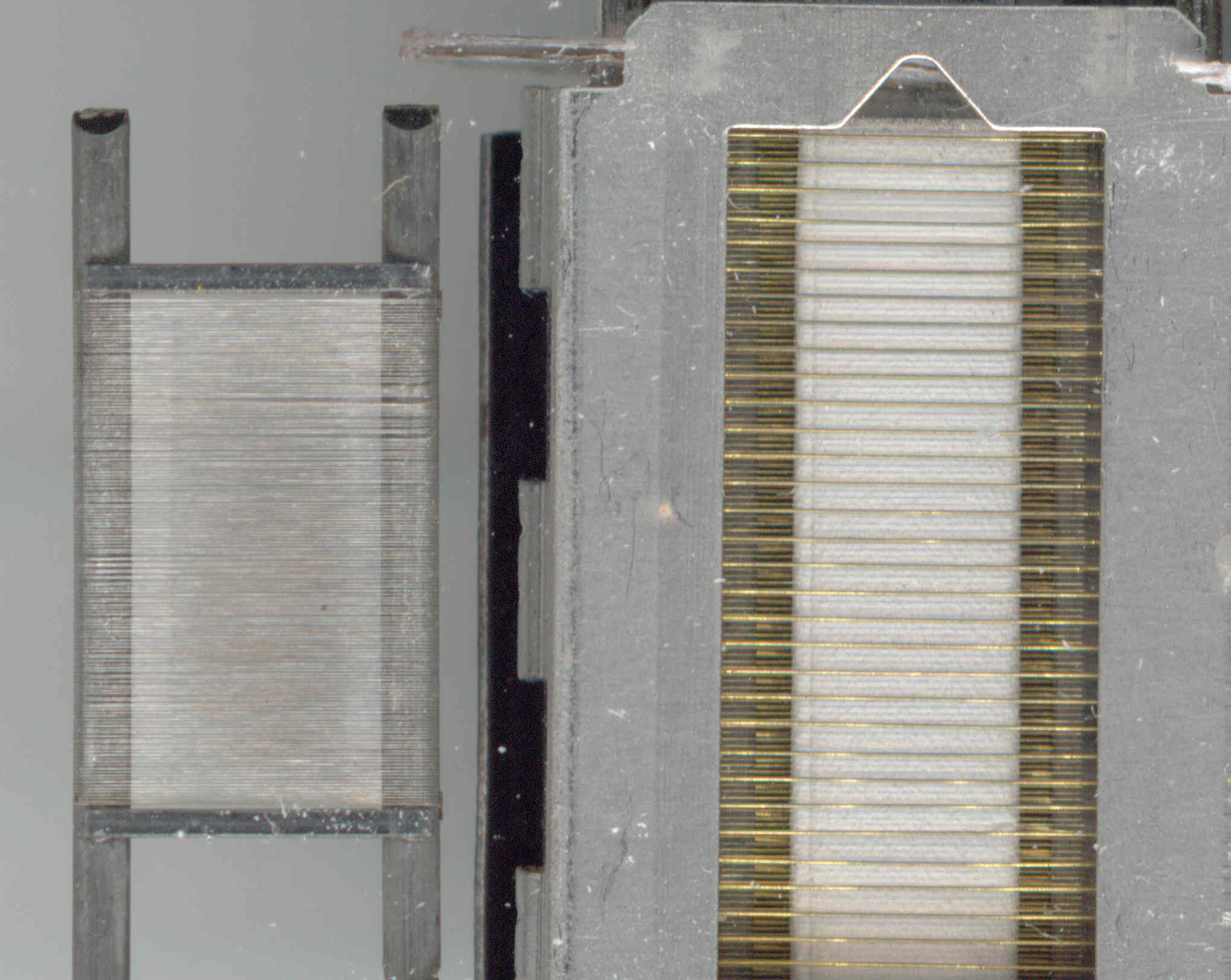

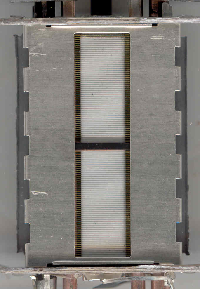

Here is a better pic of the frame grids in the 12HL7 (right side) and a 6JC6 (left side). Scanned at 1200 DPI. That 6JC6 grid is incredible. Still not resolving the individual wires in the 6JC6. Can look right thru it like a crystal.
OK, 2400 DPI now. 2nd pic. Can just resolve the 6JC6 wires now (use the magnify function). Looks like they are almost twice as dense as the 12HL7 wires. It must have taken some serious time and ultra precision winders to wind these frame grids.
