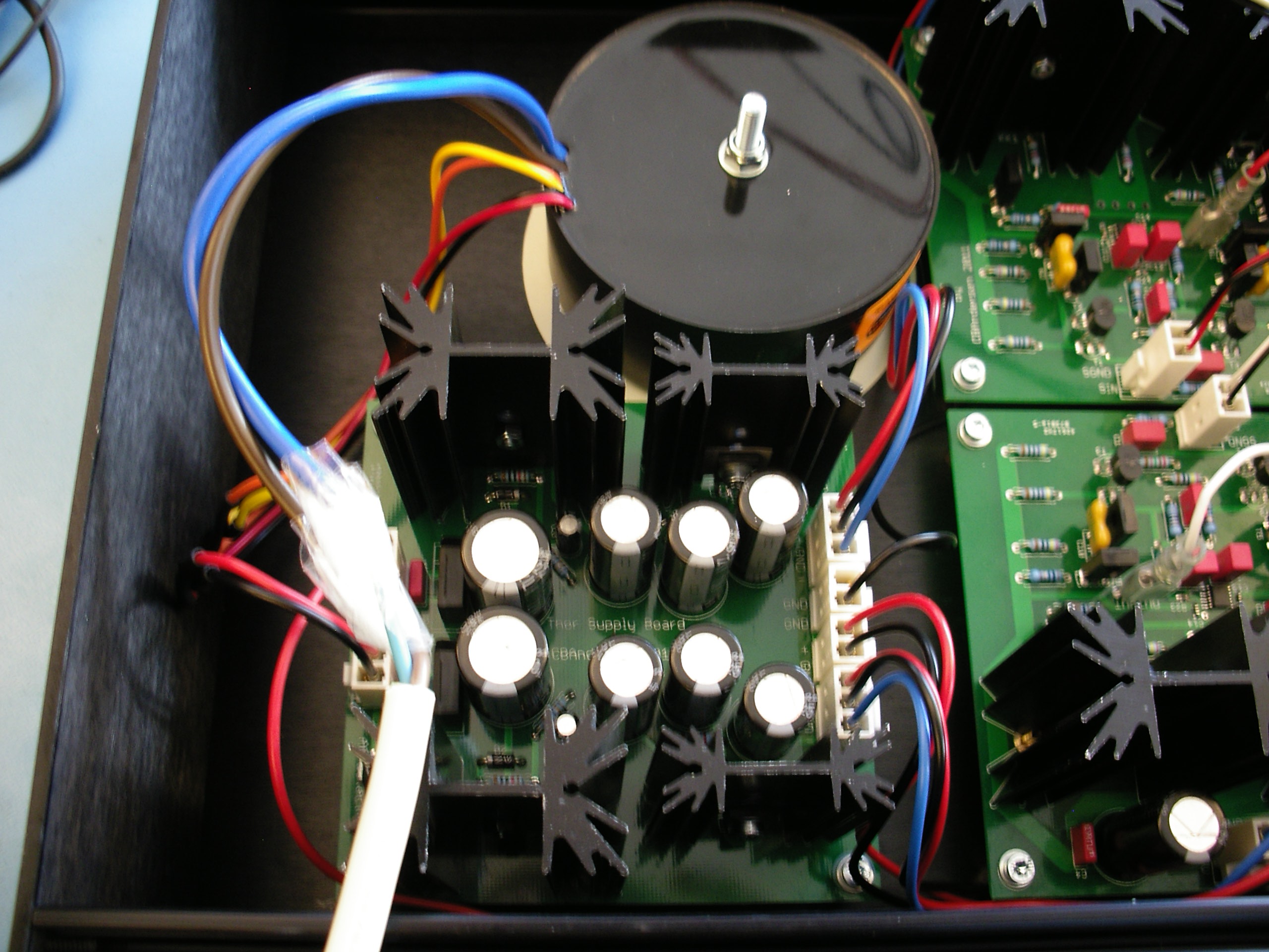

Here is a rather crappy picture of a supply board PCB.
I completed a board today and so far it looks like it works.
However I only sent +/- 20VDC through it, so the real test is not before Monday when I can hook up my transformer to it.
If everything goes well, I should be able to test everything together on Monday, that means amp boards, supply board and no-thump board all connected together in my modushop alu case.

Well, hooked it all up today, no smoke, humm or buzz and it sounds great. :cool:

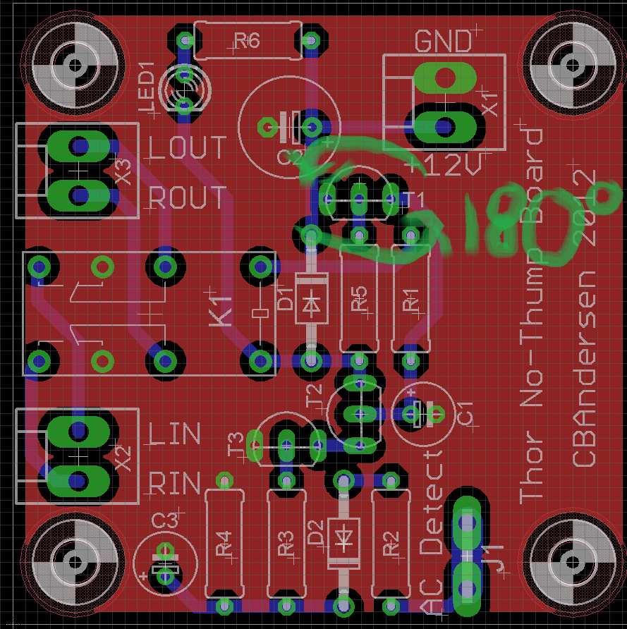

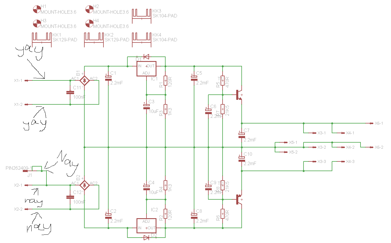

Only problem is my No thump board, the AC detection doesn't work as it should, it doesn't work with AC applied to the AC detect connector. DC fine, AC no go. :eek:
I'll have to figure out the issue tomorrow, but to be honest I'm rather puzzled by it. :confused:
Simulation works absolutely 100% and similar AC detect circuits has been used with success for years by many others.
But I'll have a solution sometime tomorrow. :)
Edit : Think I have an idea why it doesn't work, but I'll look into it tomorrow

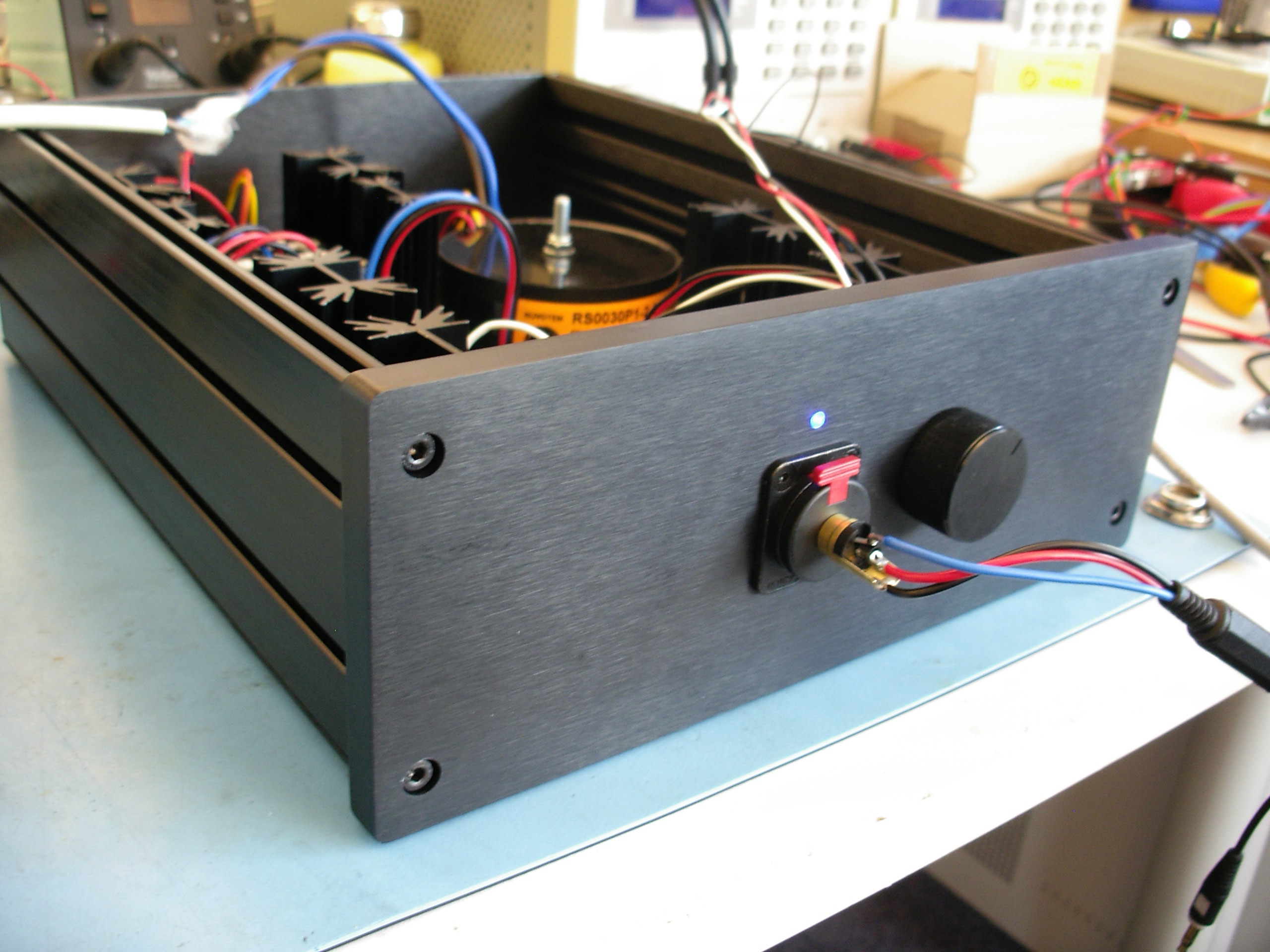

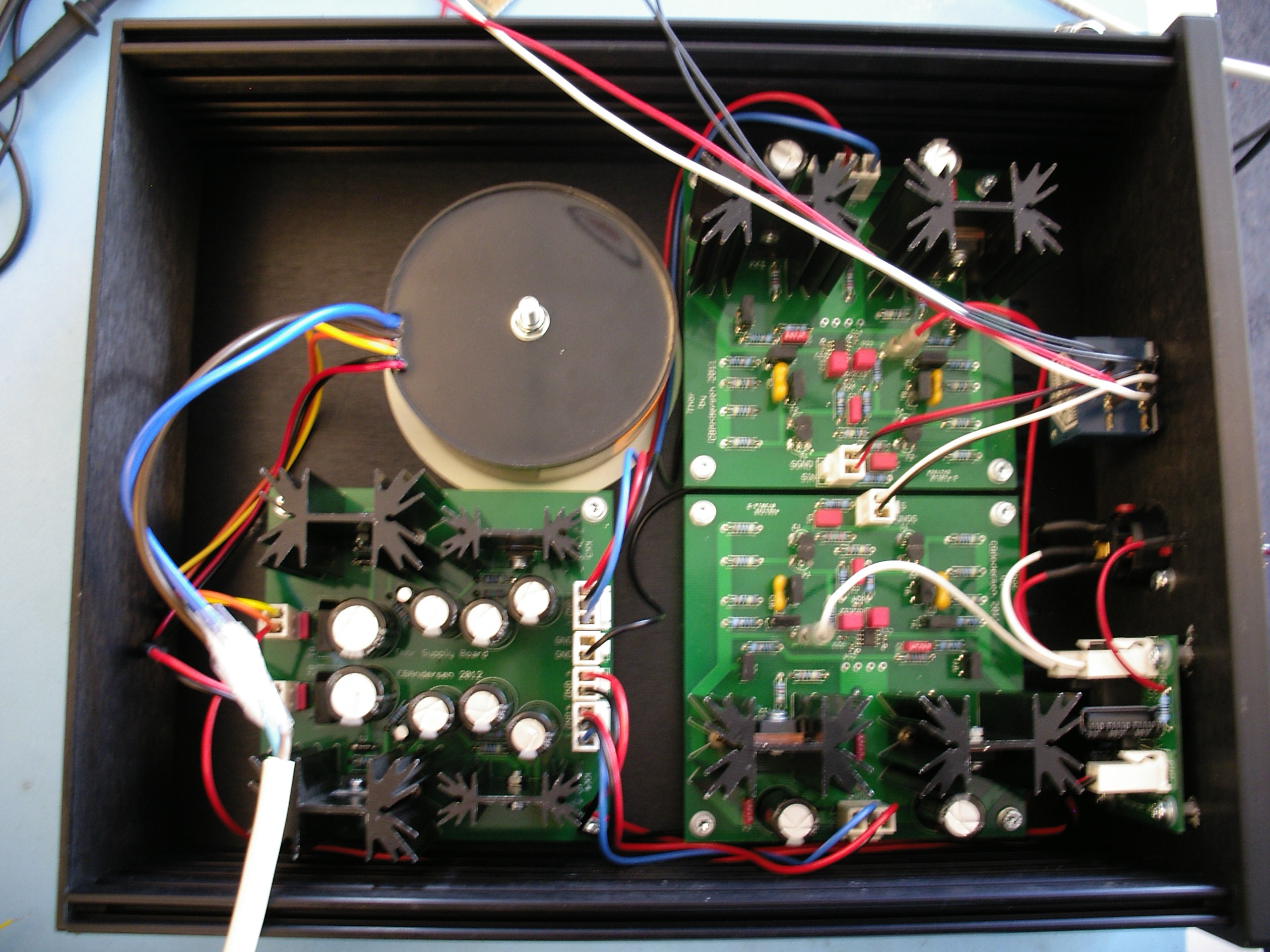

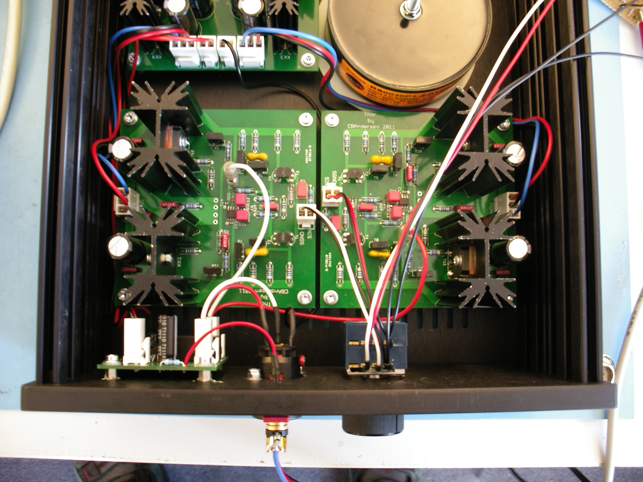

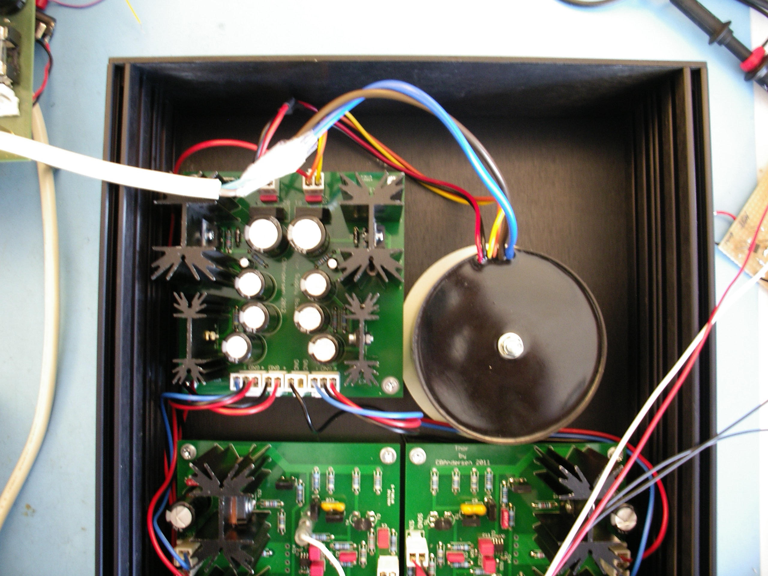

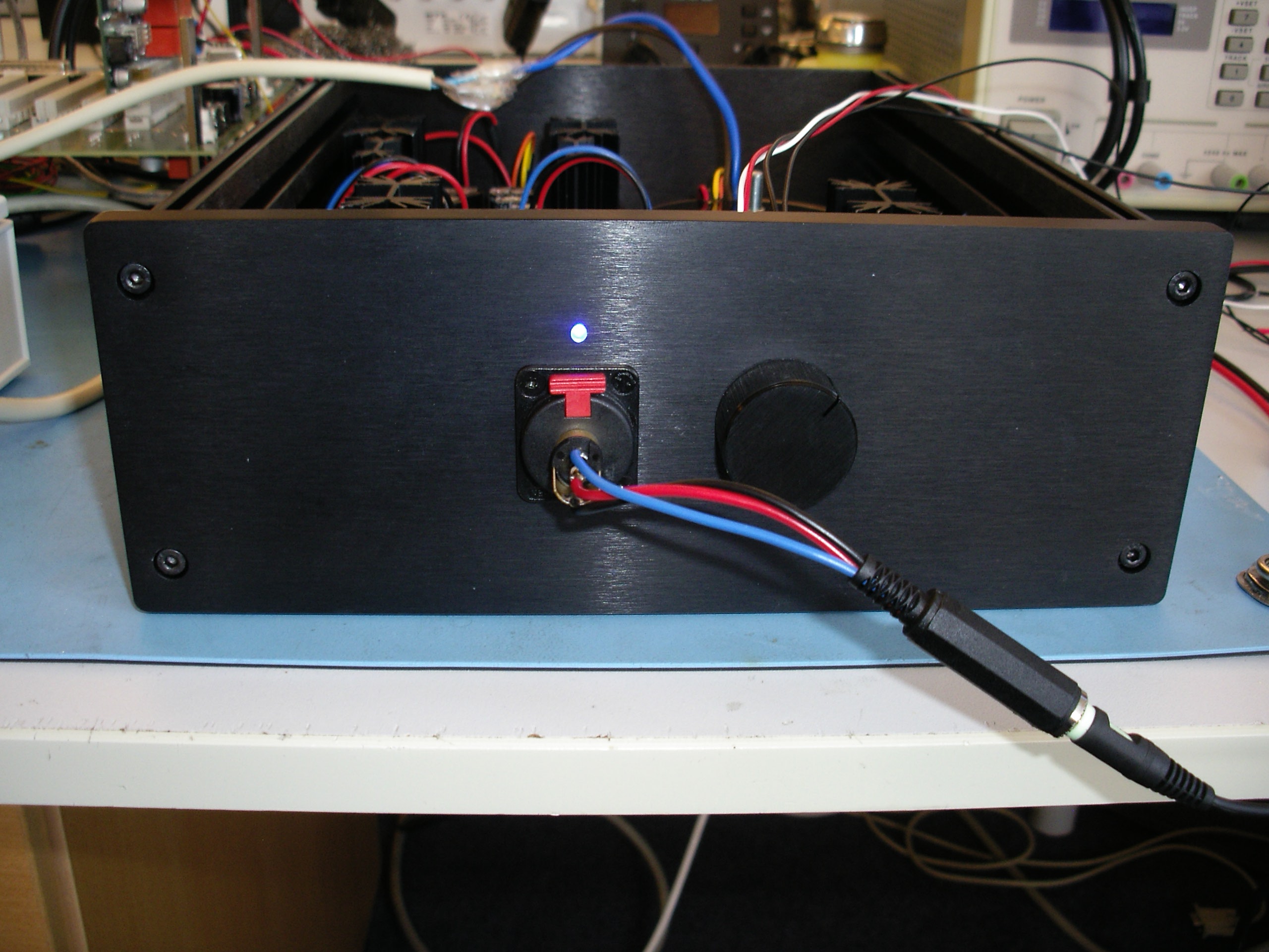

Got everything hooked up.
It works and it sounds great. No hum or buzz. No pop/thumps/crackles when turning on and no squealing/whizzing and similar noises when turning off.
Looks like everything is good to go.
What is left now is mounting the IEC inlet(with filter) in the backplane as well as the Neutrik RCA connectors and then solder the few wires I have left.

Like I mentioned in a previous post, I had an issue with my No Thump board where a transistor had to be turned 180 degrees. The first picture I have attached shows that transistor.
Also, my AC detection didn't work. Well, I found the problem, I connected the AC detection wire going to my No Thump Board, to the wrong secondary on the Supply Board. Attached picture number 2 shows what is the wrong connection and what is the right connection.
