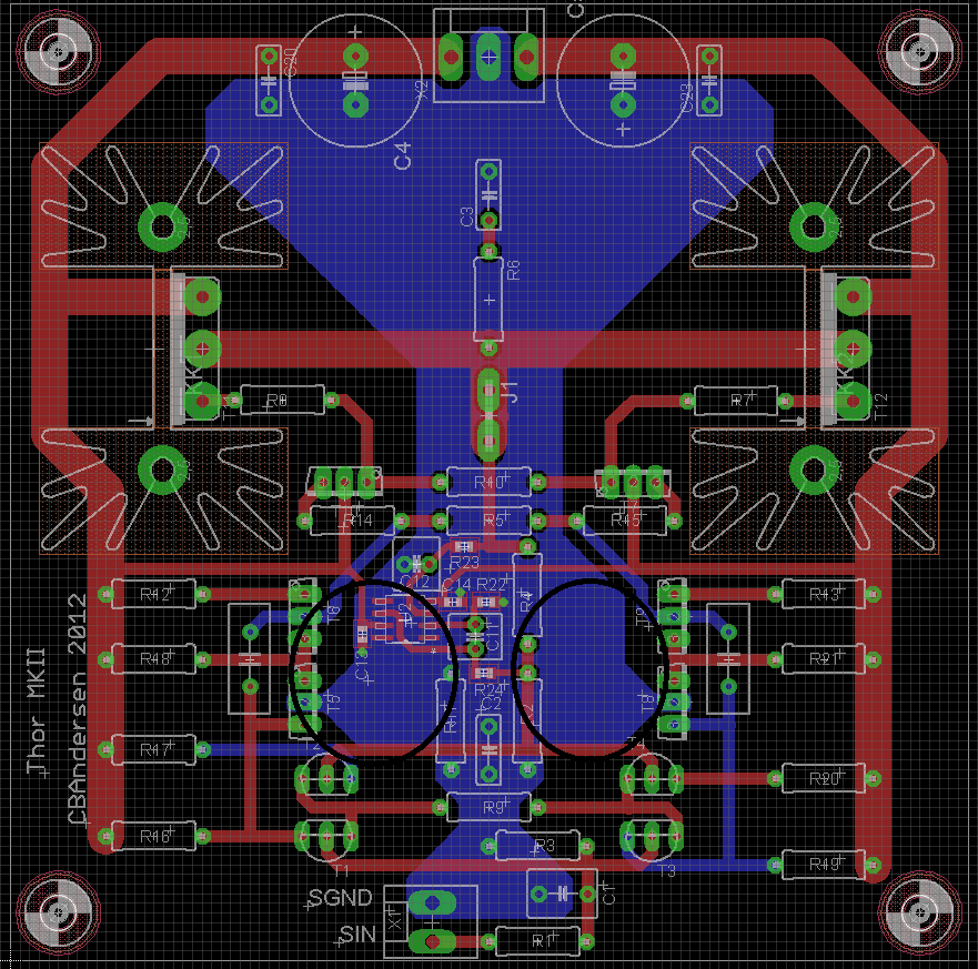

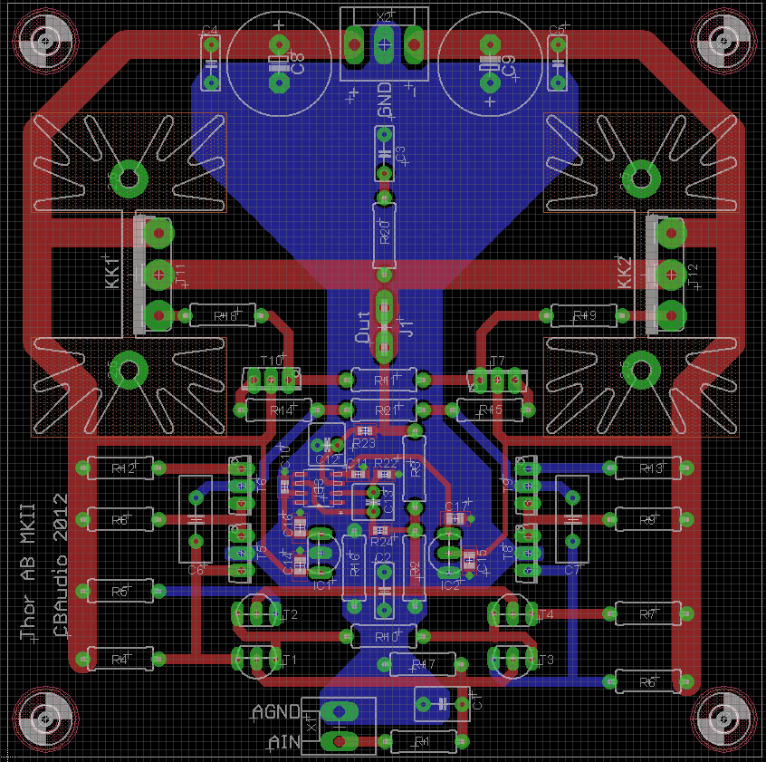

To make it easier to use higher voltages for the Thor MKII amp boards I am adding a pair of 78L15/79L15 regulators for the DC servo. This should make it a lot easier to use anything from +/- 12VDC to +/- 30VDC for the Thor MKII amp boards without having to use less precise and expensive opamps like OPA445 and similar for the DC Servo
Attached picture shows the likely placement of the regulators.
...78L15/79L15 regulators....
That should have been 78L09/79L09 regulators. Otherwise using a +/- 12VDC supply for the amp boards wouldn't be possible.
