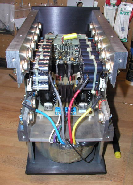

it would take up less room
It might take less room, but then my heat sinks would get smaller and I need them all.
Placing transformer under is more elegant way, don't forget also about the AC entry/filtering board. The amps seems to be better balanced too (mechanicaly).
One other thing: the front end board goes between capacitor banks, so if I put transformer there it would be really tight.

I added the extra caps because by removing active regulators I had extra space. The current is about 6 A for both sides (maybe 8A if heat sinks will allow). I guess it also depends on an amp how it sounds with different amount of caps. What I think, with less caps the highs might be better, but with more, the bass is bettter. You have to experiment and choose your best option.
Eventually this amp will be for subwoofer and I will build another one (same chassis but stereo) with 2x 50W for highs and mids and then I will have tri-amp setup.

As you know chassis work is the most time consuming, good binding posts and jacks are expensive also, anodising is another expense and so on. I've got there 96 Panasonic 1,500u HFQ caps which cost me CAD 500 alone.
I have 3 pairs of A75, 2 Zens and almost done SOZ, plus another 4 chassiss' already done for more Alephs. I don't have much use for all those amps and I won't sell them for next to nothing. So my line of thinking was, if I remove input boards from my A75 and change a bit output stage I will have an Aleph2 and this would be much easier to sell. After seeing production pictures of Aleph X I decided to go for an AX amp too. Now it's a bit more work, but still worth it.
It's not really taking apart perfectly working amp, but rather improving older design and modifying it to sound better. It's like I have to do only 25% of work instead of 100%.
After all it will be one of the few DIY Alephs with TO-3 output devices.

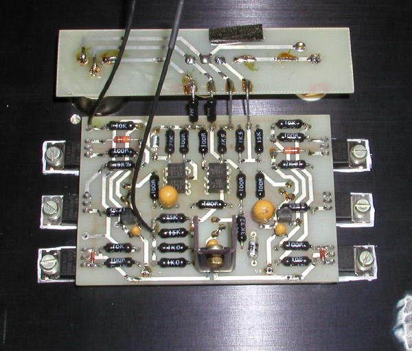

This is front end board. It's mounted to rear panel by the FETs. The 3 pots for bias and offset are mounted to the board from behind (the board is double sided). There are holes in the rear panel to adjust those pots, so all ajustments can be done without opening an amp. The small board mounts directly to the input jacks (Balanced and RCA) and from here with resistors and wire the signal goes directly to the main board. This way I avoided wiring completely. There are only 2 short wires to the output stage and that's all. Again, this was A75.

I got everything done except the front end board. I'll use a piece of aluminum and mount everything there using aluminum as a heat sink for FETs. The circuit is simple enough not to bother with PCB. You see how simple it looks in my Aleph5.
It's nothing short of an art form, not to mention that p2p sounds superior.
I'm like Jocko, I don't make schematics. I use whatever was posted in Aleph X thread and basic Aleph 2 schematic, and go on. As I said, I only have the front end board left, to finish the amp. I'm not really rushing now, because the journey is more exciting than the end itself.
