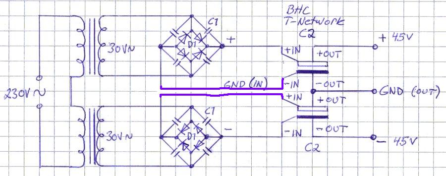

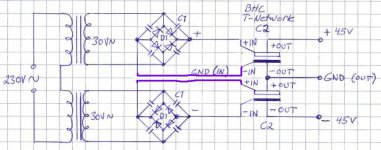

classd4sure said:
First ELNA Cerafines which were far outdone by BHC T-networks but only 10 000uF a rail for two channels on both of those setups. Now it's 30 000uF /rail on a stereo pair of ucd180s with 500VA, with dual 68 amp 600PIV FRED bridge rectifiers and nothing else.
These caps in // are like bandwidth in a can.
Can you tell bit more how Jensen sounds different compared to T-net?
I feel interesting to try Jensens over my current T-nets.
What is connection you use is that same than i use? (Bad drawing attached)
