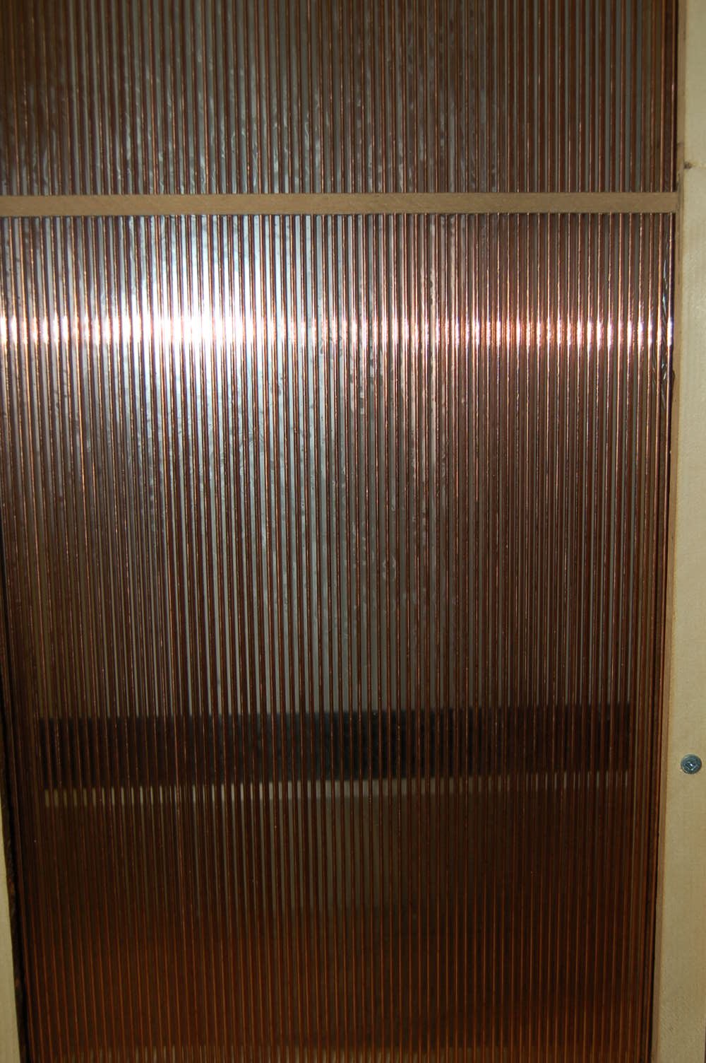

pic of mine, note my cross sections are all drilled for the rods spaced at 10"
Very nice looking wires. By the way, it looks like cross bars and structure are machined from fiberglass epoxy laminated, am I right? And what is the dark wide row at the bottom of the picture, is it supporting the film? By the way, as I understand, your wires are supported at 10". If so, how have you achieved so straight wires across so long sections?
Lukas.
Bazukaz, Your right on the cross bars, they were a lot of work, drilled over 800 holes so far, the rods were very straight, could have spaced them further but wanted the stability. 8 bars per unit 520 holes drilled. Comes apart in 3 sections, nothing glued but diaphram. The dark wide strip is the base board on the wall, very transparent.

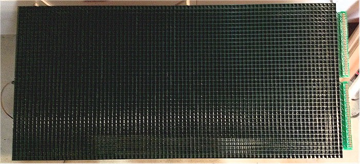

I opted for eleven physical segments (12-welding rods in each segment) driven as six electrical segments (center wire group + 5 L/R wire group pairs).
I used Bolserst's Segmented ESL Calculator to define the resistor network and layout.

I got those lovely resistor boards from Syborg. He designed them and had some extras from the min-buy for his speakers.
I got the mids and treble sounding pretty good now-- I had two 1-ohm resistors in front of the transformers but I took one of those out today, and then did some tuning with the Behringer.
The problem now is that I hear the diaphragm resonance, which is quite bothersome. Tomorrow I will try increasing the crossover filter slope from 24db to 48db/octave and, if need be, raise the x-over frequency from 218 to 250Hz to mitigate exciting the resonance. Also contributing, I suspect, are the higher diaphragm tension (raised the resonance frequency) and the wire stators' greater open area provides less damping as compared to my old 40% open perf panels.
I think these new panels will sound nice when I get the resonance tamped down. I sure hope those Soviet military rotary switches I bought on Ebay show up soon so I can compare the wide/narrow modes.
I confess that I built these panels out of curiosity mostly, having a preconceived belief that segmented panels could not possibly sound as good at the focal point as my old 'head-in-a-vise' perf panels. I still think that will hold true when the tuning' done, but I'm already amazed that these segmented flat panels really do disperse the highs smoothly like my old flat perf panels never could.
