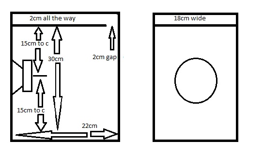

Here you go.
Dimensions of the internal enclosure is 180mm wide x 220mm deep, still the same 300mm height, port is 20mm from internal rear wall and 20mm from top of the enclosure so same distance all the way. It is ruler flat to 80hz, and is good for playing a bit loud together with a sub. Here's also a very basic drawing of how it's supposed to go together. If you want, you can make the port with a 1.5cm aperture instead of 2cm, it will not be ruler flat anymore, but will have a slow roll-off and a lower fb tuning, with the added benefit of further reduced group delay and phase variations.

if i may ask, the wider port will play a bit loud? or handle more spl before cone breakup?
the narrower port height will play as loud, but not be as flat to 80hz but will extend a little lower (give a feeling of more or deeper bass?
K56BR is the ONE i will build, not sure about the decision for port size though. Will one sound better without sub, but the other will integrate better? Is the narrower slot what Dave with P10 was referring to by High-r ? does r stand for resistance? I worry somewhat about excursion limits. But quality is before and above all else.
