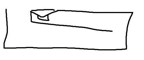

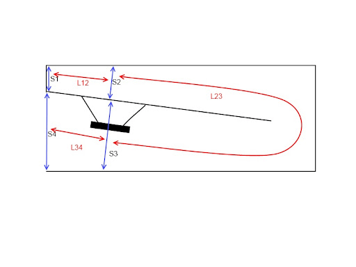

@BP1Fanatic i tapered the line (S1<S2) but SD at the end was as big or bigger as driver

The long boi looked something like this. (Not to scale)
Driver is not 1/3 the way in the line because the goal was as much dB per W and the needed bandpass was 30-80HZ
Also the project is scrapped sooo...
Is S2 <1/3 of the driver's Sd?

S2 was probably around 1/3SD, not 100%sure. Like I’ve said, I’ve scarapped to project. Would have loved to bring it off the ground tho.
Getting 30hz out of a TL is fun, the size not so much 😄
View attachment 1281046 I just see that you posted a Horn diagram. My driver would have been mounted on top of the S2 arrow not inside the speaker
