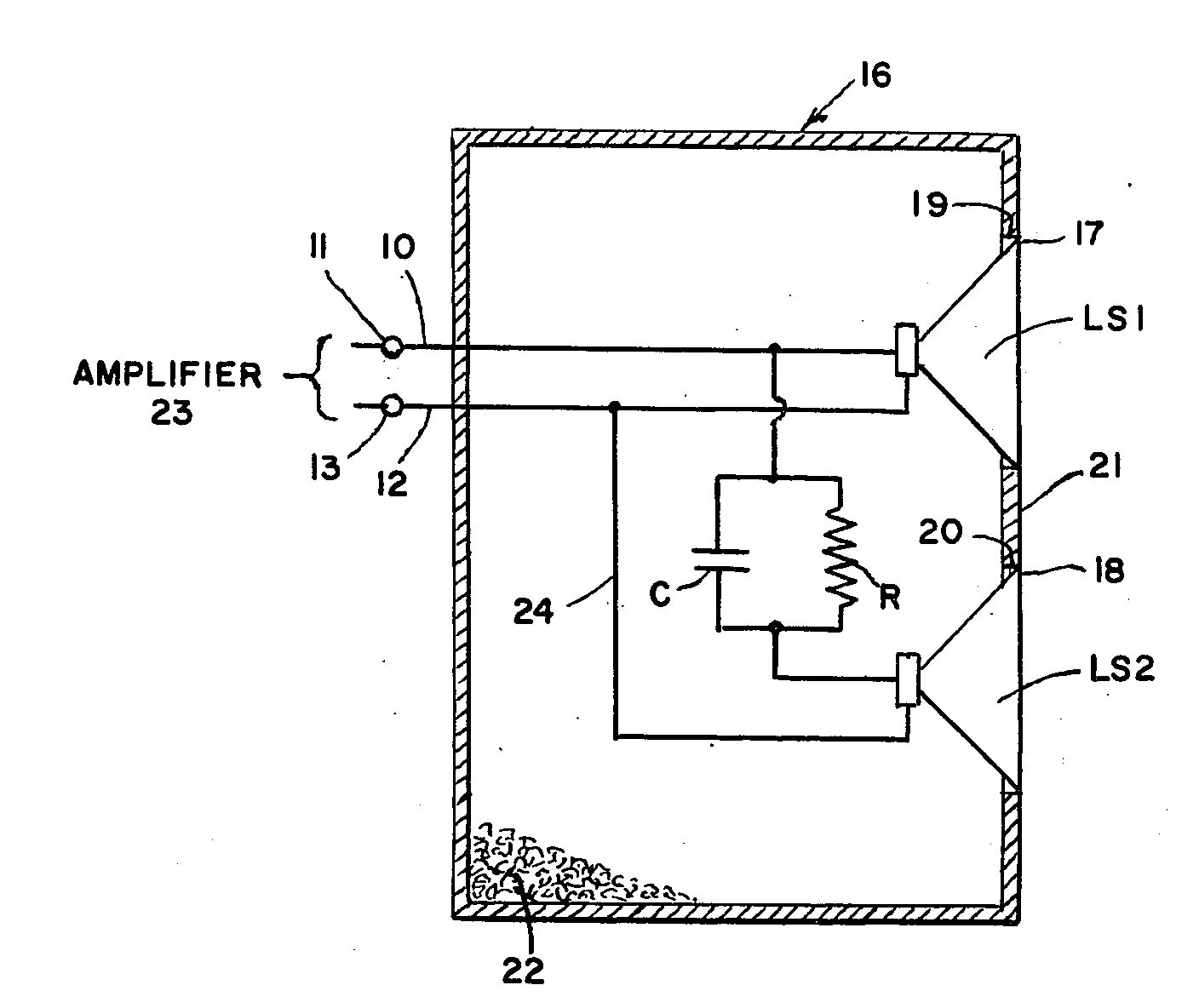

The late Brian Cheney of VMPS mixed speakers of various sizes in one chamber in his designs - lots of fiberglass fill - a downwards into slot firing passive radiator (eventually sags) Nestorovic mixed speaker types in a Speakerlab product where the larger speaker
also acted as a passive radiator.
