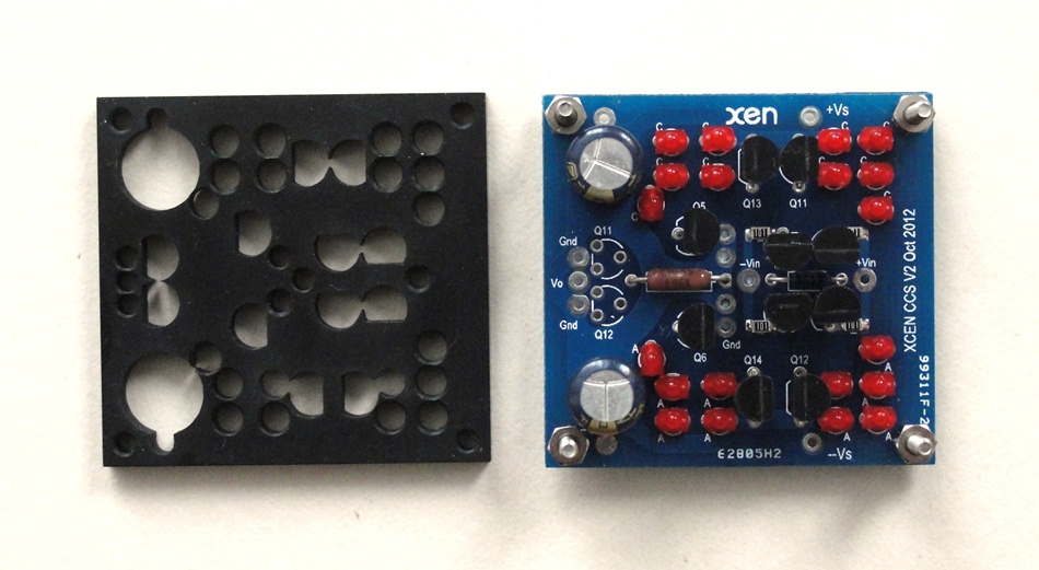

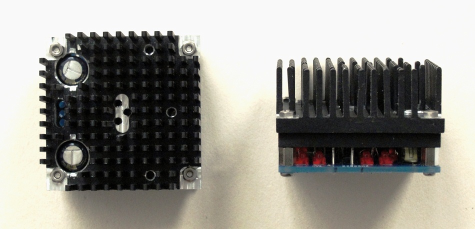

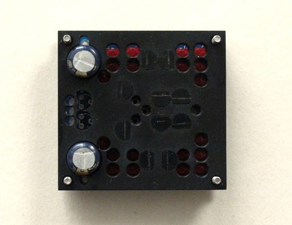

By coincidence, I tested the latest CCS version which was designed to lower thermal drift and reduce noise.
Today's test was only for DC drift.
Apparently, even by using perfectly matched FETs and coupled them together using heat spreaders and heat sinks, it still drifts +/-20mV after 30 minutes.
Just touching the heat sink briefly by finger is sufficient to make a 10mV drift in seconds.
Just to show you how extremely sensitive JFETs are at µA level.
In that sense resistor and TL431 was less sensitive, though noiser.
More testing has to follow, but I think I want to keep the CCS version, at least for myself.
That means a servo has to be added, and we shall not release any project till they are tested to our own satisfaction.
While we appreciate your interest very much, I am afraid you will have a few months more to wait while we try to perfect this.
Patrick
Here a few pictures of the latest CCS version.
Patrick
