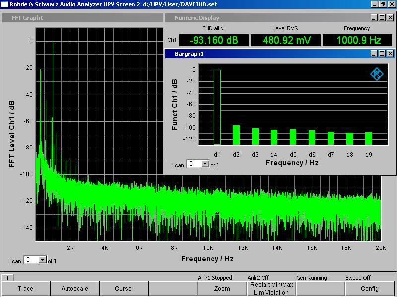

Another update, showing THD measurements.
We are not totally happy with the PSRR and DC drift, even if they are quite OK.
So we are currently working on an improved version to solve both of these problems.
As soon as we have test results, we shall let you know.
The bad news for the new version is, you would need 5 pairs of matched 2SK246/2SJ103 and 1 pair of 2SK170.
Patrick
