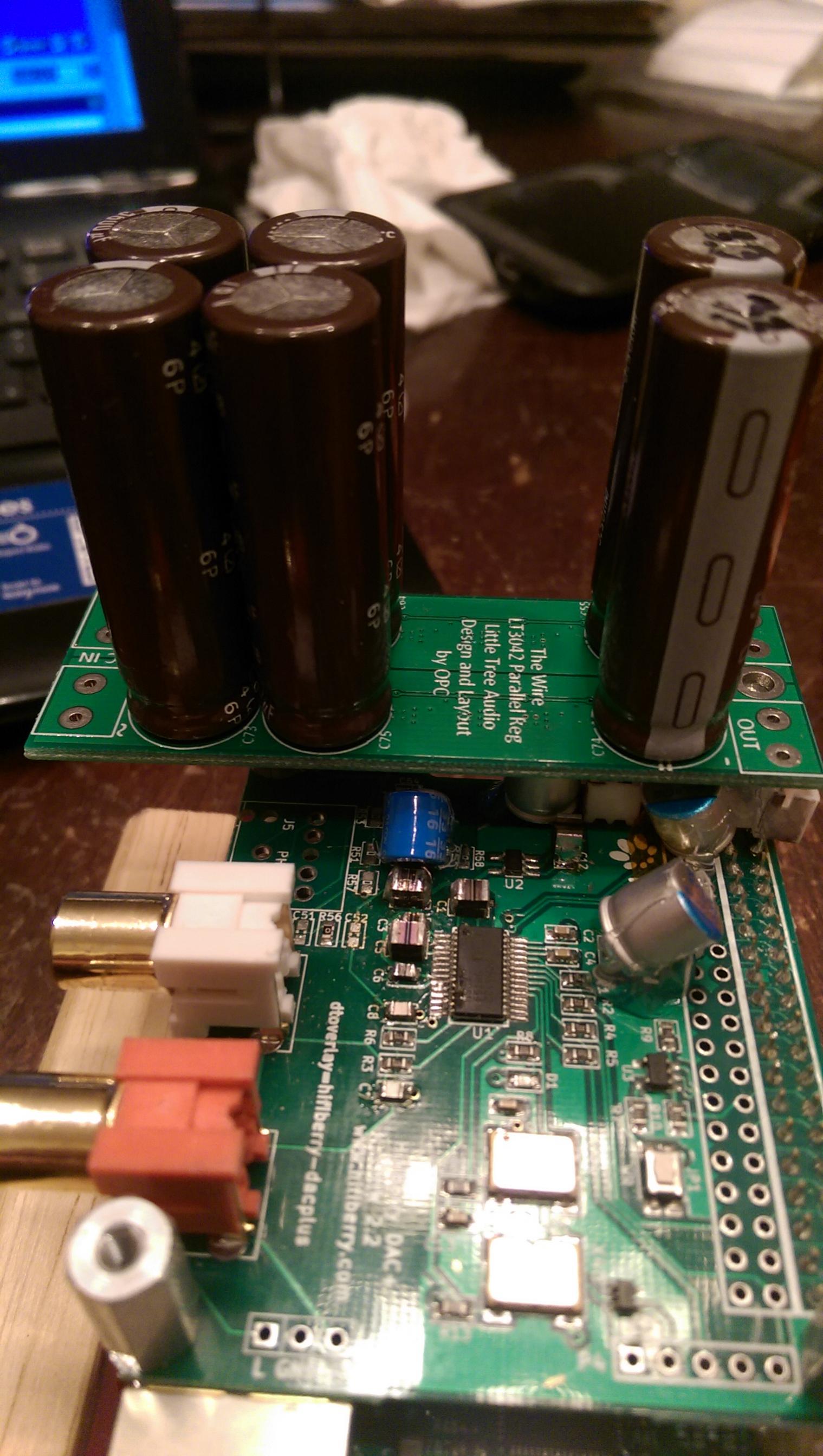

OPC's LT3042 parallel reg in the wild!
Here's a couple of pix of one of Owen's great little reg boards mounted on a HiFiBerry DAC+ Pro I abused mightily over the last couple of weeks. This nice little trick board allowed me to easily split the power feeds so that I could feed 5v to the analog side of the DAC, 3.3v to the digital side of the DAC and the two clocks (separating them from the very dirty R-Pi 3.3v), and use my base 5v to feed the R-Pi. Well worthwhile, stock it was about the same as a stock Squeezebox Touch, with the cap mods on the boards it was a bit better, but separate power feeds really lifted it a good bit.
I have now have three others built up, with one going into the DSP/Processor/Display power feed on a Sony HAP Z1-ES and the other two into modifying a pair of Soekris DAM DACs (FPGA 1.2v & 3.3v feeds).
They will take some care to build (as I outlined above), but appear to be very nice pieces of kit!!!!

Hi Greg,
Awesome work with the regs and the mods!
I had originally designed them to use as bipolar supplies, but at the last minute decided to change the layout at the output to untie the two supplies and let the end user tie together for bipolar, or use separately as you have.
I'm glad I did, because I'm using more of these in applications like yours (1.2V, 3.3V) than I am in any bipolar applications where these are kinda overkill.
Anyhow, great work finding so many applications for these!
