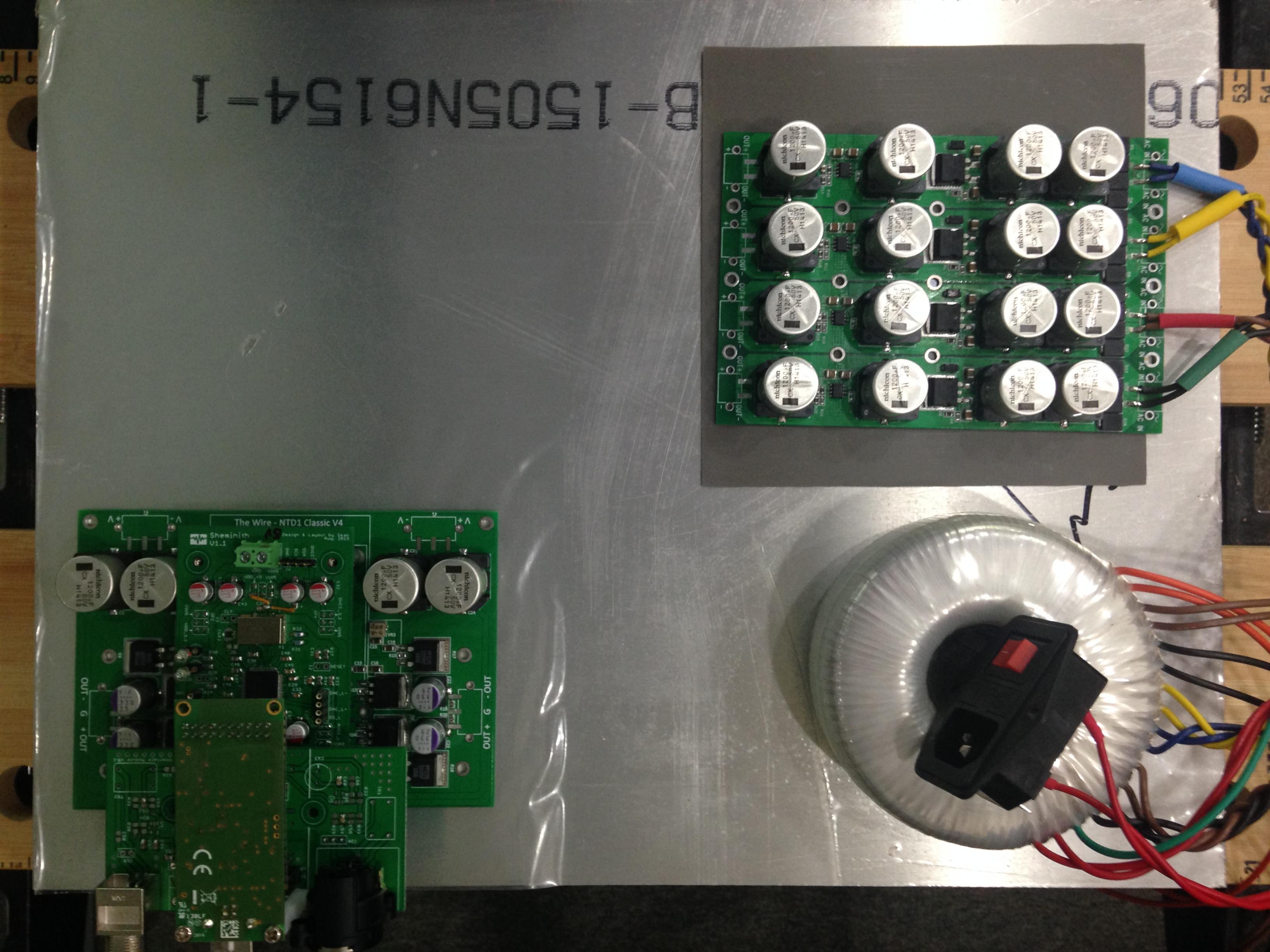

about mounting hole
Hi Owen,
Thank you for the kind answer.
Now, it's time for the drilling
Do you have a document that states what the drill pattern for the heat sink is?
Sean

Hi Sean,
Please see below two PDF documents with the top layers printed to scale.
I've verified these here, but you will need to make sure you print them to scale, so check them against the boards to make sure they match.
All holes are intended to be 4-40 machine screws, but you can use whatever fits.
The NTD1 itself has 8 critical holes (the 8 around the output stage) and 2 optional holes (the holes in the upper left and right corners).
The PSU has 9 critical holes by the regulators and 3 optional holes by the AC inputs.
It's important to snug these screws up, but not to over-tighten them. it's fine to see a slight dimple in the PCB around the screw, but it should barely be visible. If you really crank down on these, you risk deforming the PCB and possibly stressing adjacent components, so proceed lightly.
The heat sinking mostly works through the large surface area, so a lot of pressure is not necessary. A thin gap-pad is ideal here , anywhere from 0.3-0.7mm thickness is ideal.
Best of luck, and let me know how it turns out!

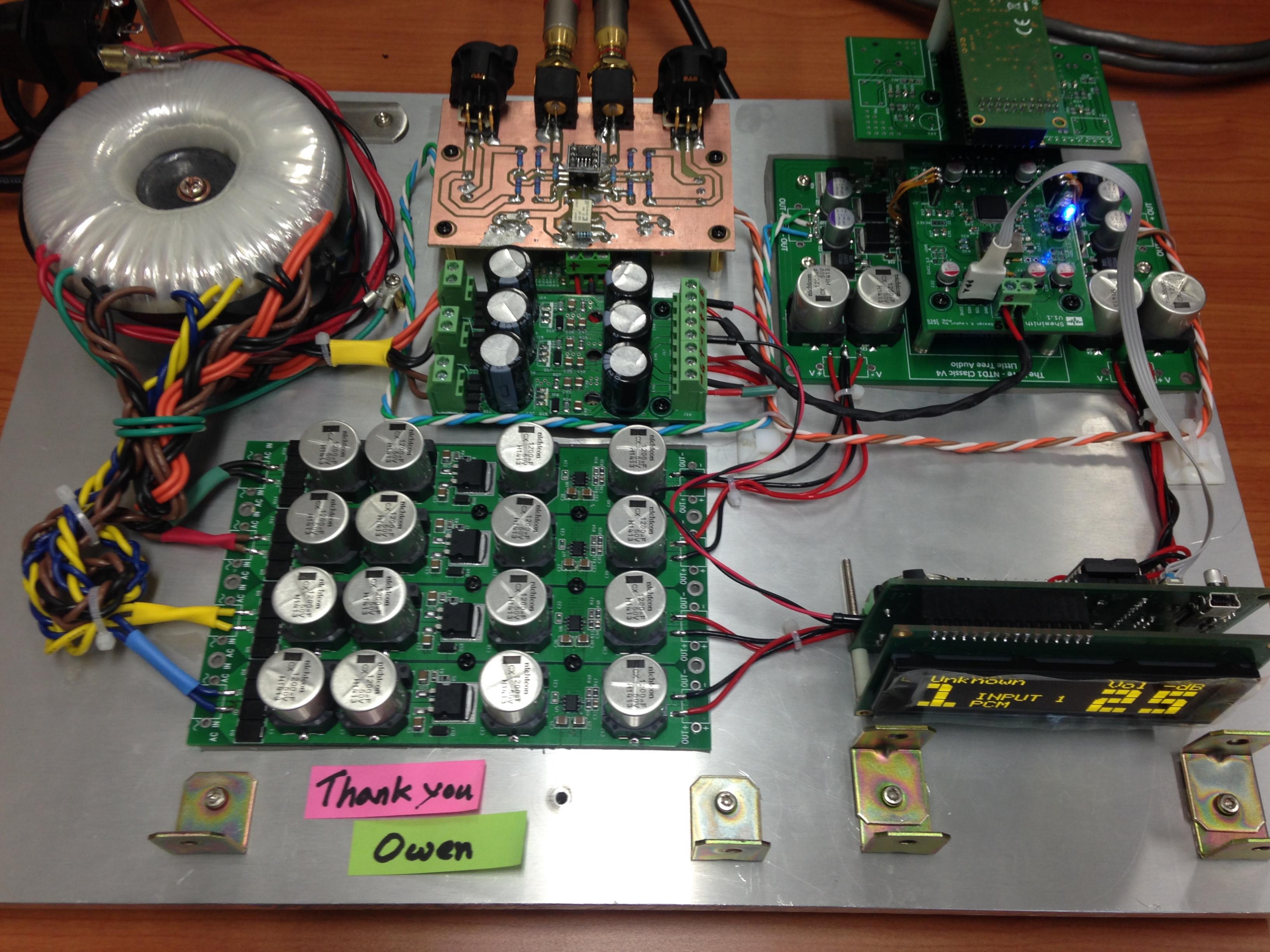

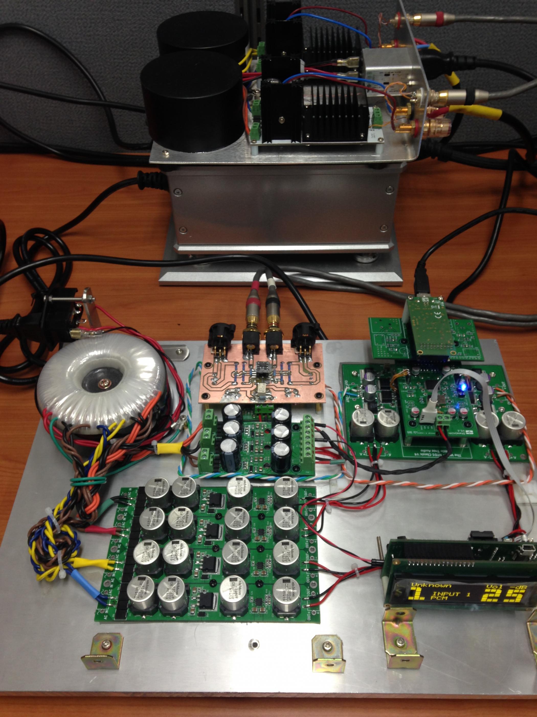

Hi Owen,
Thank you for all of your devotion to DIYer.
I almost finished my prototype of ES9018 with NTD1 V3 IV stage.
The sound is very(x3) nice...
I like this NTD1 rather than my first IV stage.
My former IV stage was single op-amp (AD797) circuit from sabre reference board.
I don't know how can I express it's sound because my poor english.
Sean

Hey Owen,
Does this necessitate a change in the plan of running the low-gain NTD1 and BAL-BAL at +/-18V from two LT3042 boards, or is it still in the realm of possibility with adequate heat-sinking?
Assuming this'll still work, I had a couple other questions come up while planning out the build:
Do you see any issue with stacking two 90k ohm resistors in parallel on the boards to get 45k resistance for 18V output? Looks to be impossible to find 45k 0805 resistors in stock.
- Are two 50VA 18VAC dual secondary transformers sufficient for this set up?
How would you recommend running the wires between the LT3042s, NTD1, and BAL-BAL? Separate wires from the LT3042s to each, or daisy-chained between the NTD1 and BAL-BAL?
Do you have a recommended input impedance for the BAL-BAL, running the 190R output impedance of the NTD1 into it?
The boards are awesome, by the way! I'll add some pictures to the thread soon.
