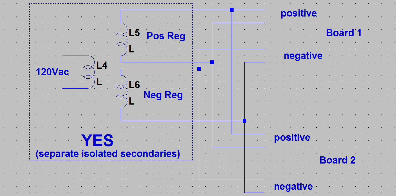

But it should be no barrier to use two amps with one transformer.
True, as long as the two board's outputs don't have anything in common, which they shouldn't (no common output ground). If the two boards do wind up with a common output ground you would need that quad isolated secondary transformer that PandazYa is using. Would be worth going through the wiring one more time and make sure everything goes to the right place.
I was actually thinking about the regulator on opc's new Wire power supply (which is negative). Looks like the LT1185 here can be wired either way, floating postive or grounded negative. I didn't know that! This wiring diagram still should be correct though, along with all the stuff about isolated secondaries.
That's how I connected both boards and heared hum. The regulators became warm immediatelly. I tried to switch the phase and the hum became louder and the regulator not warm but hot in few seconds.
Output GND is not connected between the boards.
Interesting! That sure sounds like it is wired correctly. Maybe I'm not understanding something about how it all wires up. :) About the only other thing I could think of is some sort of common connection between the boards via mounting screws, since the boards work OK when powered individually.

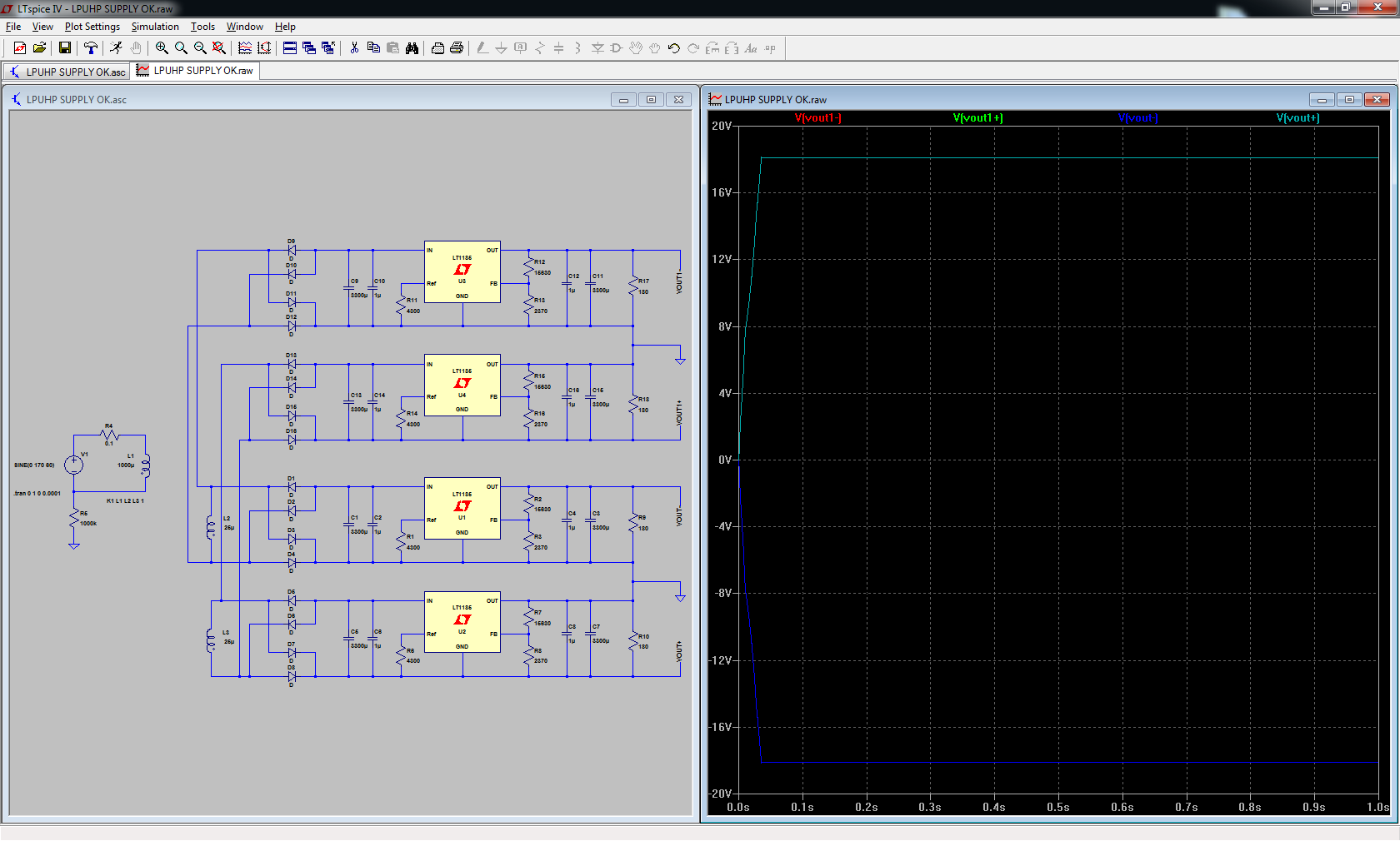

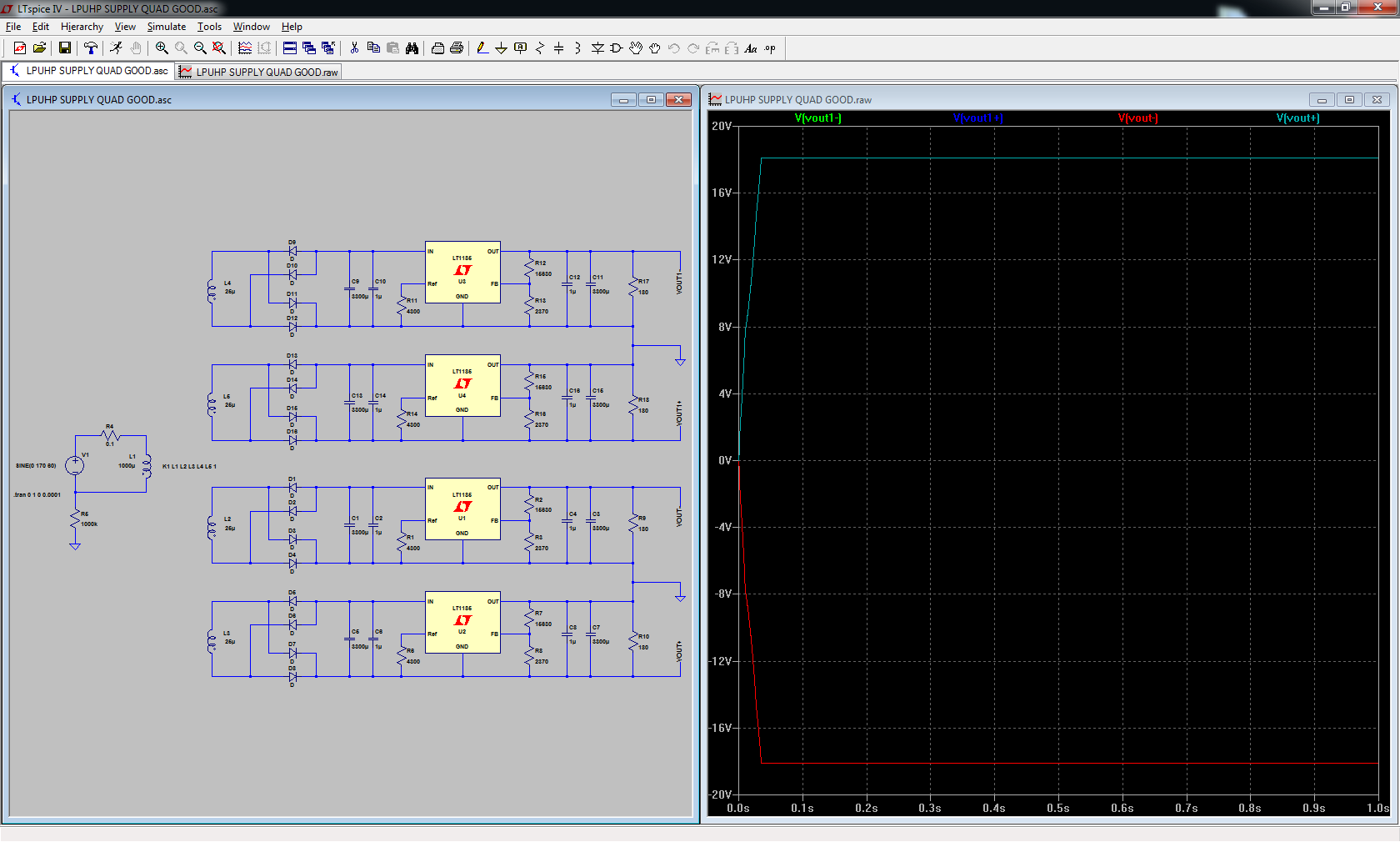

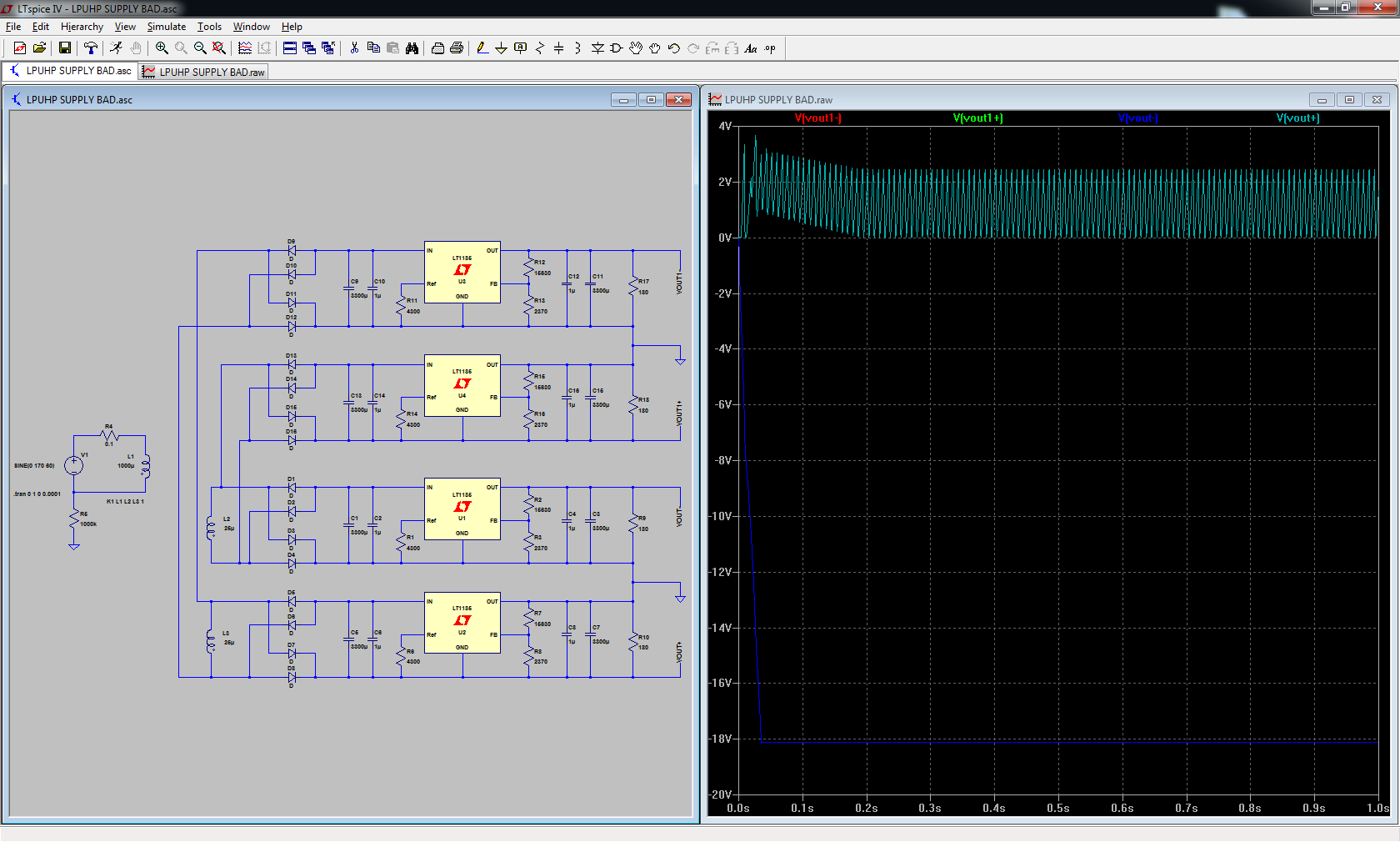

Attached are three simulations showing what should and should not work for the transformer connections.
It looks like using a single transformer might work, but you have to make sure the same winding is feeding the same regulator on each PCB (eg. Winding A feeds both positive regs and winding B feeds both negative regs)
I checked the simulated currents in all the windings, and they appear to be the same as with a fully isolated quad arrangement.
What you cannot do is use the same winding to feed both a positive and a negative reg. In this case, you get no output on the positive rail, just a large AC voltage.
