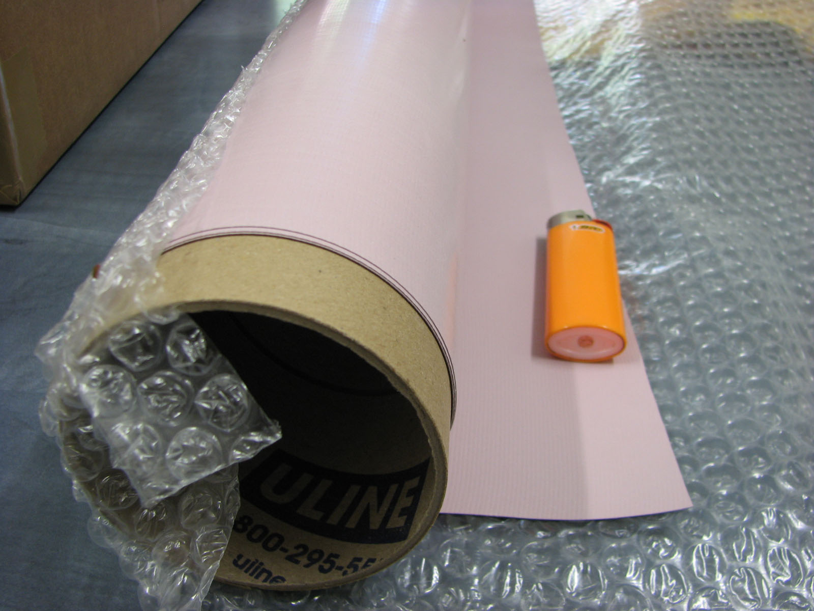

well I dont think either of you have anything to worry about, sure transients can be many times the continuous, but it would be some whacked out music that is 10W continuous but with 350W transients extended enough to take you out of the SOA if youve mounted well.
Keratherm RedAs you mentioned TIM...what are you going to use?
- "The Wire AMP" Class A/AB Power Amplifier based on the LME49830 with Lateral Mosfets
