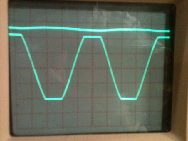

post1316 shows the sticking at 1kHz and all the clipping distortion from 0.1% upwards. Yes, very mild @ 0.1% and 0.5%, but it is there as far as I can see. The sticking does not only occur with 10kHz & 10% clipping distortion.
If I am reading the scope pics correctly, then running the LME at a much higher voltage than the output will help hide this sticking because the output will be clipping and hopefully the LME will not be sticking due to avoiding clipping.
Now to your flawed conclusion.
You are claiming that the sloped flat tops are an inherent behaviour of unregulated linear PSUs and that the same behaviour will not happen with an SMPS. That is the conclusion that is flawed. I have never seen those sloped clipping behaviours in any of my unregulated linear PSU powered amplifiers.
There is something odd going on that should be explained. Then you will find that SMPS is not the only way to avoid that very unusual sloping behaviour.

Early results from the bench--problem resolved.
Whew! This was driving me crazy. Short explanation: my scope probe was causing the sloped clipping waveforms. I'll spare you the details but mention only that I tried and selected this one because it was the best of the bunch--but not excellent.
My apologies to all for the wild goose chase. Thanks for sticking with me.

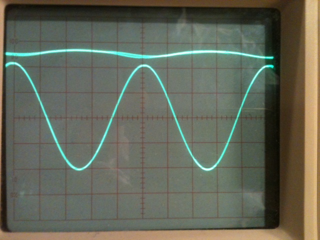

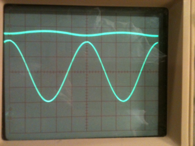

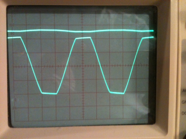

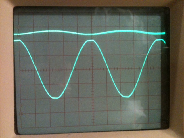

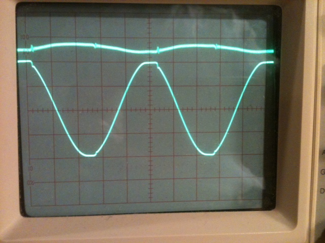

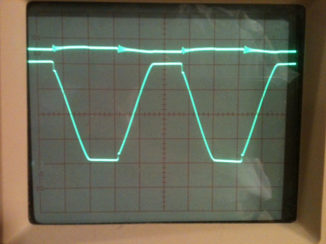

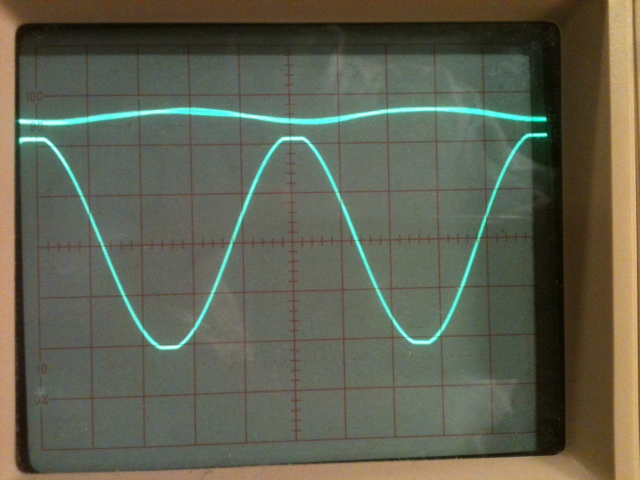

Following Owen's recommendations here are the revised results at clipping. Top trace is the positive rail at 50VDC and 2V per division. Bottom trace is the output into 8 ohms, (non inductive) at 20V per division. The PS has a 1kVA transformer (not toroidal) and 72kuF capacitance per rail.
1. 10kHz, 10% THD&N
2. 1kHz, 10% THD&N
3. 100Hz, 10% THD&N
4. 10kHz, 1% THD&N
5. 1kHz, 1% THD&N
6. 100Hz, 1% THD&N
7. 10kHz, 0.1% THD&N
8. 1kHz, 0.1% THD&N
9. 100Hz, 0.1% THD&N
Although not as stiff as the DSP-600, I am satisfied with this PSU.

thanks for that npdot! well done. I think this also perhaps explains both positions. your scope shots dont show the slight slanting of Owens as clearly, probably due to the measuring gear not being detailed/fast enough compared to the agilent. Possibly Andrew doesnt have access to an agilent of this quality, so may explain why he hasnt seen the behavior before. besides I dont think either is a big deal, as has been mentioned, nobody should be riding the clipping at full power.
but it does show that the dps600 more than holds its own against 1kV and 75kuF, which is a bit David and Goliath dont you think!?

I spot a slight rail oscillation in our 10kHz graph. It seems like a very high frequency due to the thick oscilloscope trace. Maybe some low esr capacitance in series with a L form a resonance circuit somewhere in your setup.
I good old analog scope is very useful spotting this kind of oscillations.

so it does, pic 1, 4 and 7 all show some sort of instability/resonance in the power supply rail, though the amp trace does not seem effected
yeah thats a good point, I guess a good fast analogue scope may be good, or perhaps better for spotting things that are not part of the intended measurement by being able to show very high frequency above the measurement bandwidth as a blurry trace. it does this because of its analogue nature I guess, however I would assume the agilent would pick it up also, you may need to focus in more on that higher bandwidth

This is not an anomaly associated with the psu. it is obvious that the DPS-600 provides a different behavior, due to the high speed of the regulator.
This ringing (also present on the measures of Owen) must be sought in the (current-limiter/ Offset sensing) of lme. ringing is a fast shutdown of the circuits of the driver, this may be due to:
a bad capacitors in the bias circuit, incorrect or need a sensing threshold for RC delay.
ringing is seen in these measures (has polarity Both neg-pos) is a "cut-off" of the stage drivers.
just to try it, you might put to gnd pin 8. This disables the output sensing sull'offest. perhaps requires a constant r-c. it's just an idea, I do not know lme.

Looks like my theory is debunked, although I will still run one last set of measurements with a linear PSU in my setup to confirm.
Thanks for re-measuring npdot! Much appreciated.
As for that resonance in the PSU, I would agree that it could simply be test leads that are too long between the PSU and amp board. That might cause the resonance seen in some of your scope captures. I also agree with Andrew though that this is definitely not desirable behaviour, so you might want to check your finished amp for it and make sure the problem doesn't persist.
AP2: In this case the ringing is definitely a symptom of the PSU, but the abrupt change in current demand is being caused by the amplifier's tendency to stick to the rails during clipping at high frequencies.
To this end, I have tried 4 different output stages and well over a dozen compensation schemes, and the rail sticking is always there. I'm not sure if tying osense to GND will solve the issue, but I don't see this as a viable long-term solution even if it does.
