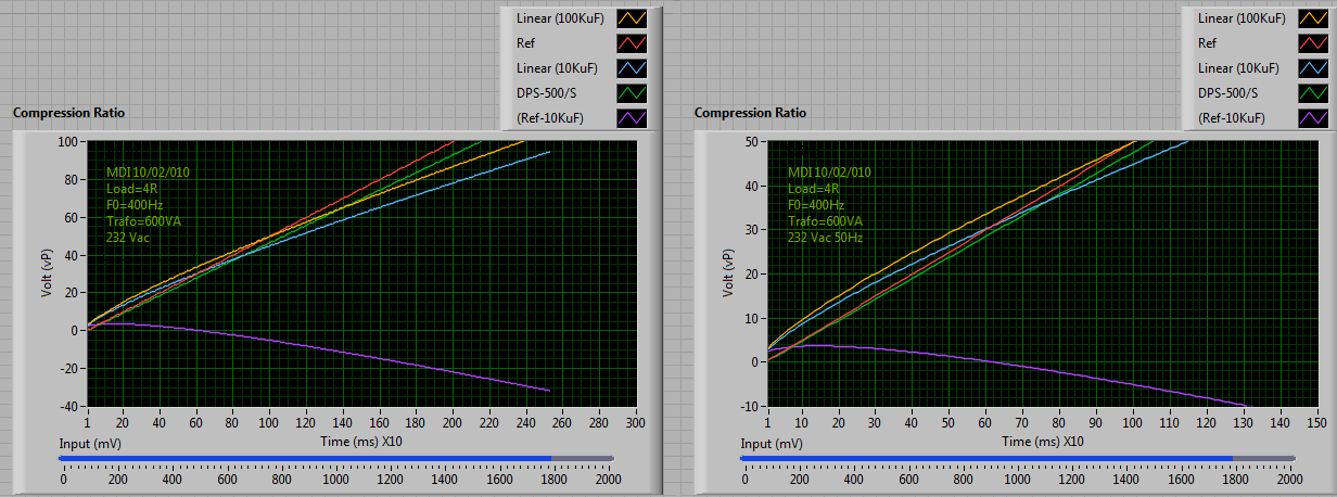

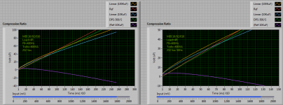

On resistive load, a generator at 400Hz, start, the driver amplifier to 1.76 V using time as the x axis.
Graph show input signal level Vs. output (Vp) of amplifier (mospower AB Class)
the other graph is zooming.
signals with variable frequency (music), the ratio varies continuously significantly (also in the segment low power)
Maybe a diy, do not think that behind an SMPS, we wanted to find a real remedy to the problem of Unregulated psu.
The green trace, although aumentere power decreases as the (little), has maintained a good ratio close to linear REF

Roberto, thanks for the graph, I am slowing getting there. In a word, the SMPS has better transients than 600VA+100KuF. If we take a capacitor bank made of fairly good 10x10k Vishay BC 63v caps + the trafo, even the cost of only these two parts will be more than the SMPS. It's a no brainer, really... at least for me! I can see guys arguing and being defiant of light devices vs heavy jewelry that looks "oh so macho" but I am sold on your concept, great stuff!

By the way, when I look at the graphs above I see that the unregulated 100kuF supply is equally fast as the SMPS up to 100 mS (x10?), but I don't know how to interprete this correctly, and how fast "things go wrong" up to 280 or so mS. Could you explain?
