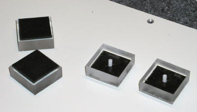

I start a chassiss from choosing feet, since this is the most important thing here. After seeing Boulder equipment, I'm not using round feet anymore, and acrylic makes a nice material choice not only from a soundwise POV, but it's also easy to cut, looks nice when sanded and is cheap. I add damping sheets at the bottom and place the feet at the very corners.

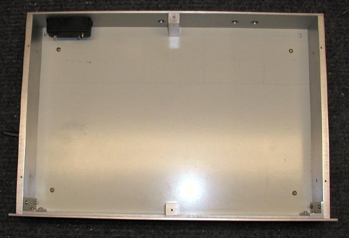

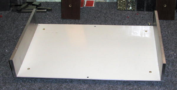

We got the 3/16" bottom panel cut to the size, so the next step is adding the sides. I like to use flatbars 3/8 or 1/2" thick and usually 2.5 or 3" wide. One reason for that is that I don'thave to use any additional rods or angles to attach all the other panels; I simply drill and tap the holes in the side panels. Since the bottom is pretty thick, I use Allen type screws and bore the holes so the heads are recessed and don't stick out so much. Size #6 or #8 is a good choice here.

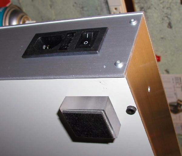

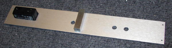

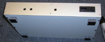

Here's the look of a rear panel. It is attached to the back edge of side panels. Additionaly, the 5/8" bar is added in a center to make connection to the top and bottom covers. Six screws, size 4, are used altogether. Both rear and front panels are anodized and I'm using here some surplus, in good shape, material.

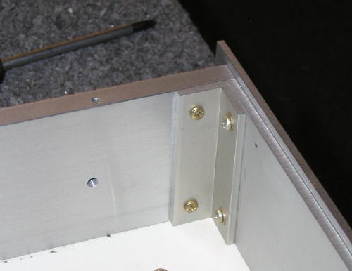

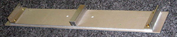

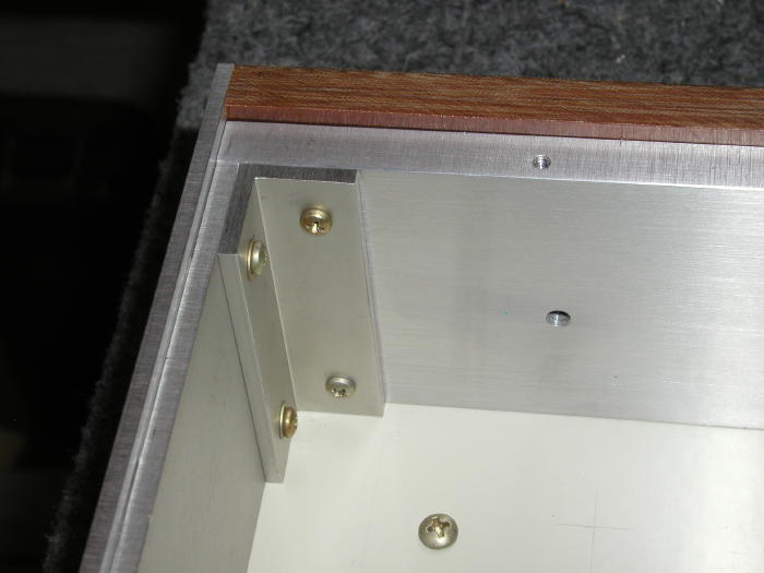

The front panel is pretty tricky to make, especially when no pots and swithes are used. I build it from two pieces. One is the outside, visible panel, the other is a subplate which is used to mount it to the rest of a chassiss as well as support top from bending. You probably noticed that top panel will go really on top and it rests on side panels, rear panel and front subplate. I think it is a better way to do it and it provides support in case you want to place something on top of your unit (Shakti stones maybe or some weights?;)).
I'm using angles to attach the front assembly to the sides, with a screws which mount from the inside. I glue both panels with 5min epoxy and this gives me the final one piece panel. This particular one has two LEDs in front and I used those holes for easy aignment. In case you are using pots and swithches no glue is required and you can use the hardware to keep both parts together.

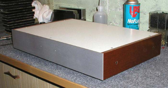

This could actually make the chassiss complete, yet for me it seems a bit unfinished like that, too much cold looking without definition. What I'm doing to improve on that is adding additional side panels. I have found this really nice surplus place and for last 10 years they had those cut off pieces of some fiber materal. It looks better than wood and is much stronger and doesn't require finishing after cutting. This is what I'm using here. I think it looks better that way;)
