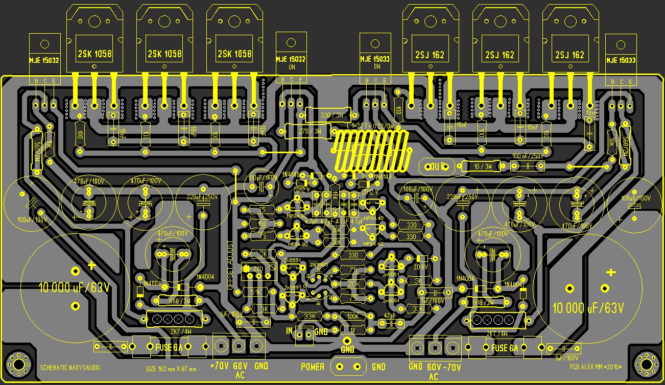

The Gate resistors (100R) should be positioned as closely to the output mosfet gate connection as possible.
I am interested in why you have added the current sharing resistors to the mosfet source output connection? These resistors are used on vertical mosfets, but are not necessary for lateral mosfets due to the negative temperature coefficient. The resistors are not on the original schematic. There are none of these resistors on any of the 9 lateral mosfet power amplifiers I own!

Alex,
A beautiful board, very elegantly laid out. Not easy, takes a lot of time and effort.
I'm not sure how you'd get around this, but yes, I agree with Xoc1 who suggested putting the gate stoppers near the device gate. It would require a lot of difficult rearrangement, but I do feel it's necessary. This is my only issue with your otherwise magnificent board design.

I love that in this new board the MOSFETS are all on one side. Makes it easier to construct heatsinks. I also like that they are mounted closer to the edge.
The 100R resistors and 10nF capacitors should be as close to the MOSFETS as possible.
The BSS71/BSS74 transistors do not need a heatsink.
The BD249C and BD250C should really be mounted on the main heatsink with the MOSFETS.
Can you please add the 100uF/100V capacitors from the main power supply back on the board? It's the ones that would come right after and in parallel to the 10,000uF/100V capacitors.
I can live with the 10,000uF capacitors being off the board. Although it would be nice if they were on it.
The 0.22R/4W resistors are not needed.
The 0.1uF/160V and 100nF/250V capacitors are not needed.
The rest of the schematic and layout looks terrific. With these few changes, the amp should work great.

PCB rev 2.2 ......final one
Thanks guys , this time after many hours playng with my mouse , the job have done .I thing now it's quite good , if not I'm open to take critics from you .
Regards Alex .L.E. Error caps are 10.000 uF /100 vV not 63V like in the picture !

Alex,
you are quite gifted in this pcb thing. What are the finished dimensions of this final all on one side layout?
I think this will make a very nice amplifier. I like the two big onboard caps.

A few transistors have been mislabled: BC546B and BC182B.
I would also recommend sticking with MPSA93/MPSA43 pair instead of MPSA92/MPSA42.
The main power supply voltage should be +/- 80V and not 70V.
And as was already indicated, the main power caps should be 100V and not 63V.
Also, is MJE15032/MJE15033 really equivalent to both BD249c/BD250C and BSS71/BSS74? They might work fine, but the specs are definitely not the same, so the amp might not perform 100% as it should. Is there any way to slightly modify the board (to make more room so that BD249C/BD250C will fit and also that the metal can tripod BSS71/BSS74 will mount right) that for those who want to buy these original schematic NOS parts would be able to do so? That would be great!
QUOTE]
160V total PS while the 2SJ49/2SK133 are rated at 140V max...
Before giving such advices that can turn costly to eventual builders,
i can only advice you to make some more serious research about the
used components...
wahab - I'm not sure I understand what you're talking about. The MOSFETS are rated for 140V, they are being fed 80V. What exactly is the problem? The voltage should be +/- 80V. You can certainly use 70V, but then you're deviating from the schematic and I cannot guarantee that the amp will function 100% like it's suppose to.
It will work in a wide supply range...
At full power, the devices will withstand the full rails
voltage, that is 160V...
2SJ49/2SK134 are rated 140V
2SJ50/2SK135 are 160V...
You should use these latters if you want to squeeze out
the last drop from this design, but for safety reasons, even
using the higher voltage grade , it s better to have about +-70V
at most..
These Hitachi devices are rugged and can easily take a little more
voltage than their rating, but it s better not to dare the devil...
