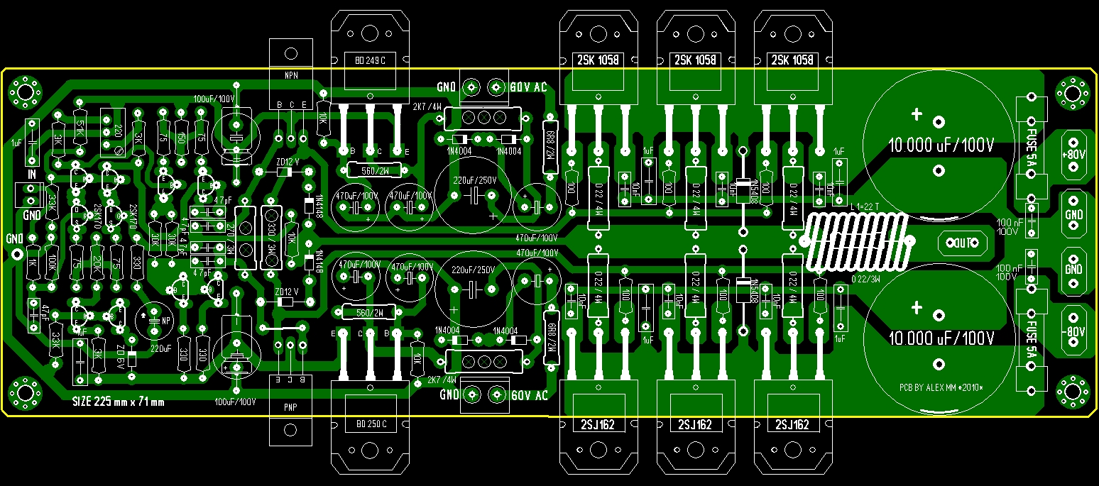

Count me in as a customer for the PCB board if Alex can do the following:
1.) Add rail fuses.
2.) Remove the small heatsink from BSS71/BSS74 and place the BD249C/BD250C near the output MOSFETS, so they can be mounted on that same main heatsink.
3.) Go back to a three pair MOSFET design.
4.) Leave the MOSFET 10nF decoupling capacitors.

This is a very nice PCB board, it's tempting, so I would also be interested in purchasing one, if you guys do a group buy. But I would only want one if the PCB board is upgraded back to include the original 2N5565's and either 3 pairs of mosfets, or two pairs.
Is it possible to use Vishay/Siliconix U430 instead of? I have some of these.

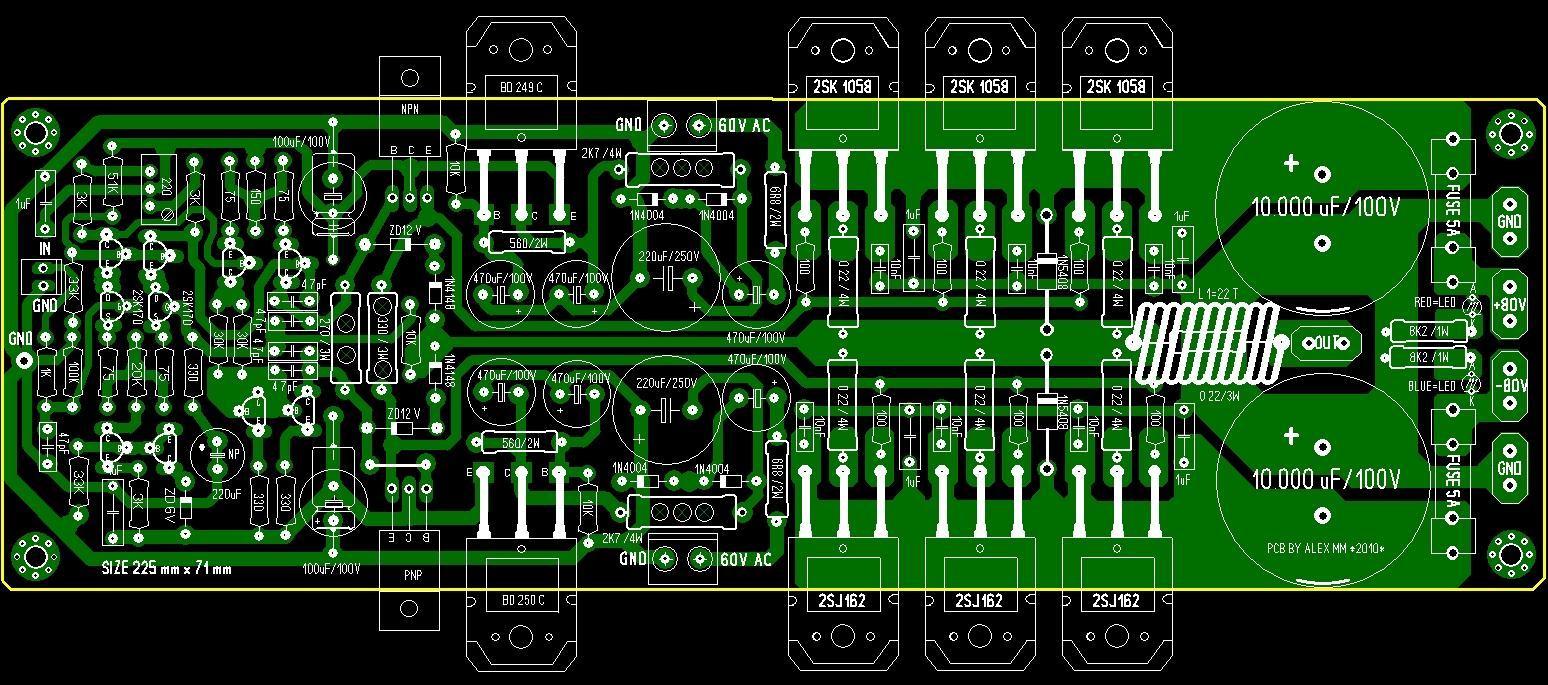

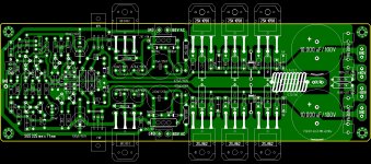

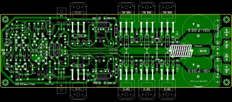

PCB updated .....
......I am afraid, better then this ,I cannot layout so wich PCB " A" or "B "will bee
the right one ? I will post all files when final PCB it's OK .I'am going to sleep now
Regards Alex .

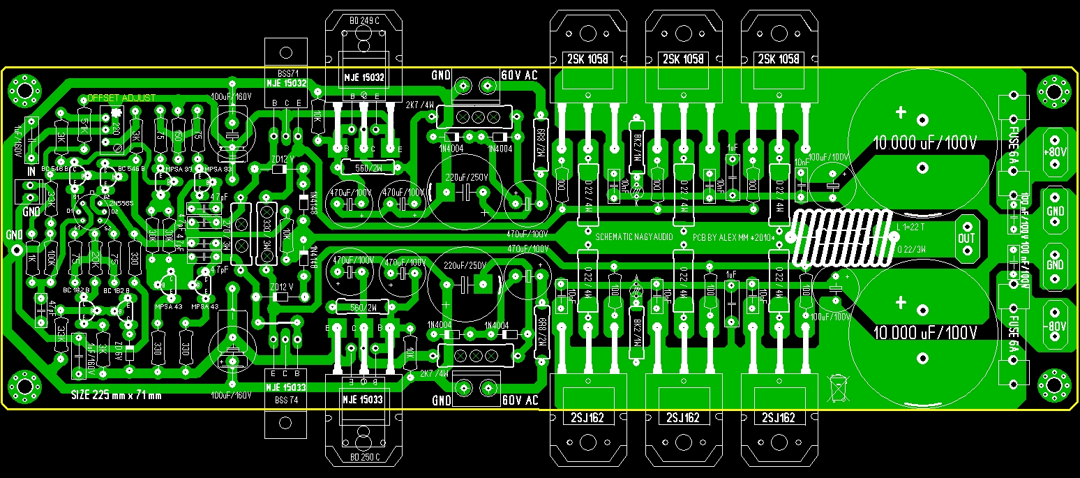

Hi Alex,
PCB B is better and is the one I'd be interested in. This is nearly a perfect board. Few nitpicks if you could change would make it perfect IMO.
1.) This one is important. Can you please change the 2SK170's to 2N5565's. At least as an option. Instead of PCB A, maybe you can use PCB B with the 2N5565's. This way some people can order one board and others can order the other.
2.) The 100nF capacitors are not needed IMO.
3.) Can you label the following: BSS71, BSS74, BC546B, BC182B, MPSA93, MPSA43.
4.) I see you've omitted the 47uF capacitors in the power supply. If you're using 10,000uF, can you add in addition 100uF capacitors? The main power supply should be 10,000uF - 100uF - 1uF - 10nF. It does make a difference sonically.
5.) The 220uF capacitor from 330ohm resistor going to ground is not necessary IMO. Also, you've included 2 1uF capacitors in the main power supply, only one is really needed. And the 1N5408 diodes are also not necessary IMO.
This again looks like an excellent board. What determines my purchase is if the 2N5565's are put in.
